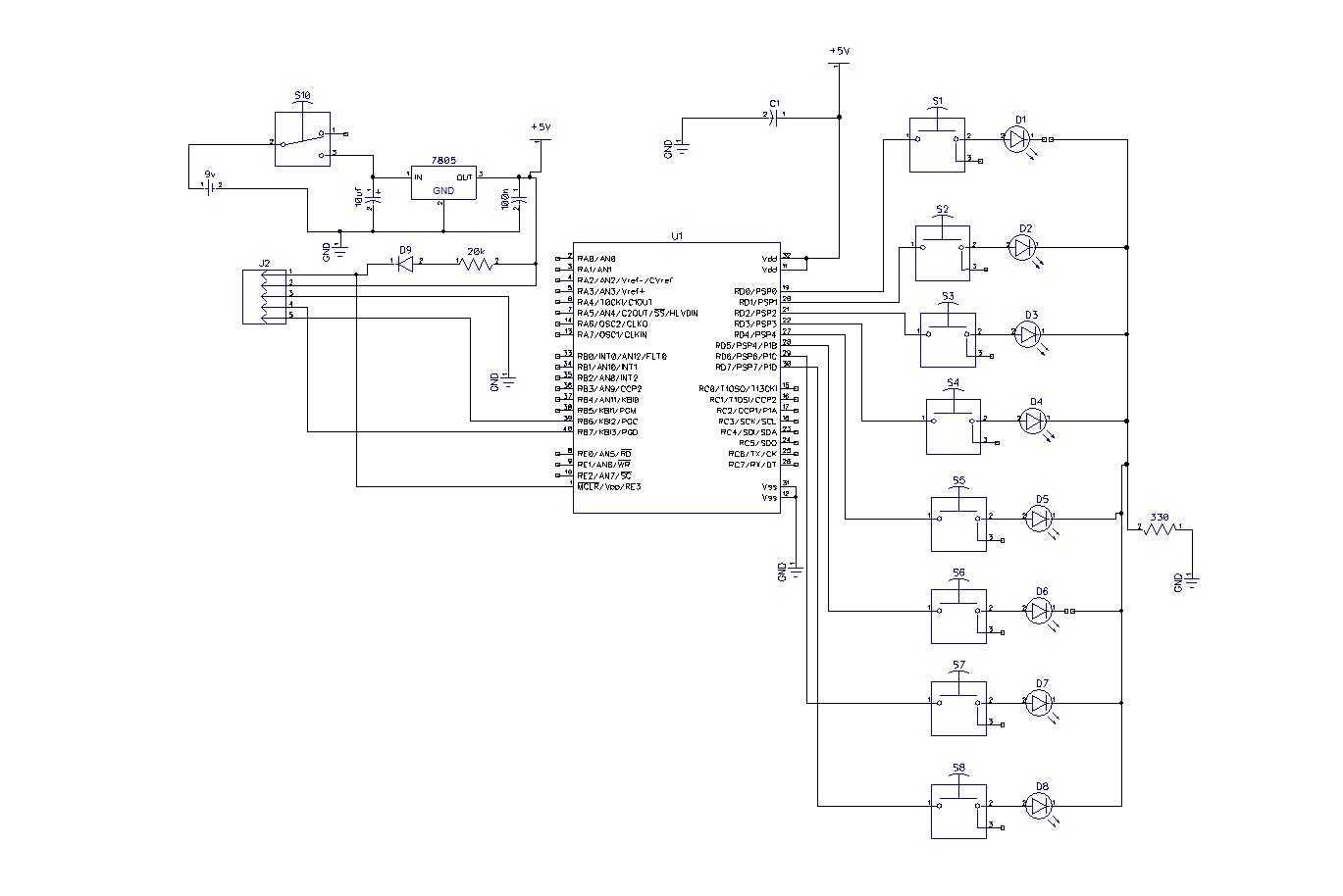

Why two 74HC4017 ICs? For 20 LEDs?
Why worry about power consumption when a 4017 or the HC kind lights only one LED at a time? Then at 2mA of LED current a 750mAh battery will last for 750/2= 375 hours which is more than 15 days and nights non-stop.
Very true about the 74hc4017 but I only am using ten LEDs and each 74hc4017 has only 8 outputs.
I purchased two 74HC4017's and two 7555 chips off ebay to use but ran across a lone orphan 18F1320 in my junk box and it needed a home. LOL
A pic is way more fun to use and efficient with board real estate. one board, one 18 pin chip plus I can alter my multiplexing to change the current draw slightly.

Looking at your schematic and trying to understand your code, is the end result:
If switch n is closed, LED n is illuminated? No other function besides that?

I am confused. The first two pages of this thread used one 74HC4017 driving only 8 LEDs so two of the outputs were not used. A comment was made that all 8 LEDs will draw a high current so low current LEDs should be used but a 4017 has only one output turned on at a time and NEVER has all outputs turned on so the current is not much. Then the number of LEDs was increased to 10. Then a PIC will replace the electronics?
These types of "circular " discussions always stem from newbies who don't know how to define all requirements up front and then change implementation which was specific to the question, wasting a lot of "good bandwidth " in the discussion.
....going to build a very simple 8 led circuit that requires very little current draw....going to multiplex the leds to save on current draw.....Each led will have its own switch. when a switch is ON the corresponding led will appear to be on steadily or maybe flash??.....
Going back to MrDEB's original post, he wants 1 - 8 LEDs on, the state of each controlled by a switch.
Multiplexing is part of the circuit "to save on current draw".
I think you've been led down a MrDEB rabbit hole.

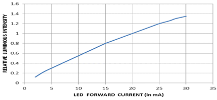

Multiplexing is done to save connections on things like 7-segment or dot matrix displays, not to reduce power consumption.
Say an LED has satisfactory brightness when operated at 10mA. If you mux that LED with 7 others, it will have to be driven much harder(~8x?) to appear the same brightness because it's only illuminated 1/8 of the time.
To clear things up. I originally was going to use the 4017 idea which would have achieved the same end result as using the pic but using more components with the 4017 circuit.Just the 7555 would add two capacitors and two resistors. Using the pic I should use a cap on the power rails.
The pic has more outputs but only need 10. This is a KISS circuit.
