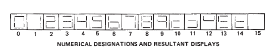

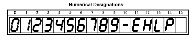

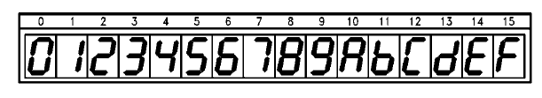

...and connect it to a 'BCD 7-segment driver', any number above 9 will then display the letters A,B,C,D,E,F on the 7-segment display
Careful there! :)
I know the DM9368 does what you say (first image).
The DM9374, CA3161, and NE587 decode counts 10-15 with '-EHLP ' (second image).
But not the traditional ones: the CD4511 blanks the display on any count above 9, and the 7446, '47, '48, '49, '246, '247, and '249 all show the same symbols for counts between 10-15 as indicated below (third image).
