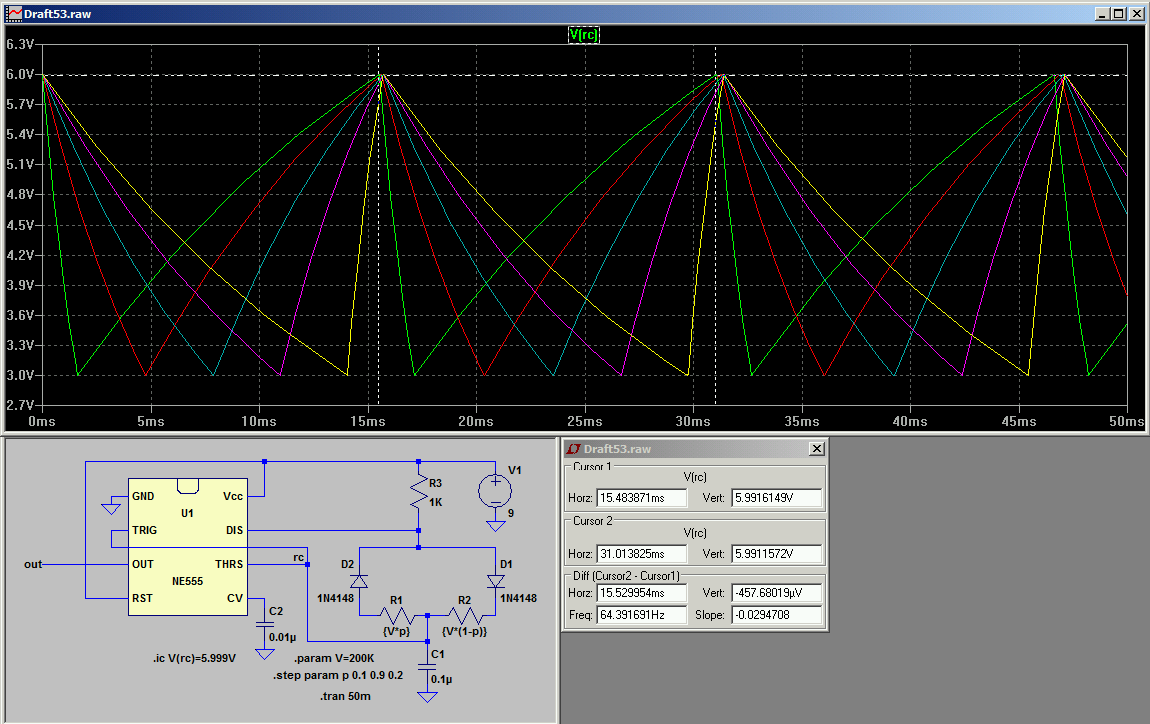

I'm currently using a PWM circuit built from the schematic shown above. It works very well and does what exactly I wanted to do except for one thing, it does BUZZ since the circuit design is around 1.5KHz (very much audible range) with an adjustable duty cycle.
Can someone help me modify this circuit so that I could have around 62Hz, with still the same adjustable duty cycle (5%-96% minimum).
Thank you so much!

What is the end-to-end resistance of the pot?
For starters: new timing capacitor = old timing capacitor * 1500/67

Resistance at 0% on the Pot dial is around 3ohms, and at 100% dial is around 9.8K Ohms. At the current circuit gives me around 0.98V at 0% dial and 12.1V at 100% dial. Which is fine, I just wanted to lower the frequency to non audible range and 62Hz is good and makes the mosfet cooler.

Ok, so how is the switch wired? The switch somehow has to get back to the wiper of the pot?
It isn't actually wired to the switch and is only directly tied to the N-channel mosfet's gate. The 2 diodes on PIN 7 is actually for the outer pins of the POT, while PIN6 is wired to the wiper of the POT.
So you either have to change the timing cap value from 0.1uF to 2.2uf, or you have to change the pot resistance from 10K to ~200KΩ.
Or find a Rpot*C(Farads) = 0.2
Thanks so much MikeMl, the problem was solved using 200K Ohm pot. But I'll try changing the cap from 0.1uF to 2.2uF because a 200K trimpot is not really common here (I tested using a 200K ohm large pot).
