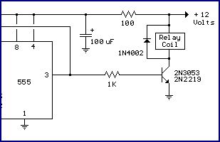

GOT THE LED TO FLASH! haha finally, so how do i make the output signal actiuvate the relay? somebody please make a schematic for this lol i need a seperate ojne cause the diagram i used is not the one boncuk posted haha and what transistor can i use? radioshack only please
The standard 555 (not the CMOS version!) may drive a 200mA relay so you may drive a relay directly without transistor. If the relay is bigger, try the circuit with transistor.
Below you find an example of direct drive and of transistor drive (just look at pin 3). In both cases, the diode in parallel to the relay coil is mandatory.

why is the diode necessary? im just curious. i got it to work before your post lol but thank you.
when the relay is switched off, the relay coil produces back emf of high voltage and in reverse direction to normal potentials. this would damage the transistor driving the rely.
the diode provides a current path for this back emf so that the drive Transistor is safe. Hope you get it. this would be taught in fundamentals of inductance and Dc and ac circuits involving inductors.
