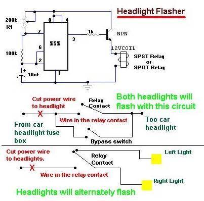

Ok so i want to wire something that will activate a relay on and off repeatedly [on .5 sec, off .5 sec] repeat. i got this circuit and tried wiring it and it did not work, can somebody check this for me? and if its not right can somebody redraw it for me correctly, and i am not sure where power is applied but i believe it goes to the link between the 200k resistor, and pin 8, etc. One other question, how do u identify the orientation of the chip? and if anyone has a better or different circuit using only parts available at radioshack then please post asap. this is for a headlight wig-wag system, so i plan on using a spdt relay and a switch. thanks!
there is no circuit posted.

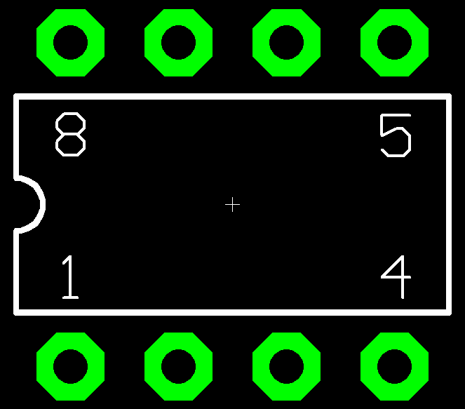

You can identify an IC orientation from top. There should be a notch at the left hand side.
For the pin count refer to the attachment.
Boncuk

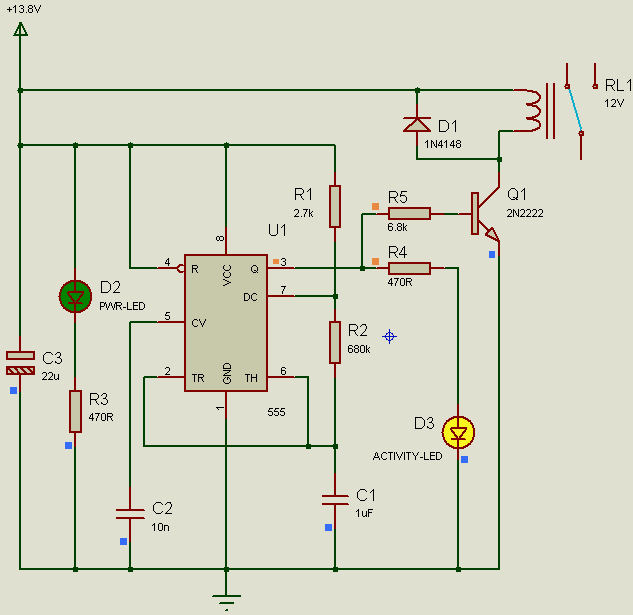

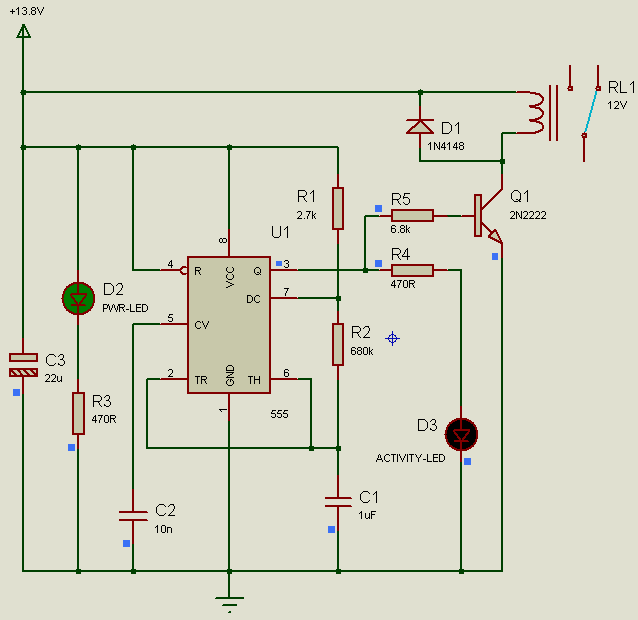

Just in case you've made a mistake:
This circuit switches every 1.066secs.

The 10n cap might be anyone you find in your junkbox. If you don't have one just leave pin5 unconnected.
As you can see from my post the relay (animated) really works (open and closed) - without clicking.
Recheck your wiring. The 1µ electrolytic cap should be connected to ground with the negative terminal.
If your chip hasn't gone across the river Jordan already it should work like a charm.
Boncuk
P.S. Next time you post here I want to read "Hurray!" If you used the pot take the wiper to the center position first. The circuit does nothing if the wiper is brought into a position to have pin7 connected to +UB (thus omitting the resistor).

I don't see a freewheel diode in your drawing. I would add one to keep the relay from damaging the transistor.
Also, powering the 555 backwards kills them from my experiance.

Of course a simulated relay doesn't click since it has no audio output. :D
The switch position can clearly be seen looking at the two screenshots.
