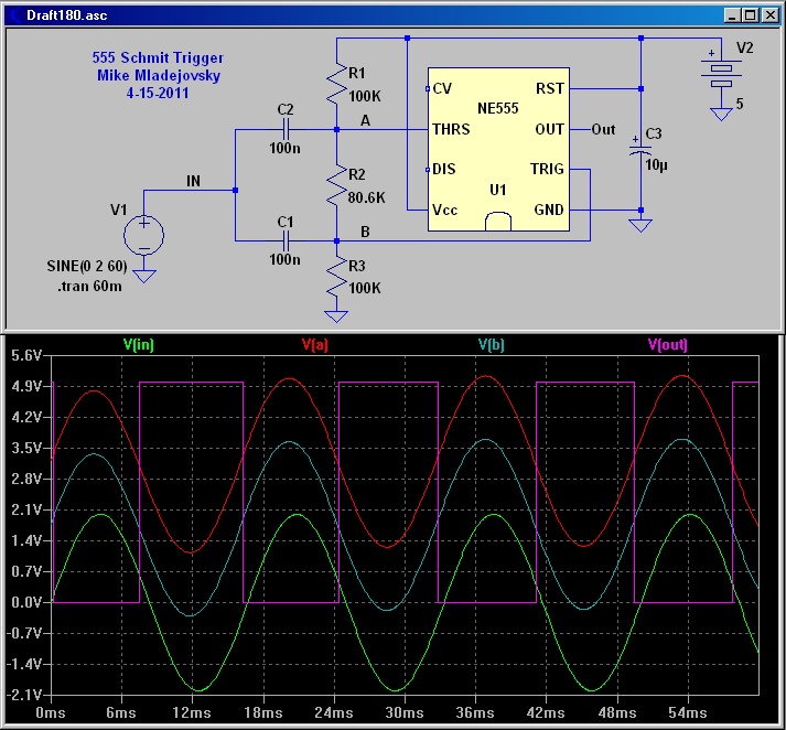

555 Timer Chip
R1 = 10k R2 = 68k C = 10µ = 1Hz

Thanks for the schematic. That was exactly what I needed. It didn't have to be seconds exactly but within that time frame. One thing that still puzzles me is how those resistor and capacitor values match up with 1Hz according to f = 1/(.693 * C * (R1 + 2R2)). Also I noticed that your 5 pin is not connected to anything. According to wiki diagram it should be connected to 10uF capacitor. Is that wrong or what?

f = 1/(.693 * 10E-9 * (10000 + 68000 * 2)) = 988 Hz...not 1Hz
How do you get 1Hz?
