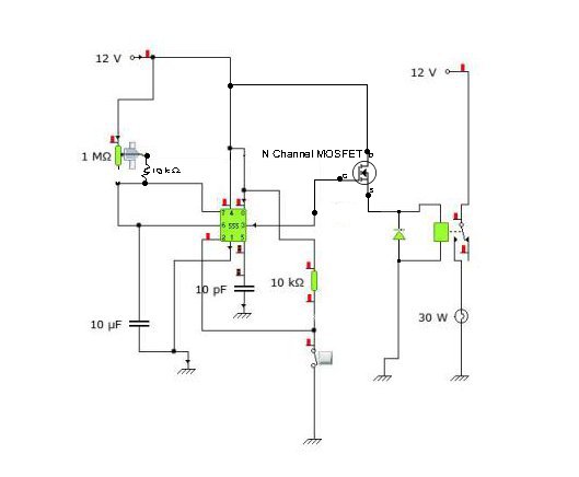

Hi i am making a circuit for my car. This will be triggered by the feed to the central locking motor (switch on diagram). The circuit will be providing a timed delay to allow lights to stay on for a set period of time when the central locking motoer is activated.
Can someone have a look at the circuit iv made up and see if its ok. It seems to work fine on croc clips.
Good Attempt.
Let me just highlight what I feel may be a few issues.
You need to have a "flyback" diode across your relay for protection.
Why is your variable resistors wiper (middle pin) connected to your output pin 3?
Pin 5 should have the 10pF straight to ground not to after the output diode.
Lastly your 555 Timer might not be able to directly drive the relay so you can use a N Channel Mosfet or leave it out your choice.
Suggestion:
Thanks for the reply. Tbh i dont really know what im doing hence the mistakes with the circuit. I will try this circuit and let you know. Thanks
