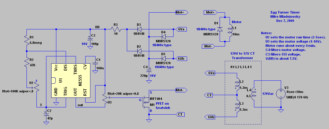

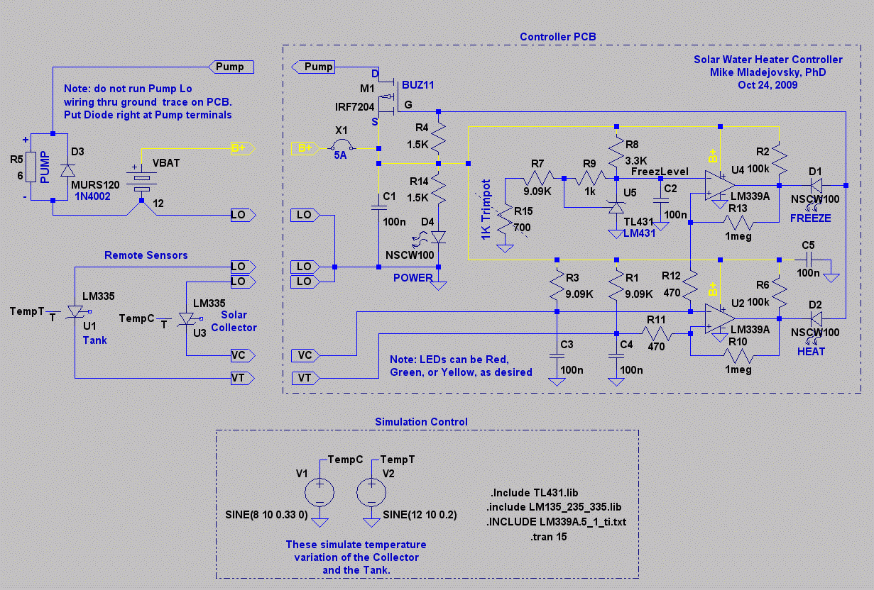

Hey mike, could you look over this alteration to your design and tell me the proper way to fix it. What i have done is added a 120v transformer. I was not aware that it changes the design of the caps and all. Also if you'll glance at the differential thermostat that you designed for me for the same alteration. Next time i will know better when i am describing my circuit. Thanks.

What is egg timer motor running current?
What is water pump motor running current?
What are the transformer specs?
Egg timer is 100 ma
The water pump will be 120v run off of a relay with coil voltage of 12v
Specs for the egg timer trans is center tap 6v/6v rated at 12v 450ma
The water pump transformer is a 12v 100ma standard transformer single primary single secondary.

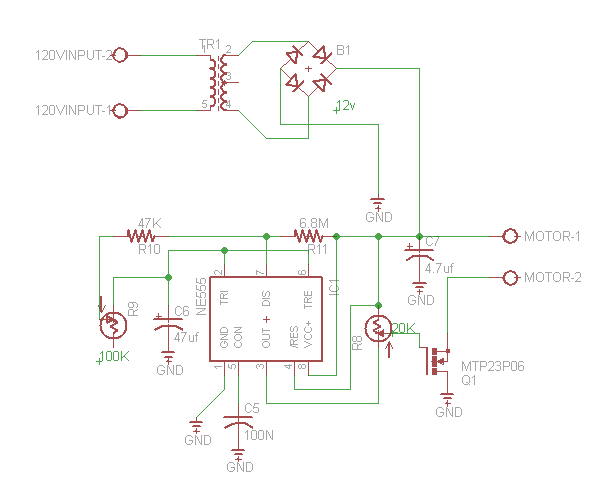

Do you have something that i could look at? A schematic of a circuit using this tech you speak of?
It would be nice to explore other techs but i started studying electronics only 2 months ago. I have learn a lot in that time frame. These circuits mikeim has helped me with are teaching me a lot. I am interested in different tech but i am just a newbie. Try not to overwhelm me with complexities, but i do like the challenge.

Here is a modified version of the Egg Timer. Since the goal is to run the motor off a reduced voltage anyway, I am using the Center Tap on the transformer to reduce the starting voltage to about 8V. The PFet dissipates less power this way. The 555 uses its own diodes and filter cap to keep its voltage more or less constant.

For the water pump, if the pump motor runs on a 12V battery, why do you want to run the timer on a transformer?
Here is the problem. I was using a 12v pump until it burnt out last month ( after 8 months). I am not willing to spend 230 dollars every year to replace the pump for it to run on 12v to say me 45 dollars in power savings. So i incorporated a 120v circulation pump in it's stead. I pay less than 80 dollars for these pumps, Which pump under pressure, last much, much longer, Are designed for radiant heat systems. I love my solar hotwater system but i have learned that i have to get away from the solar power and focus on the solar collectors, this is where the money is saved. As for now the solar power is a ripoff.
Please get me out of the 7404's i can't find one out of the SO-8 type. I need a fet that is TO-220 For simplicity of the homemade design. I don't do surface mount.

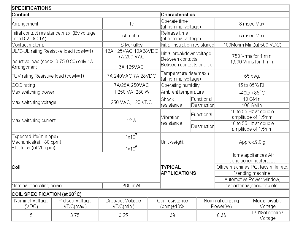

Ok, how many Ohms is the relay? What is the relay coil voltage? Is the relay up to switching 120V?
So you want the circuit to run on a transformer, and switch a relay instead.
I have 10 of these to use up.
