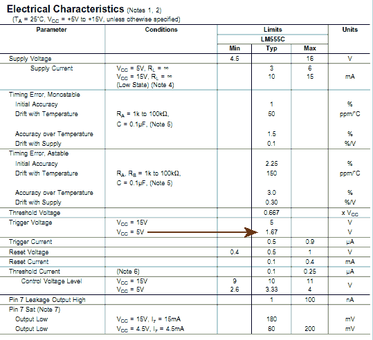

At 5V, datasheet shows trigger voltage to be 5/3=1.67V so you should get 2.0 from measurement if Vcc=6V.
I don't know why.

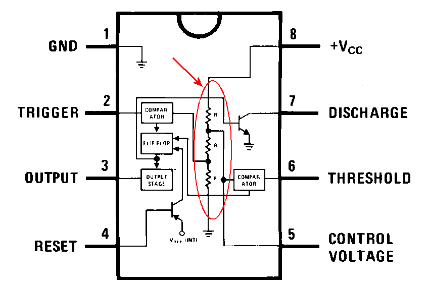

My understanding of the trip point voltages is that they are 1/3 and 2/3 of Vcc, which means they will be the same percentage when Vcc changes and thus the overall timing is not affected.
The 555 would function equally effective with 1/4 and 3/4 trip points voltages if the internal resistors values so determined. However, the 1/3 & 2/3 trip point will be the simplest as it uses three equal value resistors.

Sorry I have misled you. You should really get 2.0V because 5V/3=1.67V. Somehow I have difficulty mentally calculating 5/3.
