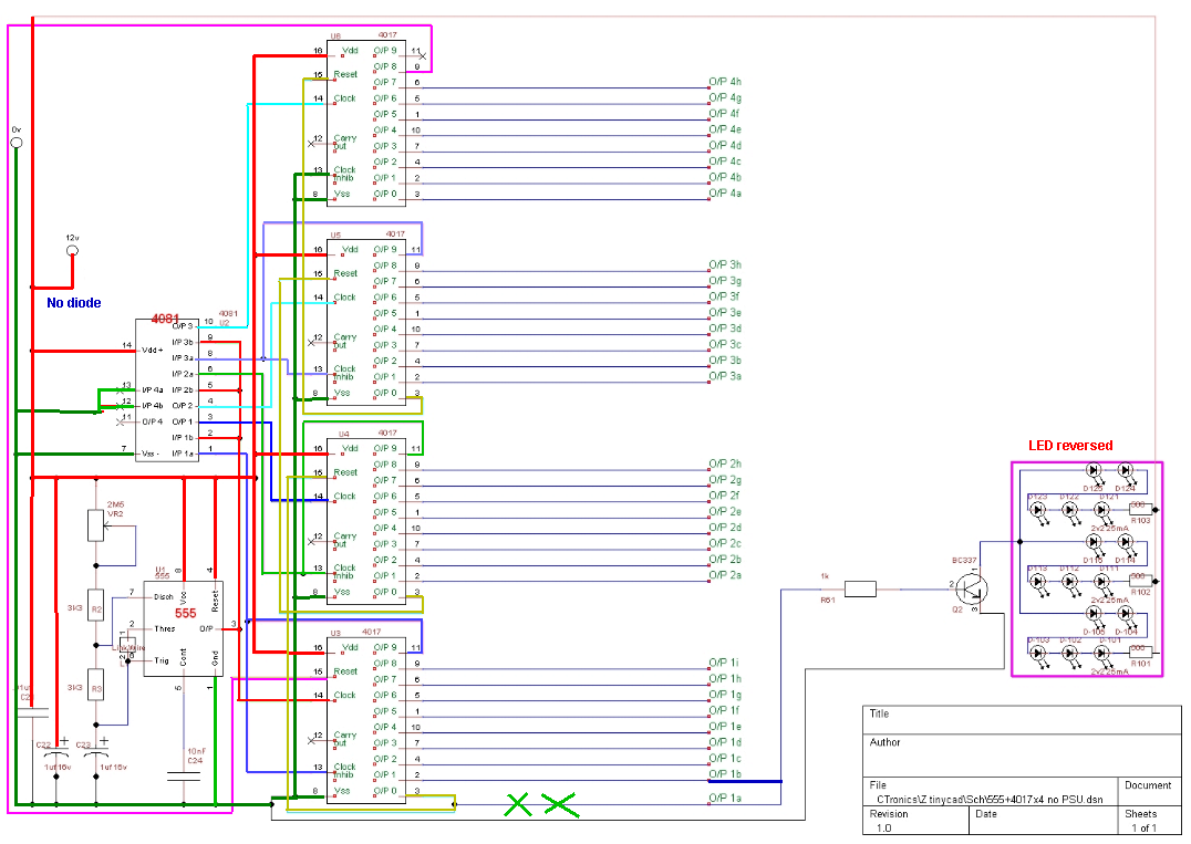

Can someone please check this circuit over and tell me is there any mistakes I need to correct.
The one thing that concerns me is U4 - pin3 - O/P 0 is just connected as an O/P and nothing else or have i missed something.
Yes I know that not all transistors are in the BUT its the only way I could get at least one on the page coz the rest would not fit
Many thanks
Steve

OK, its just that you used the 7 segment notation for the LED , ie 1a,b,c,d.....2a,b,c... etc
You do realise that only 1 led will be lit at anyone time thru the sequence?
I will look at your diagram.

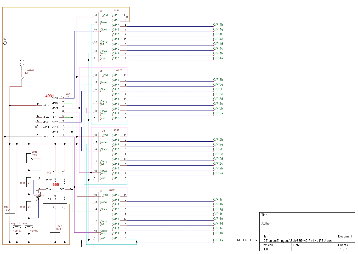

Just added a second diagram ,,, hope that helps
OH ,,, I see ,,, it was used to get the first page to the second page in the program ,, extending the wires from page 1 to page 2

Main connections look OK, removed the 1N914 diode, the LED's are reversed , also dont use pin pin3 Q0 on the 1st 4017 to drive a transistor.
EDIT: It is OK to use pin 3 on the 1st 4017... of course thats got 9 outputs and the remaining 4017 have 8 outputs:eek:

So lost I've lost O/P 1st 4017, power diode and turn the LED's around.
Please tell me, is it because I'm using the 4017 to drive a transistor at pin3 1st 4017 its not used because going by the data sheet you posted 4 me shows pin3 as an O/P and a resetting next 4017.

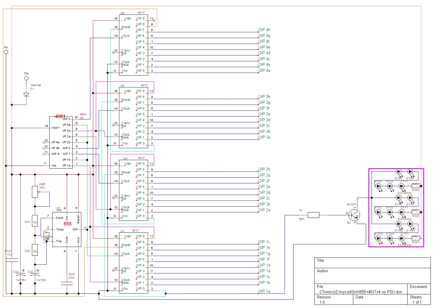

I dont know how many LED strings you are planning to attach to each transistor, or the details of the LEDs, but a point you should be aware of is that high current gain of the driving transistor will be as low as 10 or so, when saturated.
So this means that the Base current into the transistor will have to be 10% of the total LED collector current.
Also there is a limit to how much current a 4017 output pins can supply to the Base resistor.
Post a sub section drawing of the LED string and details of the LED's.
Eric

Each transistor hopefully would drive a max of 3 strings with a max of 5 LED's in each string.
LED's are 2v2 25mA colour matched from ESR if they have them in stock
I know 2 strings set up the same way will work as I used them on the slowish time you did for me.

So 5 * 2.2V =11V, you have a 12V supply!.. I would consider a LED current of 20mA.
So the series resistor has to drop 1V at .02A, 1/.02 = 50R
The total collector current will be 60mA, so the base current must be at least 6mA.

If its a 12V psu it should work OK.?? Puzzled why you think its not going to work??
Just use 47R with the 5 * 2.2V [11v] LED's, if you use 100R's The LED current will be 10mA.

Simply use Ohm's Law to calculate the LED current;
1) You have a 12V supply.
2) The transistor will saturate with a loss of about 0.1V which can be ignored.
3) The green LEDs might be 2.0V to 2.4V but let us hope that they are all 2.2V.
4) Five 2.2V LEDs in series total 11V.
5) the current-limiting resistor will have 12V - 11V= 1V across it.
6) The value of the current-limiting resistor for a current of 20mA is 1V/20mA= 50 ohms which does not exist. 51 ohms is the nearest standard value.
Because you have too many LEDs in series then their actual voltages are very important.
If their voltages are actually 2.0V then their current will be 39.2mA (when using the 51 ohm current-limiting resistor) and they will soon burn out.
If their voltages are actually 2.4V then their current will be zero and they might not produce any light.
Now try calculating the current with only four LEDs in series.
2.2V LEDs will have a current of 20mA when the current-limiting resistor is 160 ohms.
If the LEDs are actually 2.0V then their current will be 25mA.
If the LEDs are actually 2.4V then their current will be 15mA.
This is much better than them burning out or not lighting.
