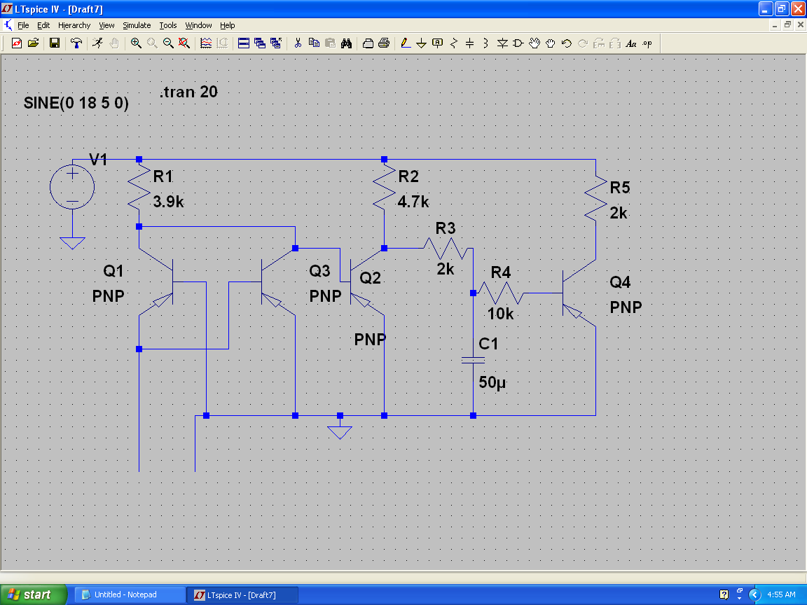

ah yes the power supply is AC not DC.
no wonder the simulation won't work.
I just want to simulate the circuit, not actually build it.
BUT using the correct voltage source would help.
will tray a square wave ac voltage,

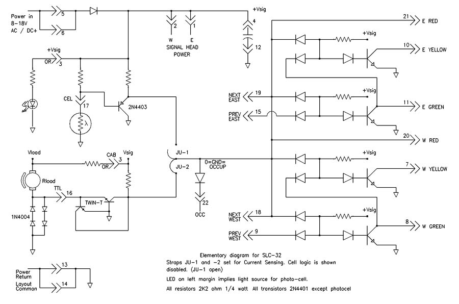

Let's see if I did this right.... The elementary is the circuit I use on production boards. It has provisions for multiple logic inputs from detection. The jumpers are shown strapped for Twin-T current sensing. Optional detection methods may be deleted from the drawing when they are not used. Take careful note of the edge connector symbols as they separate the circuit from the world.
The circuit is over-engineered because the open collector outputs permit interfacing with many different logic families, as well as driving LEDs, Lamps, and relays for signal outputs. I have other circuits that operate as slaves from this master.
The connection diagram is derived from the "beta" site I use to test concepts. He has both DCC(DigiTrax) and Analog(DC) running concurrently. Each block is selectable. Only one rail need be gapped for signals. The power rail is gapped for control purposes. These are the drawings referenced in the PDF instructions on my site.
This circuit may be more complex than you want. The important issue is the flexibility and simplicity of the Twin-T detection. Four diodes and twn NPN tarnsistors. If this would be useful, let me know, I'll forward high resolution foil patterns.

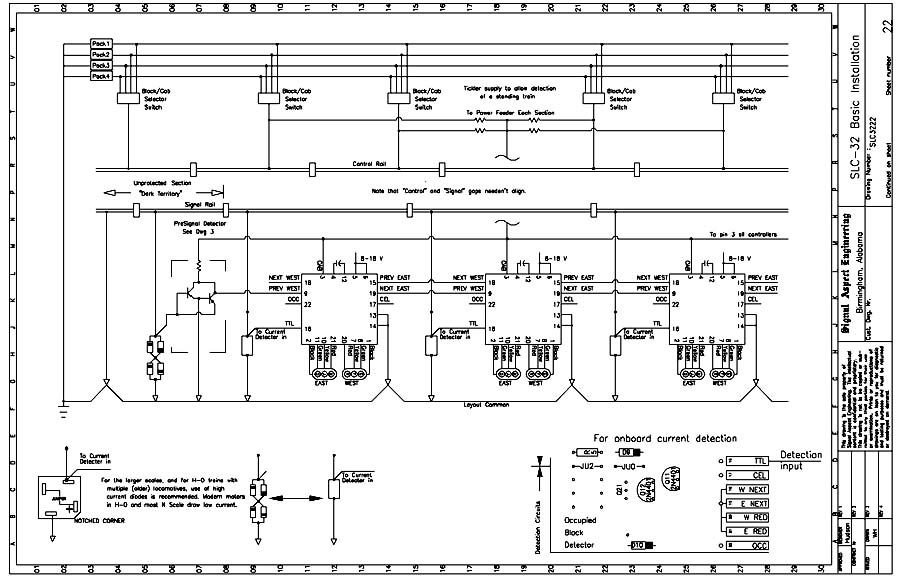

.........Only one rail need be gapped for signals. The power rail is gapped for control purposes. These are the drawings referenced in the PDF instructions on my site.

i AM PERPLEXED AS TO WHY?
RYING TO SIMULATE THIS TWIN T BUT NOTHING HAS YET TO WORK
USING ac FOR POWER BUT STILL won't work. Oups that caps lok)
I must be doing something wrong.

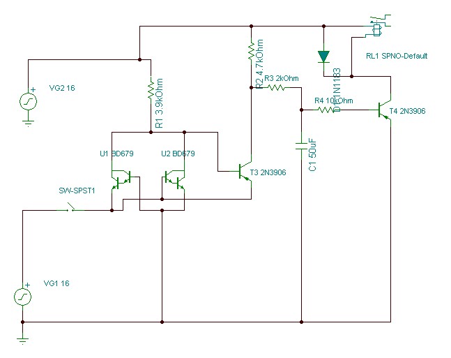

I got the same in TINA, won't function. I'm using the components as noted on the schematic but relay doesn't work for some reason.

MrDeb,
The twin-T transistors that you are using for your simulation program are Darlington Pairs. I don't really know what their characteristics are. But they should be just two "bipolars". i.e. Emitter, base, collector. Secondly there is no load anywhere in the track (DCC) circuit. The Darlington pairs are humping the DCC output's maximum current. I smell smoke.
Get rid of the Darlington pairs and substitute power amplifiers. Then insert a resistive load from between 1k to 8 ohms after the Power supply switch and the Twin T transistors. When that works increase the load resistance to 10K and on up until the circuit stop working.

Angie -- Where is the track in your diagram. I've never tried Darlington pairs in the twin t circuit transistors. Call up Radio Shack and ask them what they have as power "TRANSISTORS". I don't have my books here so I can't help. It's frustrating. I can't remember the nomenclature of the ones I used at ome.
Try this too. replace the twin t darlingtons with 2N3906s and insert a load of 2Kohms in series with the DCC power supply (after the switch). the relay should latch, and the 2N3906 wont burn up because of the high resistance across the track (Which you forgot to insert in the circuit)
Am not using a darlington pair.
using 2n3906's also tried several other type of transistors.
tried a 1 k resistor across the track rails etc.

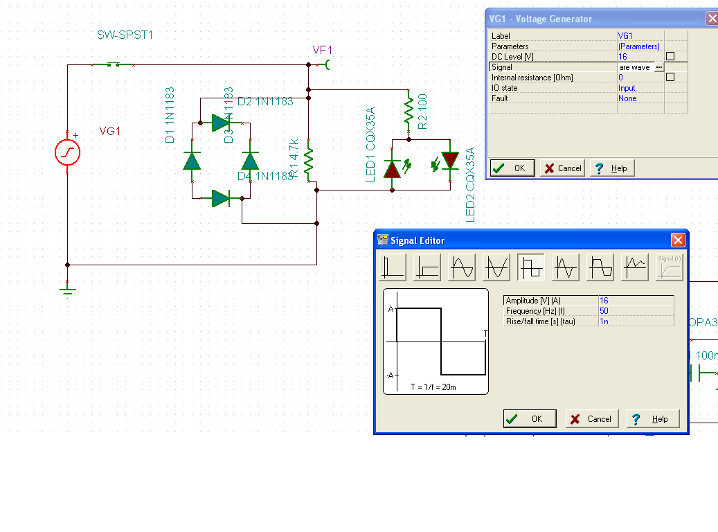

double click on your voltage source then signal editor then wave type, amplitude etc.
curious, how did you get the diodes at 45degrees? angles??

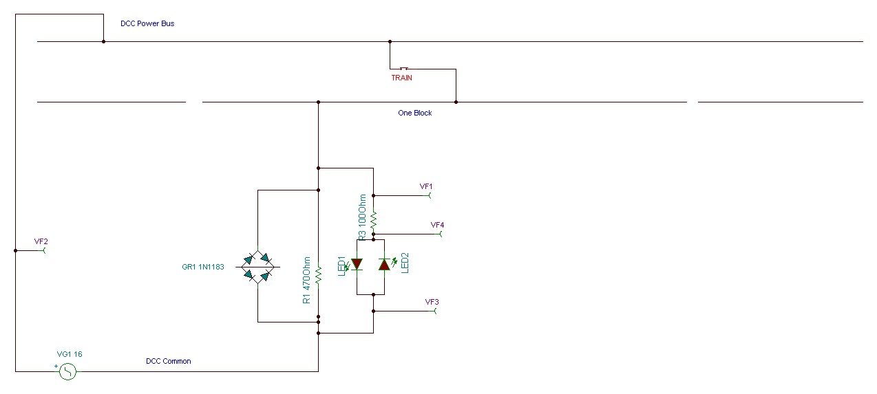

Mr Deb, Angie,
Attached more detailed info.
1/ Have customized circuit for Angie's requirements.
2/ Have attached also the current flow diagrams of both the positive and negative cycles of the DCC power booster.
NOTE to Angie. Your simplified circuit that 'works' on the simulator will actually work fine for only a short while. Both LEDs will be on at the same time for about two milli seconds before they blow. Hah! Why? I hear you cry. The diode rectifier provides an open circuit to the power supply. ALL of the high voltage will be across the LED circuit. Please put a jumper across the output of the rectifier. That will assure only 1.4volts for the LED circuit which is the intention of the bridge rectifier.
Once the circuit is working properly the LEDs will be flickerig at about 9Kilohertz. Does that matter to you? or do you want directional indications as well? The circuit will also not detect rolling stock occupying an unpowered section of track.
Also, be aware that your 16 volt DCC will drop to about14.4 volts. I think you can adjust your DCC output up to about 18 volts. That should do it OK.
Regards
pete

Re: Twin-T and darlingtons
The circuit I posted was designed with 2N4401's. Hfe on the order of 100. Also have used 3904's, 2222's, a few others over the years.
Darlingtons have extraordinary gain compared to bipolars. But there is some loss of speed. I had a couple of applications where I used MPS-A27 darlingtons. They work well enough to drive a relay. They didn't work reliably driving the logic transistors. Base-Emitter voltage is higher than a bi-polar.
The second drawing(installation) shows a Twin-T detector as a stand alone simply to excite a "Previous" input to a module. Far left side of the drawing.
If the two collectors are separated, each can drive an LED with independant pull-up resistor. Thus providing directional indication. The rest of the circuit is display logic.
I do concede the complete circuit is somewhat over-engineered for what you desire. By studying the entire circuit, one can pull out that portion that is useful and ignore the rest. The Twin-T can actually be implemented with only one transistor and a pull up load. Relay, lamp, or LED and resistor.
There already is a jumper across the rectifier's output. It's the horizontal line in the middle of it.
Directional is not relevant.
The led will be replaced by a photocoupler **broken link removed**
I thought a resistor across the axle of wagons would make the circuit so te led/photocoupler would be tripped. Is this not correct?
