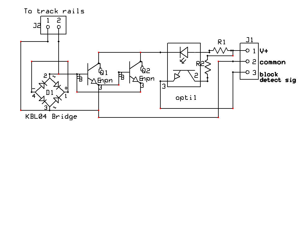

3 aspect model RR signalling help plse

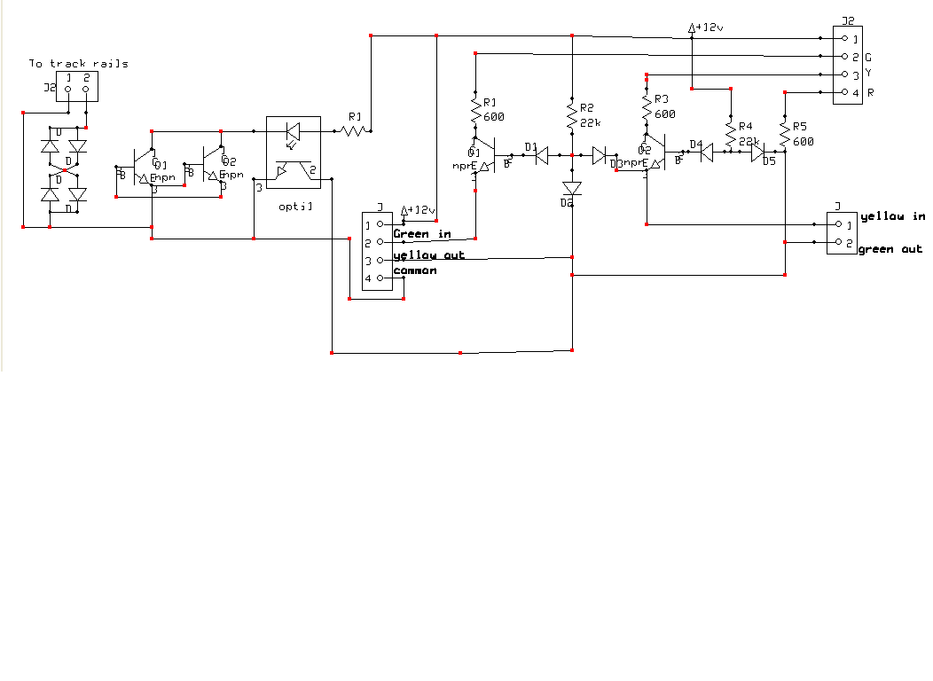

schematic for TWIN T modified
I put a bridge rectifier instead of separate diodes.
probally take less space if I did the separate diodes.
If I remove the connection between the emitter of the photo coupler and just have it going to the detect , the block detector doesn't work anymore. Seems it needs the ground.

I forgot the resistance get's less the more you add.... There's me thinking it get's bigger and eventually will not allow enough current to power the led let alone a loco!
As for the led being lit by an optoisolator, the led shown won't actually be there, the collector of the photocouple connects to the detect output on the signalling circuit. When the photocoupler lights, the detect circuit is made and signal turns red (block previous to one loco is on. This in turn set's the previous block to that to yellow. If wagons stretch to that previous block, their resistors across the wheels turns that block red, and the previous one yellow.

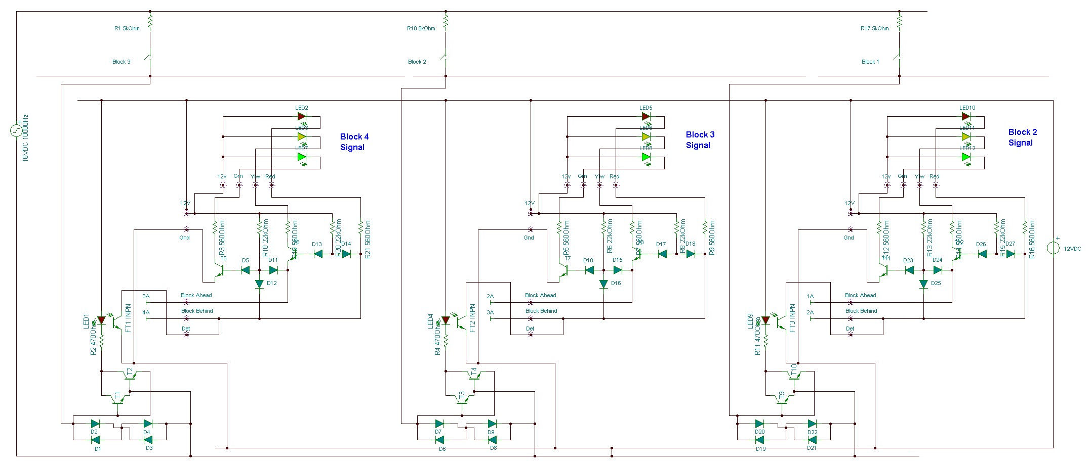

And here's the full circuit, for each block and signal.
J3 goes to block ahead of loco to switch yellow when block ahead switches red.
J2 goes to block behind loco to switch the previous block to yellow when J4 is switch by the block detector.
I'm so happy, you've all had reputation added. What a team... :D
Now to work out the PCB for the detector bit. That way if the detector goes wrong, I can swap just that section, likewise with the signalling part.
Hi Angie,
Er Um? That's cool when the train goes TO town, but does it come back or do all the passengers have a one way ticket. :) OR do you just have a circular track OR are you using double track.
Are you by any chance using the same signal circuit to drive the signals in the opposite direction? If so your opto isolator has to drive up to 4 LEDS at 15 Ma per LED. Can you sim the detector opto-isolators current limit when driving 4 LEDs at 15 milliamps each. I think it should be OK but it's worth a check.
went wild and simed up o 89.1K at 89.2 the LED goes out (off, no light, not on etc.)
he DCC voltage would have effect on this for sure.
tried varing the battery voltage from 12 - 24, didn't make any difference.
Hi MrDeb,
Using the DCC 16v supply at 85K ohms *about) the voltage across the diodes drop below 1.4 volts and they are effectively out of the circuit. Now the 1.4 volts is across the Twin-T. a furthe increas in track resistance drops this 1.4 volts towards the transistors PN junction minimum level (No i'm not going into it) which is around 0.7 volts. At less than 0.7 volts the transistor stop conducting. That is when the total track resistance reaches 89.1(5) K. Increasing the Twin-T voltage makes no difference. Increasing the DCC voltage would. Hope that helps.

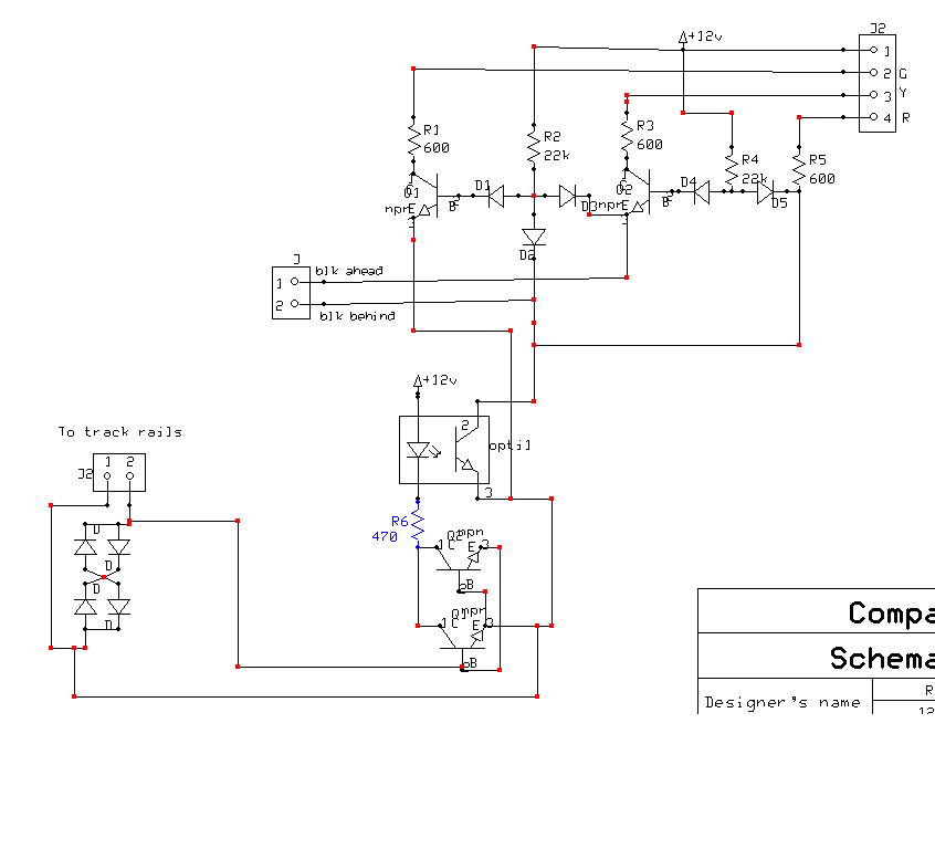

hopfully this is right?
your wanting the block detect and signaling circuit on one board?
would be easier to put several of same circuit on one board.
double check if this is rght??

Here's a photocoupler I have seen. Not a clue what to look for but in the first section of specifications it does say 50mA max forward current. Collector-Emitter voltage 35V.
However the second table say forward voltage 1.2V. Now, is this because it's an LED and requires the resistor as per schematic?
https://www.electro-tech-online.com/custompdfs/2009/12/0900766b80b79076-1.pdf
Hi Angie,
The forward current voltage drop is 1.2 volts. You have to take care of that with a limiting resistor. The resistor should pass 50 Ma at 12 minus 1.2 volts.
470 Ohms should be OK, but I'd try 560 Ohms first. The collector emitter voltage is a maximum. You are only using 12 volts so you should be OK.

Sent you TINA circuit of 3 blocks. Will put up schematic as sent once I'm back on main computer. This laptop is sooo slow.

updated schematic for one blk
how many per pc board (3?)
trying to cut down on the number of terminal blocks needed.
they could add up
