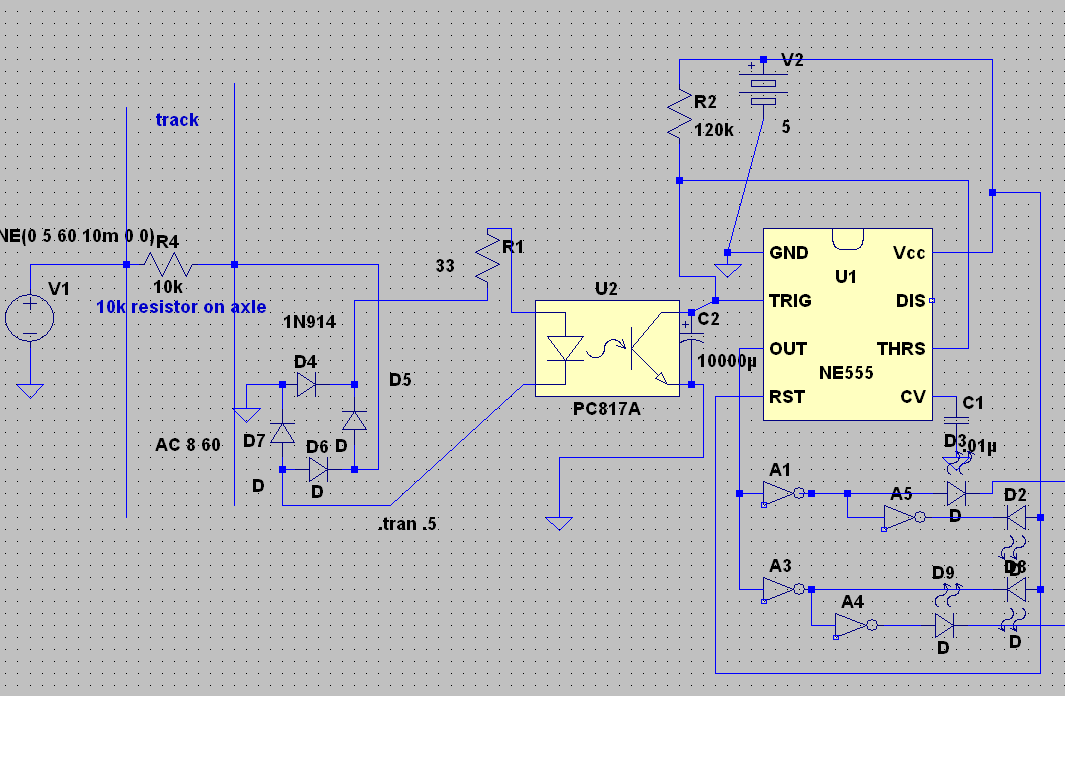

Here is a pic of the NMRA circuit. VERY simple for sure. And it actually works in LT Spice.
Got a basic circuit in TINA working as well but no 555 or other componetsetc.

Nice circuit. Opto isolator driven by the voltage drop across a bridge rectifier is a nice touch. I think one loses about 1.4 volts across track power but for DCC that is moot. Isn't the NE555 a timer though? That would mean the signals go from green to red and stay that way depending on a time lapse rather than the ocupancy of the track. Or do the signals stay red until a preset time period after the opto isolator goes inactive (track clear)?

I'm afraid I can't see how this works.
I see where the AC enters from V1+ to track then thru R4 and connects to the bridge between D5 and D6. I also see it returning to V1- from between D4 and D7.
Surely this means current is always flowing thru U2 when a loco is present therefore the NPN in U2 is always on when a loco is present but not when no loco is there. This begs the question why is a bridge required? Why not just put an AC optocoupler in line and when a loco is there it switches on?

The detector part looks a bit confusing to me too. I thought the bridge was used to form a constant voltage to drive the isolator. But taking a closer look I find its a simple bridge rectifier. There is always current flowing through the 10K and 33 ohm resistor via the bridge and the Opto isolator. I guess when an engine comes along it shorts the 10K resistor allowing a higher current to flow through the circuit and "illuminating" the IR LED. I guess an AC isolator would work too, but I'm thinking that the DCC alternating voltage adding and subtracting from the opto isolators AC might have something to do with it. What you don't need is a set of 100 cycle pulses leaving the isolator and being fed to the NE555. I'm missing something here.

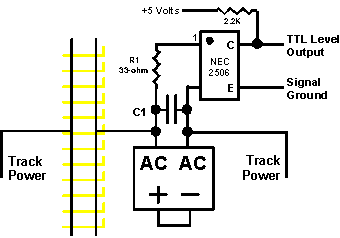

I'm doing something wrong here. I go to your link and I get the NMRA site. The circuit they discuss uses a shorted bridge rectifier in series with track power. This provides a constant 1.4 volts across the bridge. The circuit takes that 1.4 volts and uses it to feed the Opto-isolator. Am I looking at a wrong page?

I was looking at this one (see attachment) but now you've shown the bridge in diode form it doesn't make sense. The AC squarewave flows when a loco is on the block. One rail is uninterupted and the other is divided into sections (blocks).
I think this is where I got confused. I thought this circuit detected a fall in current, not that current was present. So in theory, if this senses current, i.e. when a loco connects the two rails and current flows, this is when the opto isolator fires up switching the npn and thus switching my signalling circuit.
But as they've drawn it it's taking all current restricted by the resistor so is this going to leave enough for the loco?
That's the diagram at the NMRA site. The full wave rectifier's only function is to provide two diodes in series with AC power One set of two for the positive cycle and one set for the negative. Note the shorting jumper at the + and - output. A silicon PN jumction always drops 0.7 volts no matter what the current. So if the 16 volt DCC current is 1.6 Ma through a 10K resistor the two diodes will drop 1.4 volts. However the 2Ma may not be enough to light the opto isolators LED. If the Opto unit requires the standard current to light the IR transmitter then I think the maximum resistance across the track should be closer to 1K. But anyway, the 1.4 volts stays constant even when the DCC current is 2Amps. This is what the Twin-T uses across the detector transistor junctions, except it uses two back to back power diodes which drop only 0.7 volts.
Now my DCC unit can deliver two amps before the safety breaker trips. If I change to a four amp unit I have to replace these diodes with four amp ones OR forget about diodes and use four amp power transistors. On the NMRA circuit, what happens during a derailment. Does the bridge rectifier fry before the breaker cut off power. I hope so.

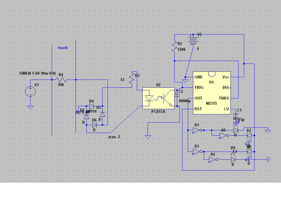

I think I found the problem with the NMRA diag you put up. There is a jumper missing. There should be a wire jumper between the junctions of D4 - D7 and D4 - D5. Could you try that on your simulator program and see what happens?
jumpers are there??
covered up with type
here this is better.
and they both seem to work

Well, according to the NMRA diagram the + and - terminals of the bridge are connected together. This means that there are 4 diodes connected in pairs back to back and in series with 16 volts DCC ac power. The bridge is nothing but a low cost 1.4 volt regulator. That jumper in the bridge lets the bulk of the engine motor current through the bridge diodes and not the 33 ohms +opto-isolator. If I got this all wrong then that 33 ohm resistor in series with the Opt-isolator would limit the engine motor current to ½ Amp. Also that resistor is not alone in that circuit. The opto-isolator also has to pass that ½ Amp. I'm not getting something here.
Can you replace the 10K resistor across the track with a ¾ Amp load. A motor or a 25 ohm 15 Watt resistor should do it. Then crank this configuration through your simulation software and see what happens? I am really curious now.

Took a look at DigiKey's specs on the NEC 2506 Opto isolator. Came up with the (disappointing) attached sheet. As given in the NMRA circuit the detctor is not so sensitive. A single car has to provide a resistance of 1.6 Kohms across the track because that is the very minimum current required to trigger the isolator. A fifty car train would add ½ an Amp to the load. That is almost as much as another engine. There is another problem with a single car scenario. If a 1.6Kohm resistor is strapped across one axle and a single set of wheel contacts with the track this would be fine providing the wheel contacts are squeaky clean. So, I hear you cry, why not put resistors across all the axles. They must all be 1.6 Kohms then because if one or more wheel contacts open up on that single car a higher value of resistance is formed and the isolator trips out. A good compromise is to put resistors on half the axles. That is OK until you realise that with a 50 car train that puts an extra Ampere load on your booster.
So if Angie arranges to operate a short line with trains of about ten cars max, this device would probably be OK.
