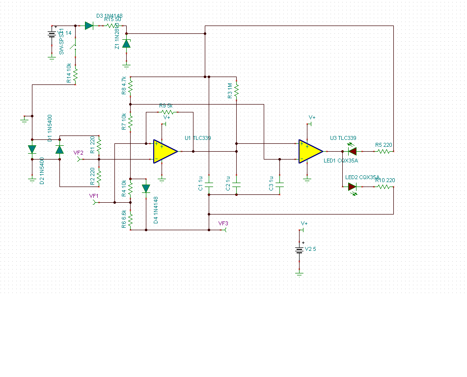

I'm unable to do the schematic in tina as the only optocoupler I have is the 4n33 which shows the led and an npn transistor with 3 pins, collector, base and emitter. The one I need is without the base as I'm certain the base is replaced by the led lighting.
if your talking about the Q1 1(4n33) all I did was use an LED.
if LED lights up your good to go.
The opticoupler has an LED in it so if LED lights up then the optocoupler should go on as well.
You need to improvise, no big deal.
here is screen shott
will send you file as well
I need to use AC as input voltage

I have something not right??
are the diodes in series with the track?
Block Occupancy Detector
am assuming the DCC powered track is 14vAC at 60hz?
I am just not getting the schematic of these block detectors.
something does not jive??
Diodes in series

Yes that is exactly it. The four diodes are in series with the track juice. The detector takes advantage of the fact that, when conducting, a PN junction drops about 0.7 volts regardless of the current passing through it. Whether the current is 2 Amps or only 20 Ma, the voltage across the conducting PN junction will be at 0.7 volts. Each diode pair is in seies with only on half cycle. First one pair conducts and then the other. The opto-isolator is an AC device. The internal LED is actually a pair of LEDs, back to back just as the diodes.
DCC is not 60 Herz. Sorry, when we say AC that's what people think. DCC is effectively a computer communications port, running at 9600 baud. It can also pack a punch of 2 or 3 Amps. The engine decoder reads these pulses just like your serial port on your computer. It then passes the data to the on-board engine computer on the chip. The on-board computer decides if any data received is intended for itself. If not it throws it away. If the engine recognizes that it is being addressed the data bytes following the recognition byte (engine number) tell the motor, lamps and sounds what to do. There is another thing going on all the time though. The pulses can punch a high current, but as square waves, when rectified they produce almost perfect DC. That DC is used to drive the engine.
You can look at it this way. The pulses come in and a little bit of the enery is taken and decoded for the computer. The pulses are then passed to a rectifier to supply power to the engine and decoder.

I have been sitting at my computer and have drawn up a detectors with great sensitivity. I have stripped it of components that are essential for DC operation but not needed for DCC. The board need not be etched. Saw cuts can be used. It is about 1" by 2½" square and has ten maintainable and understandable components on it. It is designed for non-Tesla people. I want to make one first, see how it works and maybe pass it along to you. Are you game?
POST THE SCHEMATIC
then can simulate.
seeing how I am way off base on simming AC anyway.
do you suppose Instead of injecting AC just use dc for power to the compatator circuit?
using simple 741 op amps (really cheap etc) seeing how the twin T is using transistors anyway so I assume DC should work for simulation??

From the schematic I'm assuming that the AC power is always on in the circuit but not on the track until a loco enters that block or something shorts the rails in some way and takes power from the rails. This is when the power to the detector reduces and operates the switch.
It does appear that the circuit only uses one phase of the AC wave though and can do this because of the capacitors.
