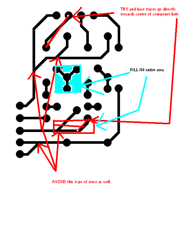

reason for 45s instead of 90s is when you etch the board, the etching solution can hang up in the corners. plus you have less chance of broken traces.
My offer odf sending the transfer paper still stands. then you can iron it on and etch it. lots easier than drawing the traces.
Its really no bother. remember stubbornness can be a good trait but can also lead to failure or disappointment. You run the risk of learning a better process to etch circuit boards.
some recommender fixes on your design
pretty good design, just needs some tweeking
see attachement.
the less copper you remove the less etchant you need.
try and stay away from 2 oz boards (more for thinner traces) as the etchant can undercut the copper.

Hi Pete, Yes I can view the doc. Thanks for the insight but....
Correct me if I'm wrong but it looks like you're using a relay to each grn, ylw and red.
How are they linked to the detect circuit and further blocks to allow automatic synchronisation and what are you using for block detection? That's the next bit of this project so would be interesting to know.
For a subminiature 1A relay I'd pay £2.88, yet for two 2N3904 transistors which are performing the same function, a switch, I pay £0.098 pence. Please correct me if I'm wrong?
One unit of my current design is 74 pence which includes one 3 way screw connector and two 2 way screw connectors. Also I will be able to connect the detect out to the seep point motor so as to change the signal when the turnout is against the loco.

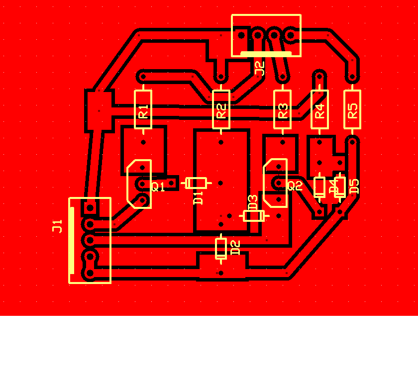

revised board
with filled planes to cut down on etchant and time to etch.

I'm new to this forum and have not figured out how to attach a Microsoft Word file to ta posting.
Please avoid diagrams in Microsoft Word. Some of us can't or won't (vbasic scripting risks?) open them.
