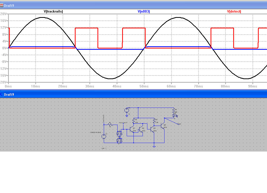

MAYBE reason the output transistor on the twin t won't go to ground is due to the fac that the ac from the track via the diodes are producig a square wave thus the transistor is switching from on to off?
let me take a pic of LT spice
here is a pic of output measurments
the input is at 20hz ( easier to read instead of 10khz)
principal the same
this is just theory. maybe way in left field?
perhaps this is why most go with relays or comparator circuits?
could also be reason for opticouplier not working and dim LEDs
principal the same
Try and input a square wave across the track. A sine wave will prob generate those squares at the cross over. A square wave 'may' produce spikes depending on the DCC manufacturer.

yes but the dcc outputs ac ??
so inputing AC to simulate correctly?
this I think (now there's a thought) that the opti couplier is pulsing as is the transistor switch.
as I said, maybe thje way to go is a voltage comparator?? of add one to the twin t. let the twin t do its thing and the comparator or opamp smooth out the voltage??
just a thought.
Hm?
DCC does not put out AC. AC implies a nice sine wave. Your diagram shows nice square 'zero cross over' pulses. These pulses are caused by the low voltage threshold across the diodes when going from positive to negative and back. In actual fact by using square waves these pulses are extremely narrow and are in the sub-microsecond area. These can be shorted out by placing a very small capacitor either across the diodes, or a larger one after the booster output that is part of the debouncing RC delay circuit (as per my last updated post).
Angies's idea of playing around with opto-isolator in the booster transistor is a good one. The spikes can be made to bypass the LED via a 0.01 (or abouts) microfarad cap across the LED
However there is also a practical aspect to this. The spikes are very narrow. At 20 Khertz (one for positive to negative and one for the negative to positive. The time of LED flicker is about 2%. this is not enough to be noticed by the human eye. I have a hand held scope but the frequency of the spikes is at the limit of its capability. So I might have misread the display.
