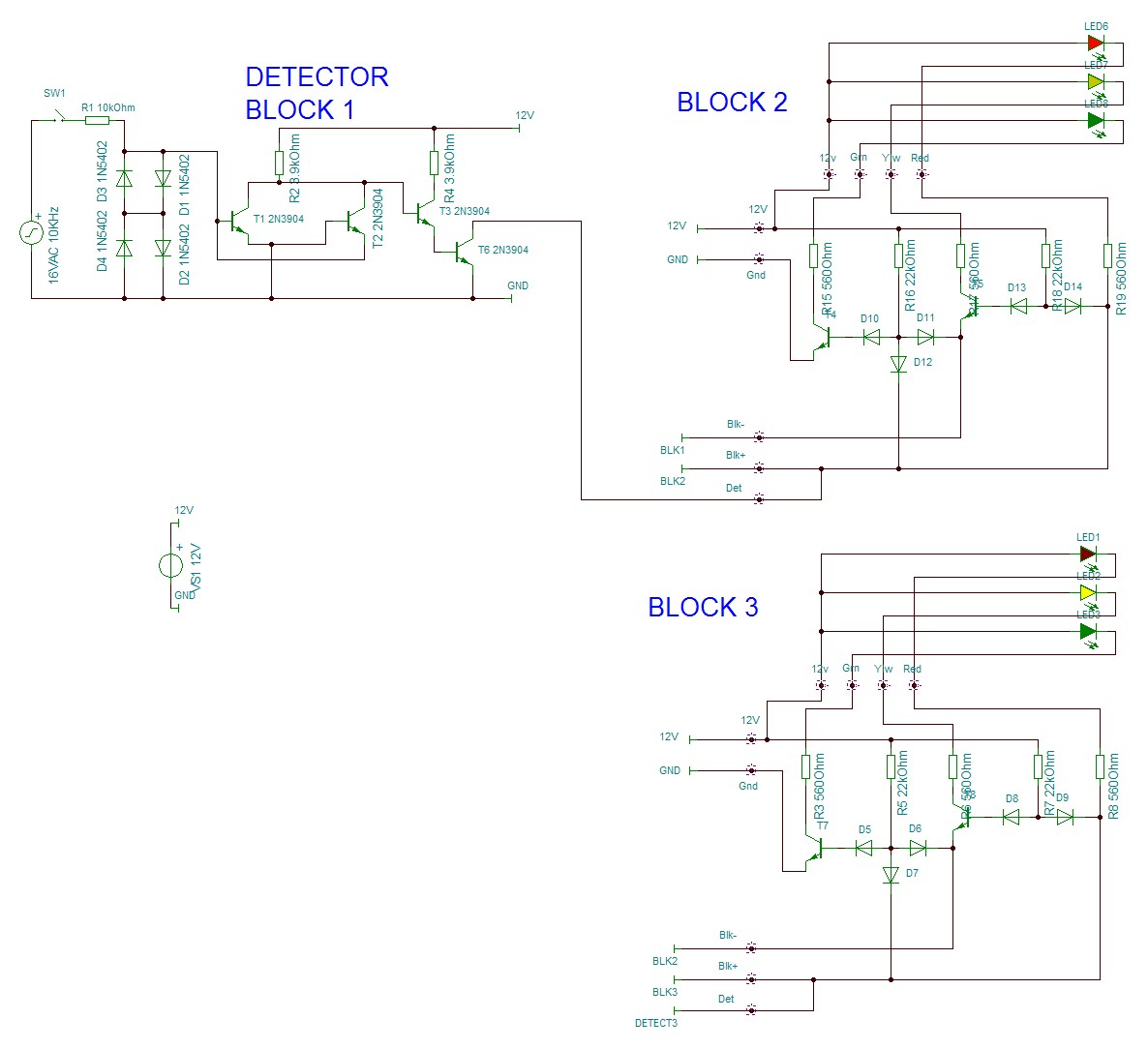

Ok this is what I built. Red is active with yellow on previous signal active.
This is with or without loco present.
I actually used a 3.3K resistor as I don't have a 3.9K

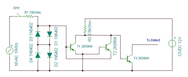

That's cool so far. Now put another transistor in the circuit. First take your detect signal and connect it to 12v with another 3.2K resistor. Then connect the junction of the new resistor and the collector and use it as the input to another transistor. The open collector of that should now be used to drive your signal controller. You should now have four tansistors in the circuit. You should have two for the Twin-t which is normally off with a high collector, one for the booster which is normallting and a collector close to ground and one for the signal driver which is normally off. When the Twin-T is triggered it will turn the booster off and that will turn the driver on.

All transistors are 2N2222As. Your pot is only isolating the Twin-T transistors and turning T3 off. Hm! Add the third stage.You can leave out the RC debouncing network and put a 10 to 12k resistor between the collector of the booster and the base of T4.
Once it's is working add R6 and disconnect your DCC power from the track. The twin-T should still detect. Go fer it.

I just sent you a new diagram. Connect your detect (now open collector)output from T3 to 12v with a 3.9K resistor. You now have a plain ole' amplifier. Now connect the collector of T3 to the base of T4 with a 10 or 12K resistor. The emitter of T4 goes to ground and the collector of T4 is the new open collector 'detect' output. If you connect that to your signal controller it should indicate a green until the Twin-T triggers. Then the reds and yellows should come on.

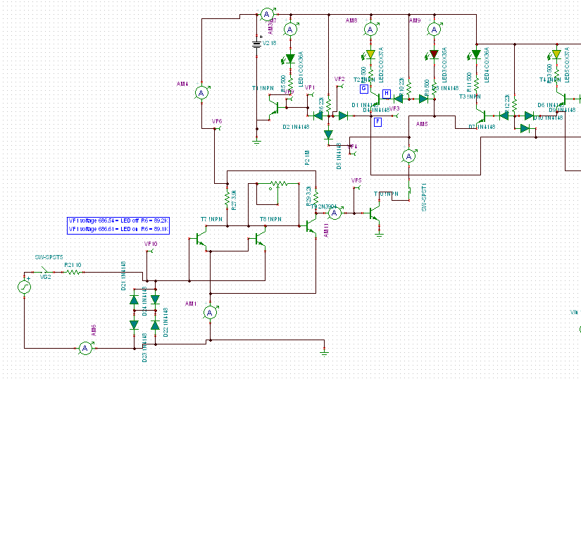

Ok, haven't got your schematic as yet but this is what I tried and the sim says it should work.
Tried it on the real thing and red with yellow on second block stay on.

Ok, update on my last.
I hadn't connected the two gnd's together. Now the gnds are connected, the red and yelow are nearly out with the greens nearly at full with loco stationary.
When loco moves they dim more and the greens get brighter slightly.
Tried your circuit and
No loco: greens all the way.
Loco: current block, green on, red dim
. ...... second block, green on, yellow dim.
Loco powered up: red and yellow dim further but still lit.
Admittedly I have had to use slightly different resistances and have no capacitor. :(
GOT your posted circuit working in TINA
wish I could post circuit but my PAINT program won't retrieve the clipboard data? (shift/print Scrn) paste into PAINT.
been working all along until TINA crashed yesterday?
Anyway, add a pot between collectors of T1 nd T2. 1M set at 80%
what I did was place a LED into the collector of the T4. adjusted pot until LED showed no current with 10-10k resistor across track rails.
connected to block sig circuit and volia it worked. no dim LEDs (I put amp meters on all the sig LEDs.
Maybe by reseting the computer it might get the clp board working again.

OK I guess the circuit diagram will explain it. But the third transistor's emitter should be connected to ground and not to the base of T4. Then take a 10 oe 12 K resistor and connect that to the base of T4 and to the collector of T3. Right now T3 is conducting and causing T4 to conduct. When the Twin-T triggers T3 cuts off leaving T4 with a very high (open ??) to 12v. This does not turn T4 on fully. Check the diag I sent you and confirm that you have it please. I missed something last noght.

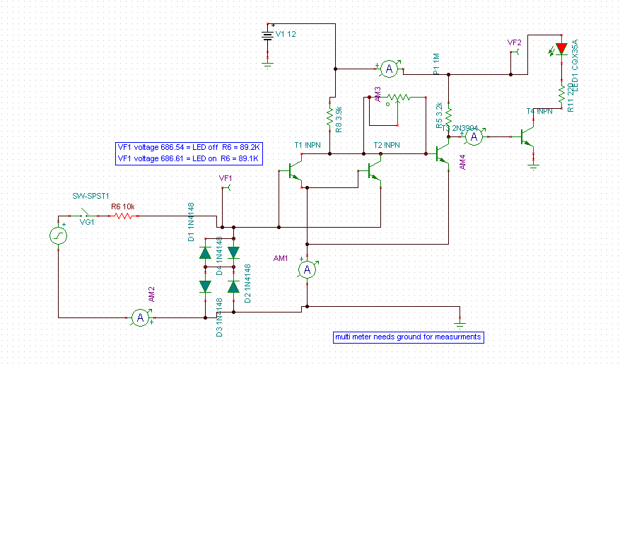

got it working!!!
no relays etc.
I simed Petes circuit yesterday = nada wouldn't work?
here is circuit I tried in TINA as per Angies suggestions and VOLIA it worked.
tried a 10 - 10k resistor across the rails. ALL a go
I see no posable dim LEDs as the amp meters show none.
the "detect switch" transistor shuts off completely etc.
now have Angi actually build circuit for actual testing.
I would breadboard but have several Christmas projects to finish plus I have no 18v AC supply or 18V dc supply.
ALL my voltage supplies are batteries.
