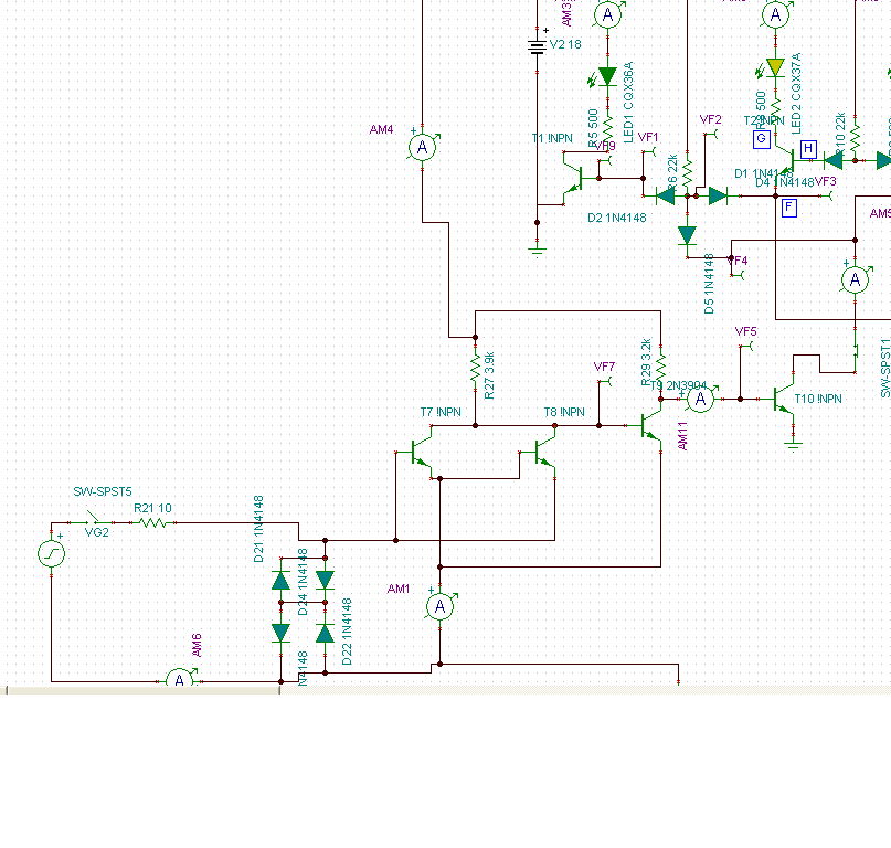

here is circuit I tried in TINA as per Angies suggestions and VOLIA it worked.
tried a 10 - 10k resistor across the rails. ALL a go
I see no posable dim LEDs as the amp meters show none.
the "detect switch" transistor shuts off completely etc.

Er Um! can you take another look at your circuit. You have t7 and t8 collectors connected together and from there have a direct connection to the booster transistor. It is DIRECT. It is a wire. In parallel with that wire you have a pot. What is the function of that shorted pot?
If TINA did not flag this non-function it gives me pause to conclude that it's just a toy. That is why it's free. iiiiiiiieeeeeeAAAAAAAA!!!!
Take out the pot. Insert 0.1 micro farad cap across shunting diodes (t7 base and ground). Then tell TINA that the transistors are not just NPN. Tell TINA that they are specifically 2N3904s or 2N2222As. Then place an LED and 500ohm resistor in the collector of the driver transistor. Measure the current when the driver is off. trigger the twin-t and measure again. The LED should be on. Not dim but fully on (15 to 20 Ma).
Then calculate the signal controller's resistive load. Because that will be what the driver transistor will have to handle. Remember that load will vary too. (ie what is the load when green is on, what is it if yellow is on, what is it if yellow is enabled, green is off and red is on) The lowest value is what the driver transistor has to handle. from what I see it should be OK.

volt and current readings
using attached circuit
track empty track occupied
VF5 53.41mv 814.62mv
VF7 825.95 42.16
amp meter reading to base of T10
-3.5pa 5.37ma

When I draw 1/2 amp across the track my twin-t collectors are close to 0 volts. When I put 4.7k acrosss the track I read 0.1 volts at the Twin-t collectors.
When my track is clear the collectors are at 0.7 volts.
Angie.
Please put a ground into the input of your signal controller. See if the green is completely out. Then see if the red is fully on. Then check the two yellows. See if they are on. If all is well then we know that the twin t is not delivering the full ground that your controller needs. Now deliver the full ground to the sig controller via a power diode. (0.7 volt drop -- remember). If the LEDs are misbehaving then your signal controller actually needs a rail to rail ground. So what to do. MrDeb sent you a site which a controller which has a similar circuit to yours. Lots of diodes and transistors. But at the bottom of the page the detect is a mechanical switch, probably from a relay. It too needs a full current bearing, 0 volt ground.
Let's find out where the problem is. Is it the twin-t or the sig controller.
It just dawned on me that the circuit that Pete posted and the one I just posted are almost identical.
exception = I don't have R3 or R4, no relay or capacitor
R2 is 4.7k in Petes where I have 3.2k
all else that I can see are same or ??
with 36 ohms across track (caculates .5ma) amp =451.82ma
with 4.7k across track = collectors VF7 = 17.02mv
track clear = 825.99mv
trying to duplicate Petes readings . CLOSE for sure

I think the twin-t is working fine. The output, designed to operate a relay, is not sufficiently close to absolute ground. (0.7 volts, I bet) that the LEDs are 'sharing' current. All the transistors in the controller are referencing absolute ground. Maybe putting low value resistors (or even diodes) in the transistor emitters might lift them enough so that a base voltage of 0.7 volts will cut them off. If you apply a ground to the input of the controller and everything works then we have the nub of the problem.

NoI just wanted you to fake a detect by grounding the input to your signal controller. But I guess you answered my question. How were the yellows by the way.
Hm! seems that the twin-T circuit is good enough to latch a relay but not good enough to supply a pure ground to other electronics. Opto-isolator all over again. I'm going to ask Bill about this. Stay tuned.
