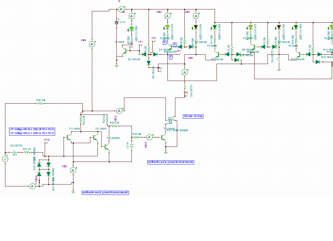

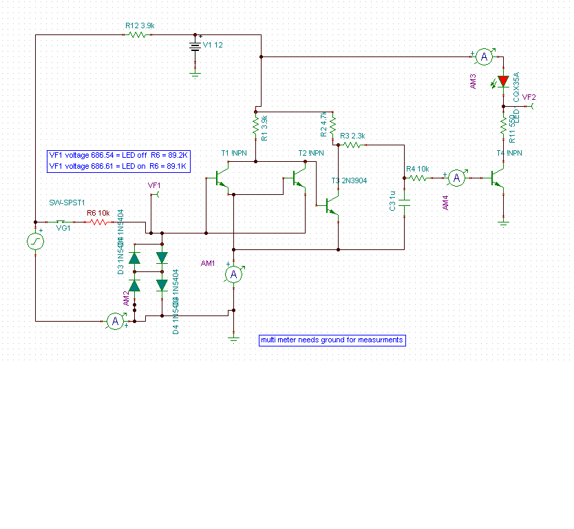

here is the circuit you have built.
can't figure out how you get a dim LED.
I changed the track resistor from 10 - 10k
I get very little current draw at am3.
what LEDs and how much voltage do you have at VF2 with and without loco?

MrDeb Angie. I have about 900 Ohms in T4s collector circuit and an LED. Also the cap C3 is too small. 47 to 100 yF works well.
Vcc = 11.5
T4 collector no detect = 10.5
T4 collector detect = 0.05
C3 = 100yF or 47yF.
During no-detect that means I have about 1 volt across the LED and the 900 Ohms. that's not enough current (1.6 Ma) to turn it on. Track resistance make no difference.
Locos.
Angie are you just putting two locos on a test track and having them stand there or are you actually running them. The decoders in quiescent state have high resistance, and its the decoders that contrll the motors.
Also have you measured your relay coil resistance yet. If they are 12 volts and have a coil resistance of over 650 ohms they should work. In the mean time put a 1K resistor in series with the LED. 550 Ohms is a little low and you are exceeding the upper 20Ma limit just a bit.
TINA sim is close to actual
at T4 collector
no detect = 82.6mv
detect = 11.91
using 550 for LED resistor as the meter AM3 shows 18.77ma
with 1k = 10.39ma
on the relays, most 12v relays I have seen are 400 ohm.

We have a winner!
using Petes revised circuit and the signal circuit that started this thread we , pretty sure, have a winner.
using the small relays (see link I posted) for 320 ohm relays.

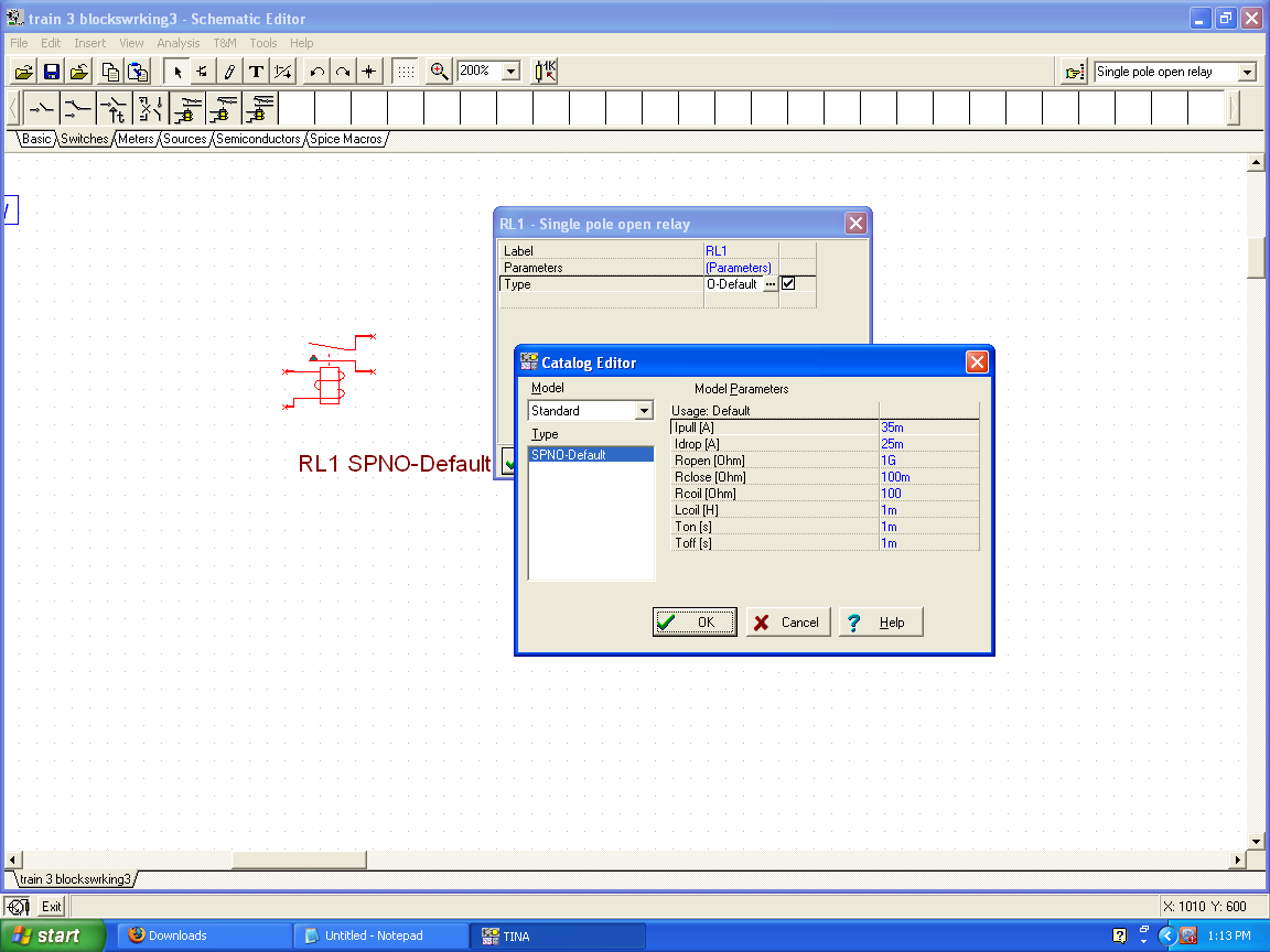

relay parmeters
no voltage designation?

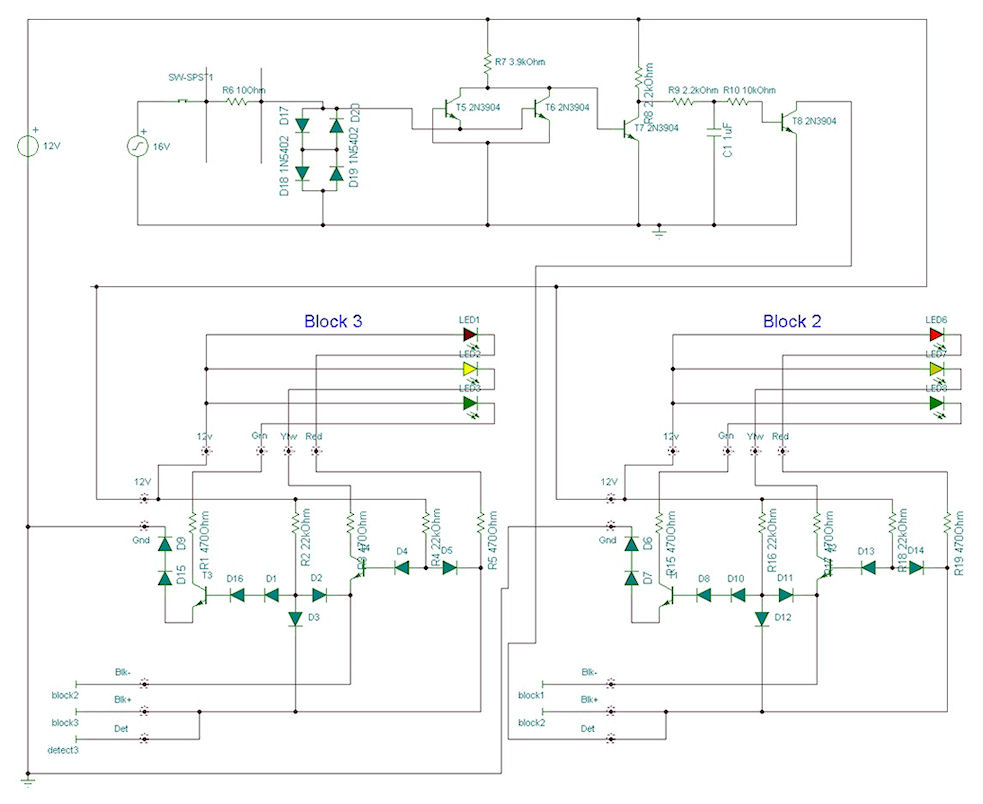

Yay!!!!!!!!!!! We have victory. :D
Added two signal diodes to green ground on each block.
Changed resistor R8 to 2.2K.
Works great with both locos and dry finger across rails.
Tried 10R resistor across rails. Worked but smoked :(
Have no idea what I was doing but it works. Now need to find out what power each wagons axle resistor has to be so it doesn't burn out and that's something else I don't know how to do. :)

Hi Angie,
Glad you have success. The two diodes in the emiters lifted them up to meet the cut off level at their bases.
To get the axle resistor value (1 per car, I guess) Put 10K across the track. If it works increase the resistance until it the circuit stops detecting. Reduce the value by 10% to give you some slop. That is the value that each car has to supply across the track.
To calculate the wattage use this. V²/R . If your DCC is 16 volts and your max resistance is 10K ohms V²/R = 16v×16v / 10000ohms. =1/40 watt
If the max resistance is 1K then V²/R would be ¼ watt.
I would also increase the signal LED resistances to 680 ohms. At 470 ohms you are putting about 24 Ma through each LED. That is 20% higher than the max rating of most LEDs. 680 ohms will reduce the current to about 15 Ma. That won't dim the LEDs much. My signal LEDS have a max rating of 20Ma. I run them at 7Ma with excellent results.

R8 is the yellow LED resistor. At 2.3K how does it even light? unless we are talking about two different resistors.
my last post I failed o change the relay coil resistance. the posted pic was the default relay. sorry for false posting.
glad to hear you got it working.
post a finalized schematic. Oh yea we still have the relay issue to deal with.
look at the reed relay I linked to from Rapid electronics.
The 5v = .62p and the 12v are .72p
you could go with either one as the max voltage is really a wide swing.
