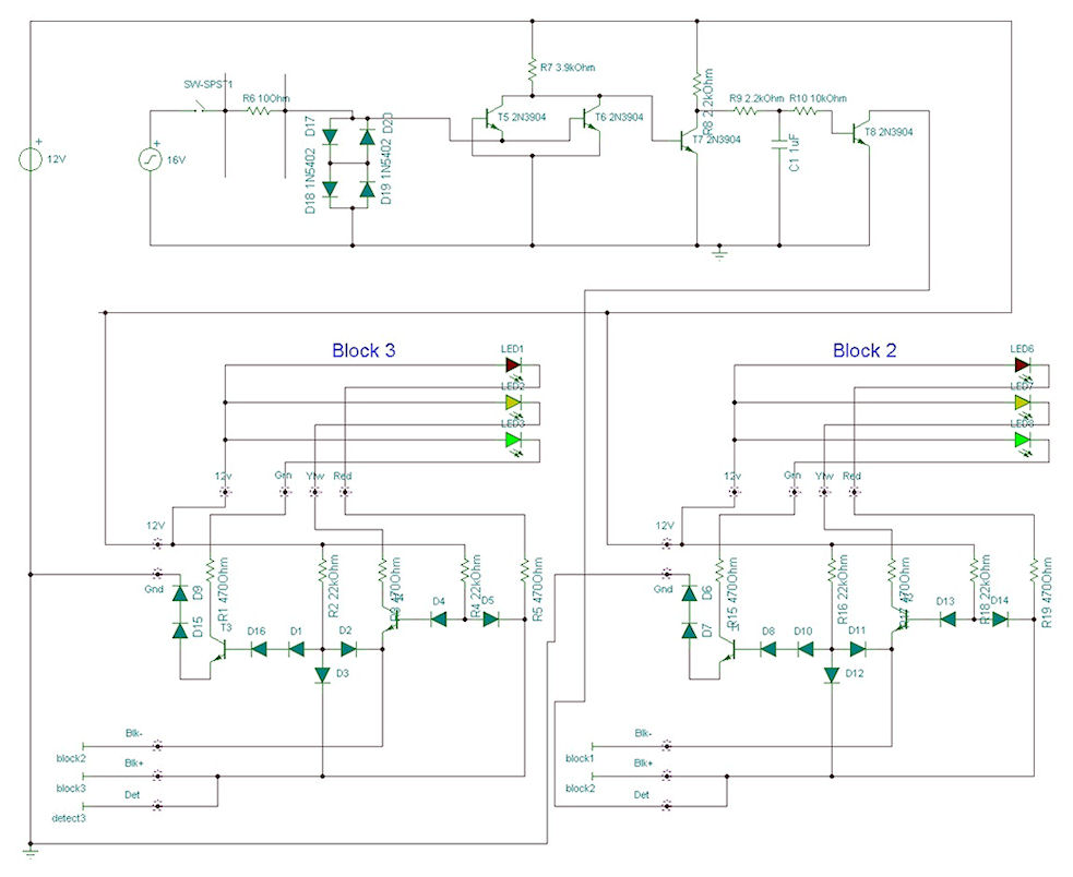

R8 is the yellow LED resistor. At 2.3K how does it even light? unless we are talking about two different resistors.

I was going by my latest schematic (https://www.electro-tech-online.com/attachments/detector13a-jpg.36708/)
Not going to use a relay now as the circuit is working with transistors and resistors only.

I've increased LED resistors to 628R and yes, they didn't reduce in brightness noticeably. They are 2V - 2.2V (max 2.5V) with max current of 25mA, typical of 20mA.
Are you sure it's not 47K instead of 470K. 47K is very good. 470K may give you problems on a damp day. ¼ watt on track resistors should be OK.

Yep, both signalling and detect circuits work.
One detector and signalling per board.

angies schematic
look this over.
I have 600 ohm for leds as the 470s were to small

Yep, I changed them to 628R as suggested by Pete.
I did find that if 12V ground and DCC ground are not connected the circuit doesn't work so there has to be some connection between the two.

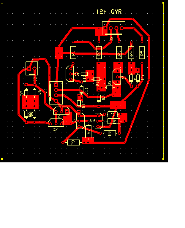

proposed pc board
if you have express pcb then I could Email you the files (schematic and pc board).
then just print out on glossy photo paper using a laser printer.
iron on and hopefully all transfers. A copy machine I think would work to but?
you might get some distortion but layout has nothing real critical.
second option = I will mail you a sheet or 2 of Pulsar paper with pattern printed on it. You iron and etch.
option 3 contact express pcb and see how much for 25 30 boards.
you might be surprised on cost.
or contact a board company in UK. with PDF in hand they might be able to do it for you.

alot of drilling, 1100+ holes

what is this signal driver?
the board I posted has the detection circuit and the 3 led signal circuit.
the strip board idea is a lot simpler than the design I posted. I like the simplicity for ease of construction. Never tried the press and peel but have seen posts using and the pros and cons of using..
I understand that Pulsar is selling their product in the UK at a reasonable price.
I could have made the board design smaller but Angi is a newbi at this so I used wide traces. Looking at your strip board design, it might be easier for her but ??
