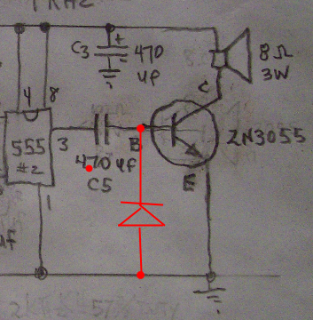

Remove the 100 ohm resistor between pin3 and the speaker. You can either replace it with a 1000uF capacitor or wire pin 3 directly to the speaker if you have a good old fashion NE555.
Driving a transistor like that usually does not work. Cap C5 will charge up and not do what you want.
Add a B-E diode. And reduce the size of the cap. (maybe much smaller) You might want a base resistor also.

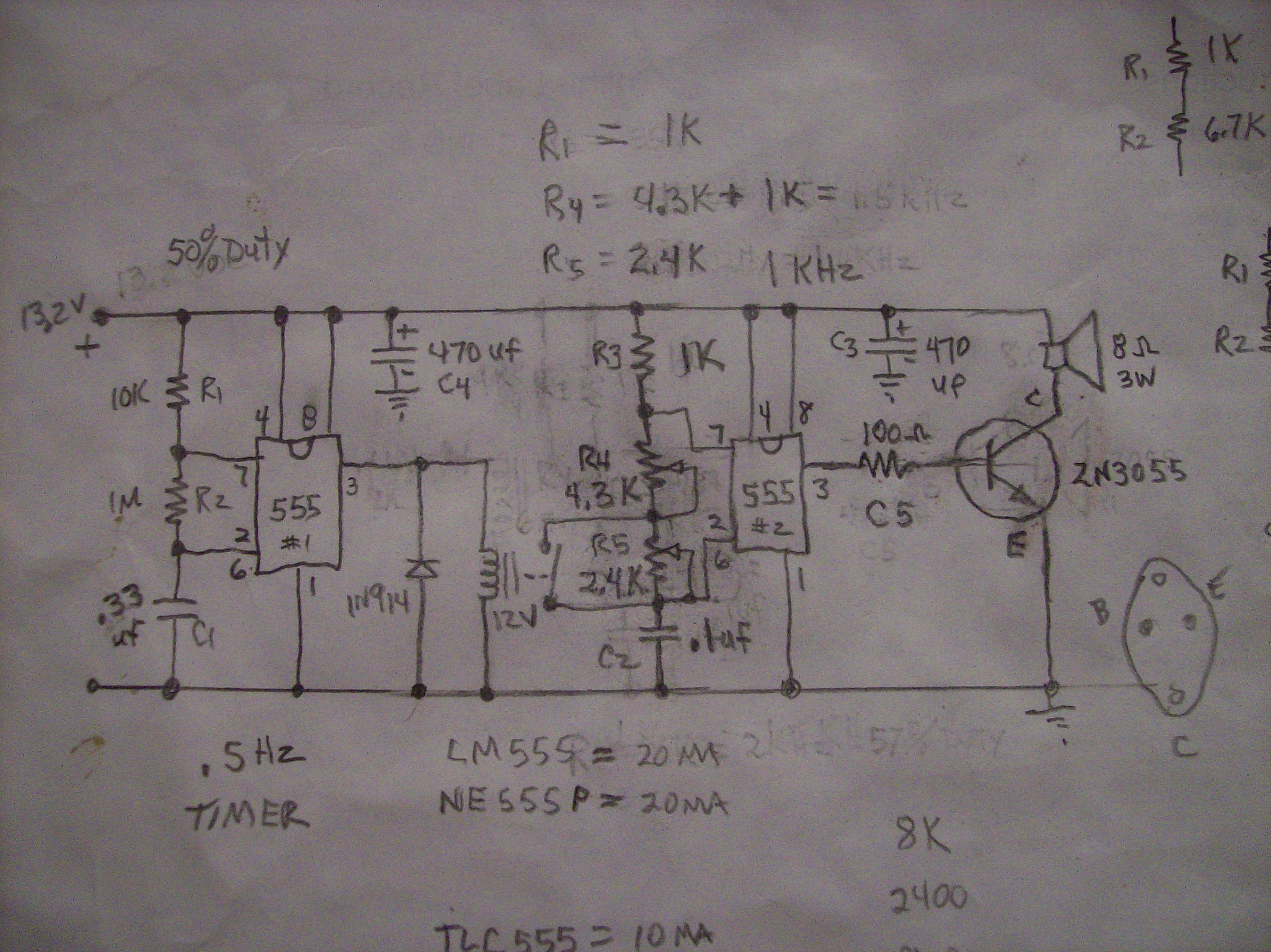

Why did you add a capacitor between the 555 and the 2N3055? Then the 555 #2 and the 2N3055 will not work properly. A capacitor is used if the output of the amplifier is push-pull and there is a single polarity supply (the 2N3055 is not push-pull). Also the capacitor you added might have destroyed the output of 555 #2. Maybe you did this before and that is why 555 #2 does not work properly?
Since your 555 #2 was marked "AC NE555" and it could not drive the 100 ohms resistor in series with an 8 ohms speaker then I suspect it is not a good or normal 555. Swap 555 #1 and 555 #2. If the 555 #2 cannot activate the relay then it is bad.
An NE555 can easily produce 10.5V into the 100 ohms in series with the base of the 2N3055 to produce a base current of 103mA. Then the 2N3055 can produce a collector current of 1A to 1.6A in the speaker. The AC power in the speaker will be 4W to 10.3W which will blow up your little speaker.

I have a 10" 20w 8 ohm speaker waiting to be used. Actually I have 2 10" 20w 8 ohm speakers i can use. I tried what your said it did not work. I tried smaller resistors to and no resistor. Only thing I did not try is .1 uf which is what I would have tried if no one had made suggestions. If a 2N3055 will make 10w I want to see it happen.
Post #31 shows the 555 driving a 39 ohms resistor in series with an 8 ohm speaker to ground. Then the output of the 555 is overloaded when it goes high and it is not loaded when its output goes low (it Is Push-Pull unlike a single 2N3055!).
In post #32 I recommended adding a coupling capacitor between the 555 and the resistor in series with the speaker. Then with a series coupling capacitor like with every push-pull amplifier that uses a single supply, its output current is balanced going high and going low.
Lower resistor values will simply destroy the output of the 555.

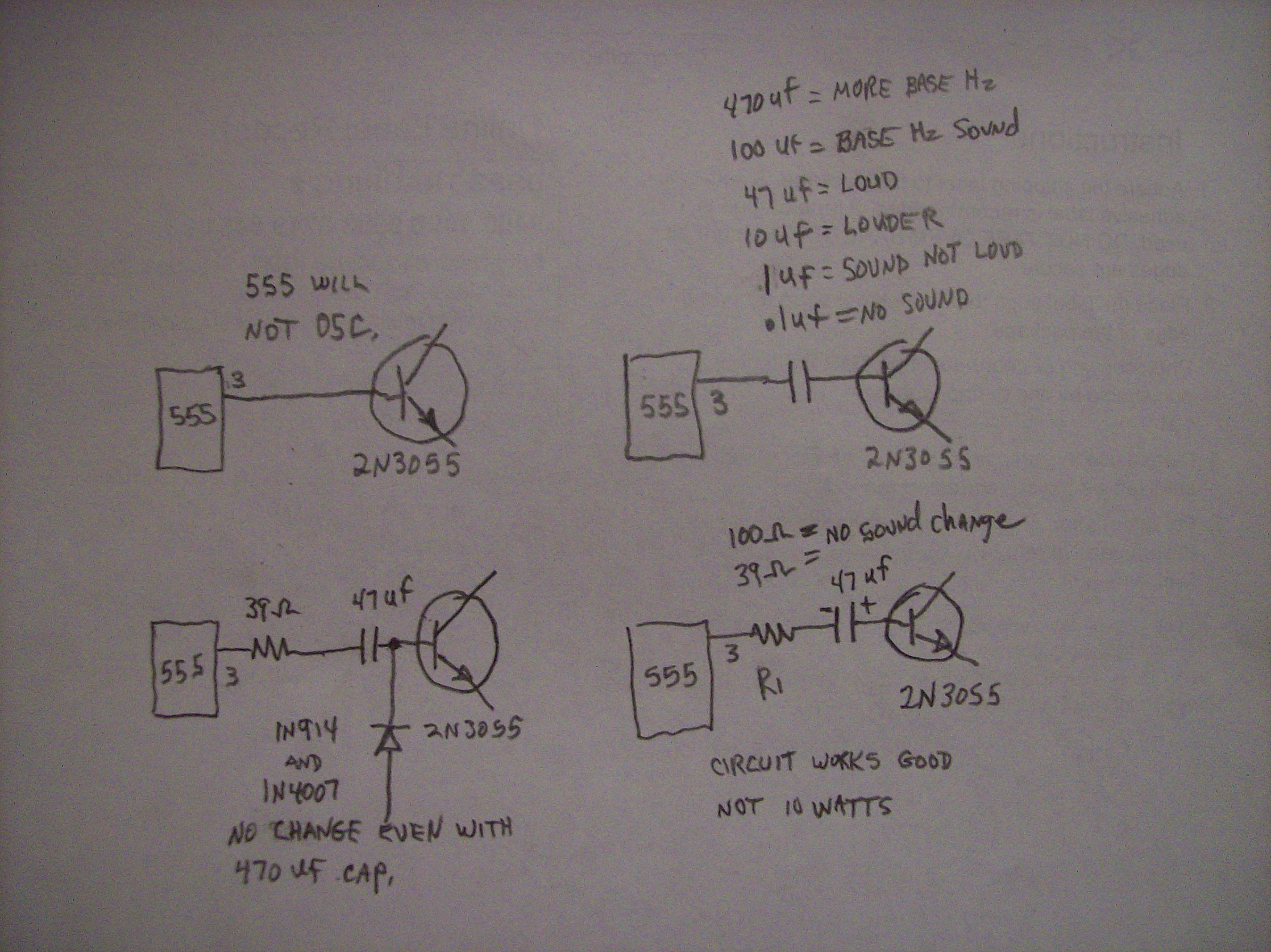

This morning I did some experiments for my own learning experience. See drawing. 47uf sounds best. 39 ohms prevents 555 from getting hot. Diode seems to do nothing. I looked online for push pull circuits only one that uses two 2N3055s requires 2 transformers. Push pull with no transformers required 1 NPN and 1 PNP transistor. There must be a PNP = to 2N3055 I have no clue what is it.
I replaced 2N3055 with 2N3904 sound is only slightly less.

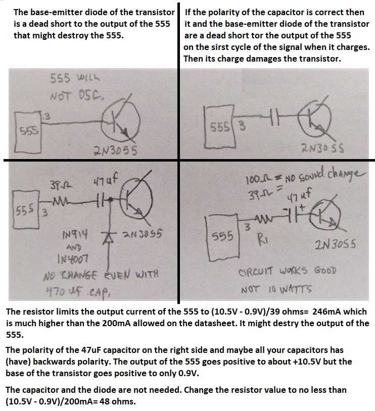

Gary, you seem to be making random circuits that are usually wrong. Instead, you should learn the basics of the electronics parts you are using.
1) Your 39 ohms is overloading the output of the 555.
2) Your capacitor polarity is (are) backwards which causes it to act like a piece of wire. If the polarity is corrected then it charges then discharges negatively into the base of the transistor damaging the transistor (that is why others added a diode).

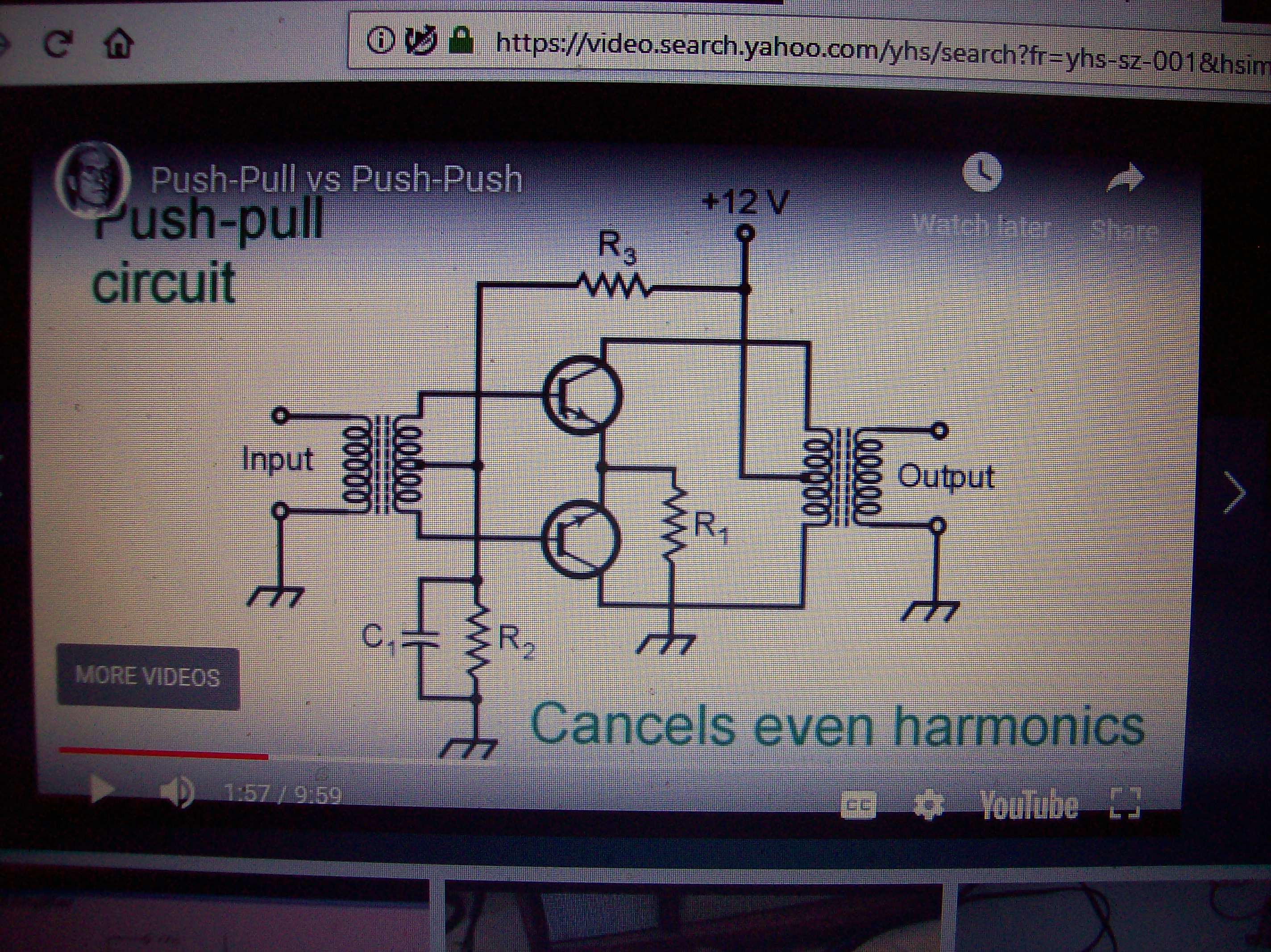

You showed a push-pull amplifier that must be 59 years old. Transistor amplifiers have not used audio transformers for at least 50 years.

2N3055 needs no heat sink at all. If output could be higher than 1w it might need a heat sink. Connected to 100a car battery 2N3055 still does only 1w.
The With a 13.2V supply, the datasheet of the NE555 shows its output high with a 100mA load is +11.5V. Yours is overloaded to only +6.22V which might be the average voltage of its AC. The datasheet of the 2N3055 shows that its base is about +0.8V.
The un-needed coupling capacitor is between them. Which end of the coupling capacitor is more positive? the +11.5V end of course.
With the capacitor polarity corrected, when power is applied the capacitor charges immediately causing a POP. But there is nothing to discharge the capacitor so there is no sound after the POP.
Adding the diode allows the capacitor to discharge into it during each half cycle so there will be sound. But the capacitor and diode are not needed.
If the capacitors are good with very low resistance then changing the capacitance of the coupling capacitor should not change the sound, it should only change the output level because your squarewaves have no bass.

I decided to do all the things you said and take notes.
With 47uf cap connected from pin 3 of 555 to B of 2N3055 + on B circuit works. Turn cap around with - on B circuit works but volume is 99% lower. I have to listen close to hear it osc.
Add the 100 ohm resistor with cap still connected - to B no change circuit works volume is so low it is hard to hear.
With 100 ohm resistor and 47uf cap in series + on B circuit works good.
Remove 47uf cap leave the 100 ohm resistor between pin 3 and B volume has gone up very noticeable louder. 1w is now 1.1w of sound.
Remove 100 ohm resistor pin 3 connected directly to B, 555 is stuck on 1KHz it will not osc.
Put 100 ohm resistor between pin 3 and B again circuit works good, louder than before about 1.1w.
Looks like output of 555 needs to be stronger to get more power from 2N3055.
Of course, the backwards polarity is a piece of wire that works but the correct polarity capacitor charges quickly on the first positive half-cycle of the audio then has nothing to discharge it from then on.
Because the backwards capacitor is a piece of wire.
Because that is how the circuit should be without a capacitor.
volume has gone up very noticeable louder, 1w is now 1.1w of sound.
No. Twice the power sounds only a little louder. 10 times the power sounds twice as loud. The power went from 0.5W to 5W.
Because the output of the 555 is severely overloaded.
No. When the supply is only 13.2V and the speaker is 8 ohms then a perfect output transistor fed with enough base current will produce an output of (13.2V squared)/8 ohms= 21.8W for half the time which is 10.9W. Like all transistors, the 2N3055 has a small saturation voltage loss so when the 555 provides it with a base current of 160mA through a 62 ohms resistor then the power in the 8 ohm speaker is 20.5W for half the time= 10.2W.
More power? Then double the supply voltage and double the base current and the power in the speaker will be 35.7W. Or use a 4 ohm speaker and double the base current and the power in the speaker will be about 18W. Double the supply voltage AND use a 4 ohm speaker with much more base current then the power will be massive.
The power numbers I mentioned are with half the power in the distortion harmonics since the waveform is a squarewave. The speaker and your hearing might not sense the harmonics then you hear only half the power.
