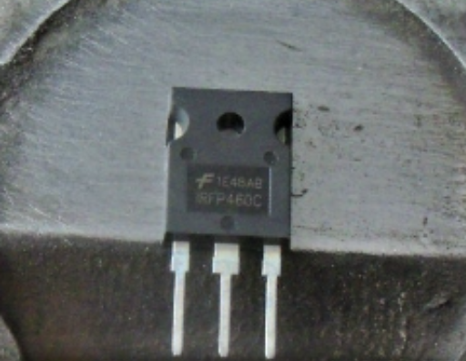

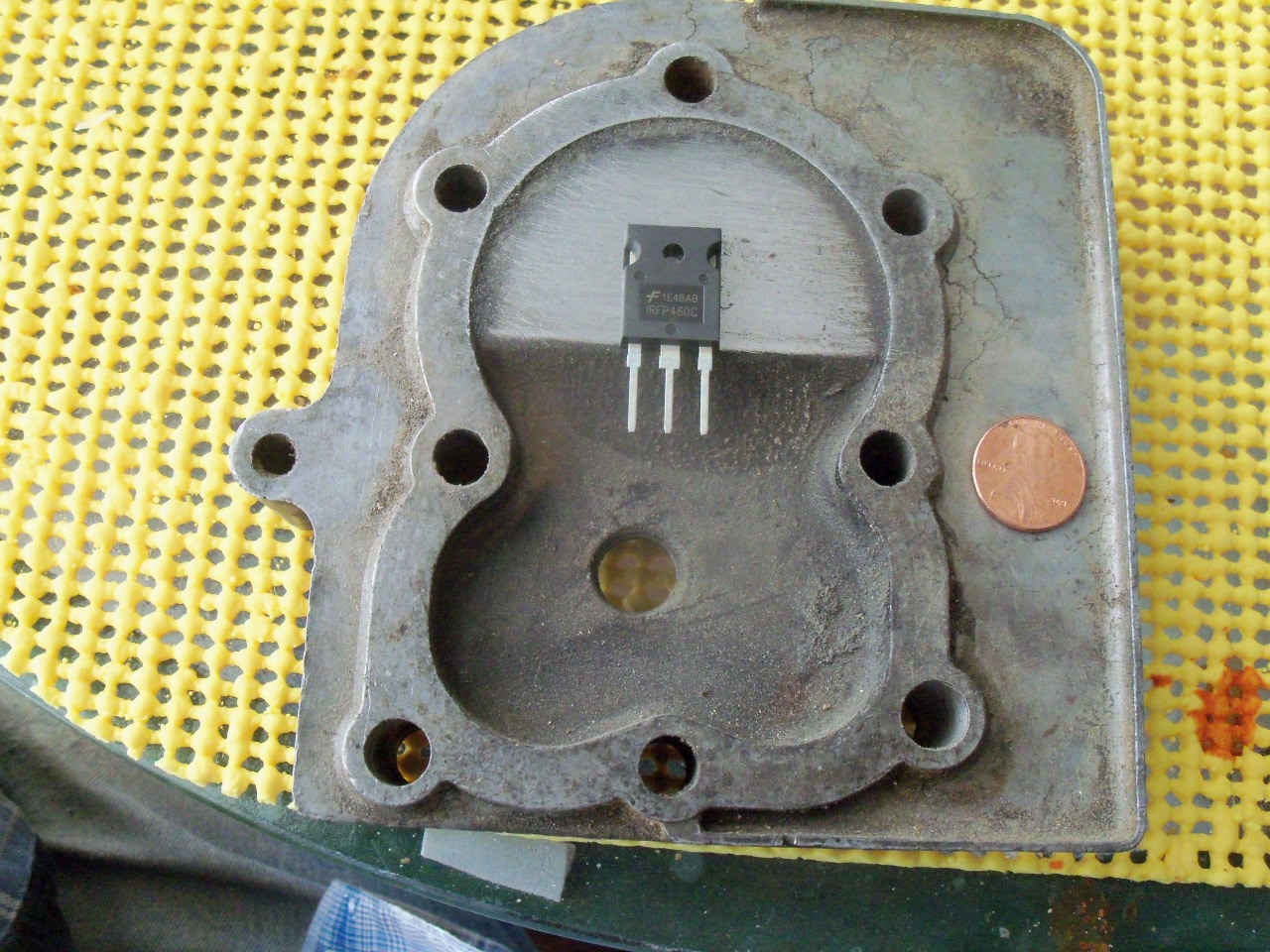

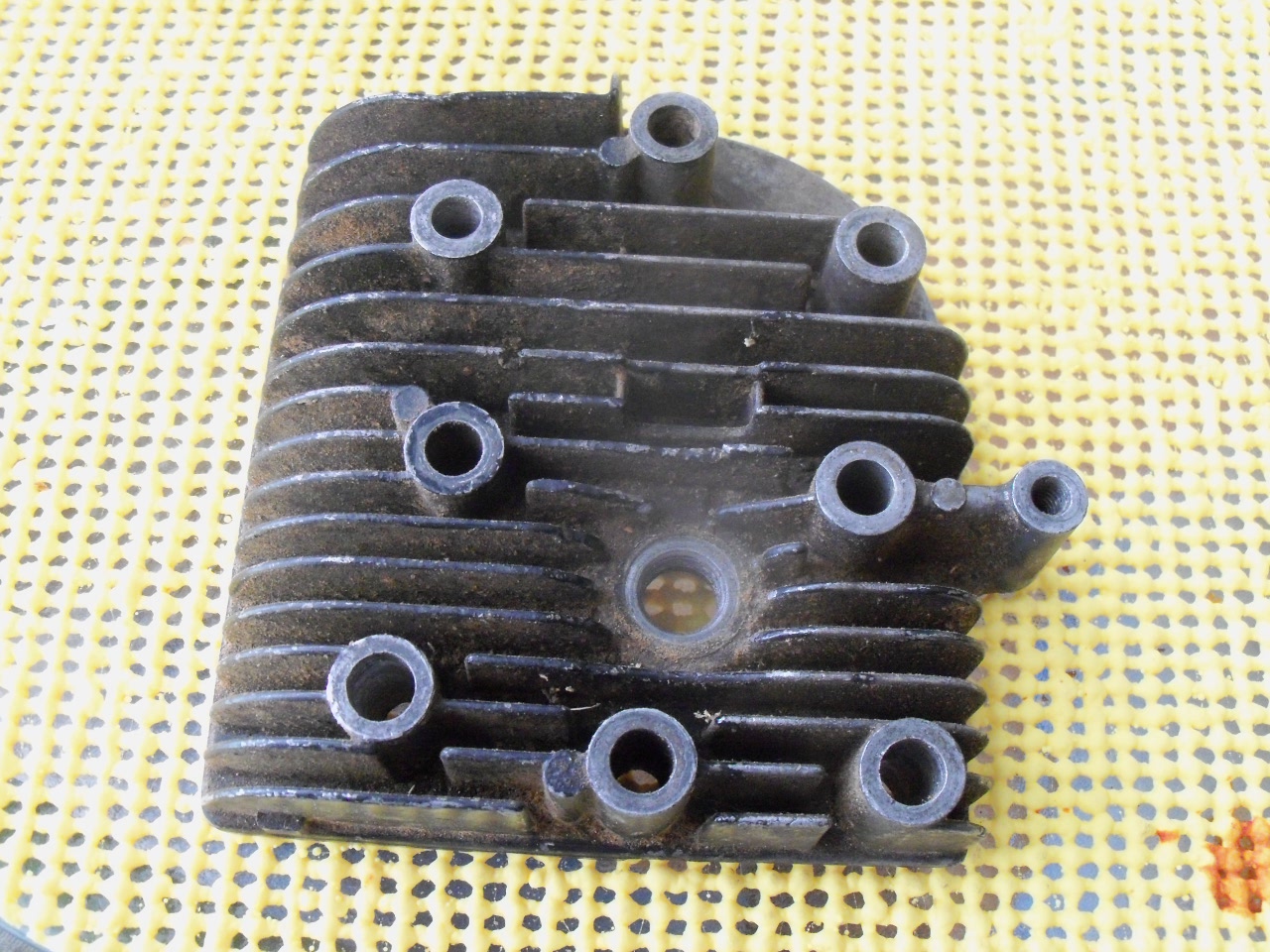

Lawn mower aluminum engine heads make excellent heat sinks $1 each at scrap metal yard costs much less than new heat sinks. All I need to do is drill and tap a screw hole. They even have several mounting holes. This IRFP460C mosfet will stay very cool. It beats paying crazy prices for electronic heat sinks.
Excellent tip!
I bet this “heatsink” is good for a couple hundred watts with some airflow.
It could be used in a steampunk amplifier. You could even add a spark plug for decorative purposes.
I wonder how much surface roughness there is and how that impacts Rjc.
Thermal compound is not good enough to allow enough heat transfer with those deep scratches and dirt.
