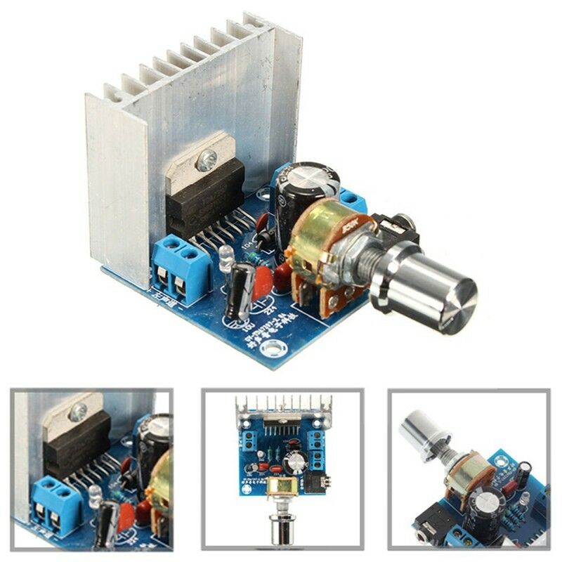

I bought a TDA7291 duel output 15w per channel audio amp operates on 12vdc, on a PC board already built for $2.95 free shipping from China, all I have to do is put my 555 output into the 15w amp input, connect my 2 speakers, connect 13.2v car battery. I can't build my own this cheap. I can found out if it works. This might be someones Christmas gift in about 6 more months. Or it could be something else. Once I connected a mercury switch to my cousins vehicle horn every time he put on the brake to slow down at a traffic red light mercury went forward and his horn blasted the person he was stopping behind. LOL. I had it connected with alligator clips he pulled over did a search and unhooked it. LOL Next day we both had a good laugh about it. :)

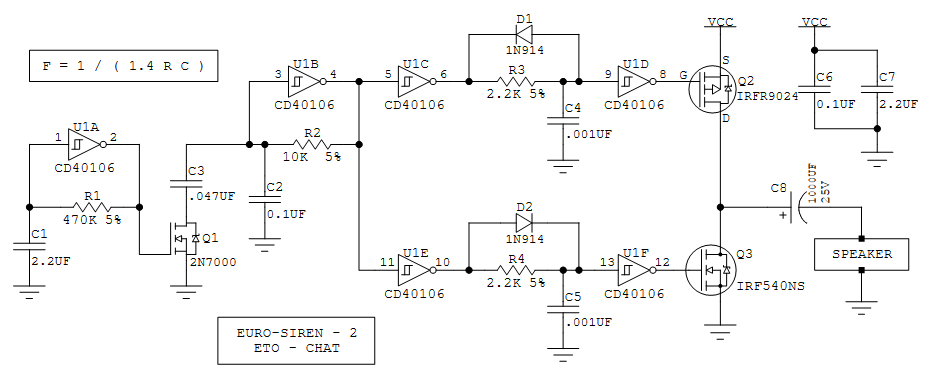

Just for grins, here is another circuit for a European-style siren. One CMOS hex inverter handles both oscillators plus output transistor drive.
U1A and B are the same functions as the two 555's in previous circuits, with a switched timing capacitor as in post #111. The exact frequency is a bit harder to predict because the two Schmitt trigger transition levels are not as tightly specified and controlled as in a 555; the equation is approximate.
U1C and E drive short, asymmetrical delay networks to prevent cross-conduction (shoot-through) currents in the output transistors. U1D and F square up the resulting delayed edges for fast turn-on and turn-off of the output transistors.
I went with power MOSFETs. but bipolar darlington transistors can be substituted with appropriate base resistors. The output transistors are acting as saturated switches for the greatest possible output volume. The schematic shows part numbers in my design library, but any appropriately-rated transistors (30 V, 5 A min.) will work.
ak
With a 13.2V supply, the Euro-Siren circuit will produce 5.5W into 8 ohms, 11W into 4 ohms or 21W into 2 ohms of buzzing. The fundamental 1kHz and 1.5kHz will be at half those powers. The Mosfets will not need heatsinks.

For those frequencies:
Change C2 to 0.047 uF (47 nF) > 1519 Hz
Change C3 to 0.022 uF (22 nF) > 1035 Hz

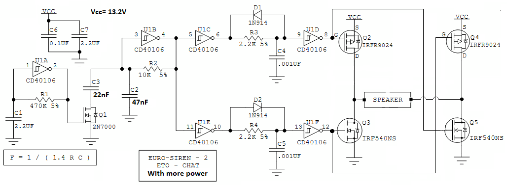

AnalogKid, I played with your circuit to get gobs more power: 20W into 8 ohms or 38W into 4 ohms. 72W into 2 ohms?
