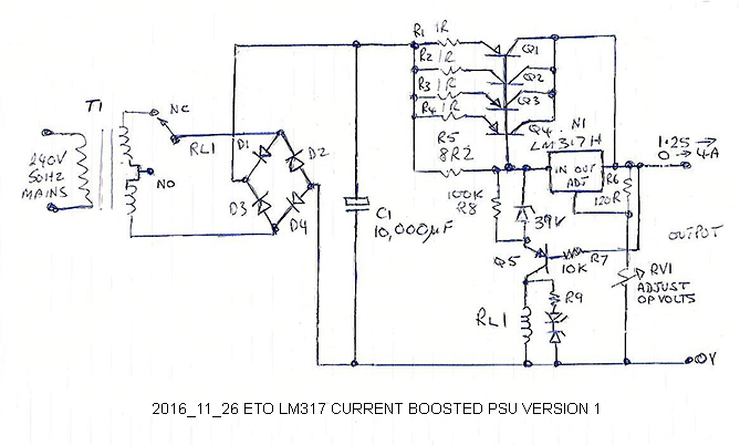

Now that i know that you are going for an LM317H as the control element in your PSU, I have knocked out the skeleton schematic below to illustrate the classic current boost circuit for an LM317. Also shown is automatic input voltage switching, which you asked about.
The LM317 has both over-current and over temperature protection, so the overall PSU would have these features.
The bad news is that the circuit needs PNP power transistors rather than NPN which you have.
By the way, if you plan to buy some PNP power transistors please let me know and I will give you the part number for an optimum device.

I initially went down the LM317 route and read the data sheet, then found the LM338 at 5A data sheet and then realised they would both melt. It was then the 2N got added. Then that's not what the data sheet says it is (in the real world) and I got to 4 x 2N. I then needed a 60V regulator as neither the LM317 or LM338 were any good at 60V. Then I found the LM317AHVT.
That's where you came in spec.
The LM317 HVT is 60V and has the same properties as the standard LM317 apart from the higher V, is that relevant ? I take it I can use it in your circuit ? I have a couple of LM317 and 3 LM338's
You do realise you have just made a rod for your own back spec. I really do appreciate it very much but I feel I'm asking an awful lot - even from the ARC Angel.
If you are OK with that I'll go for it. I can use the 2N's for the little 4A 20V (Even that's 80W). The 4A 22V is just a 'something to do'. I understand 2N's can make quite a Joule thief ? I got the first 2N for that.
There are a few items that I might need help with.
What's :
RL1
Q5 Is the schottky near 39V used as a Volt limiter ?
And as you say Q1 through Q4. (Nasty American things - LOL)
I take it that's a 1.2V to 4a (3 + A) output

What's :
[1] RL1
[2] Q5 Is the schottky near 39V used as a Volt limiter ?
[3] And as you say Q1 through Q4. (Nasty American things - LOL)
[4] I take it that's a 1.2V to 4a (3 + A) output
[5] Why 2 schottky diodes 'snogging' under R9
[6] I see they still need the emitter resistor, same reason no doubt.
[1] RL1 is a single-pole, two-way relay: a 12V automotive type would suit- they are cheap and freely available.
[2] No, it is a 39V Zener diode, and is the voltage reference that tells Q5 when to energize the relay to reduce the voltage drop across the power transistors and TTR.
[3] The US nomenclature is much better because it is shorter (VT= Q, IC= N etc). You are talking to an Americanophile here- if it wasn't for the Yanks, the UK would be in a sorry state, in my opinion that is.:happy:
[4] I was a bit sloppy and just wrote 4A as opposed to 3A+. The output voltage will be 1.25V to whatever maximum voltage the circuit will do, probably about 42V. I have not worked it out. Without a bit of extra circuitry the LM317 family of TTRs cannot go any lower than their internal voltage reference, which is nominally 1.25V.
[5] They are Zener diodes (just one bent end on the symbol). Along with the resistor, they form a snubber to absorb the back EMF (voltage) from the relay coil (inductor) when the relay turns off. This not only protects the relay coil but also the transistor controlling the relay coil.
[6] Yes, the emitter resistors are for current sharing between the power transistors, as previously discussed. But the emitter resistors also have another function in the circuit of post #40. Consider the four parallel power transistors as just one big power transistor (which functionally is what they are). It is important to get the current ratio between the TTR and the power transitors right, so that the TTR, current limiting and over-temperature protection works for the power supply supply as a whole. That is why the emitter resistors are a higher resistance than would be needed just for current sharing alone. I expect the emitter resistor value to increase even more when the detailed analysis is done.

I just saw a tiny light at the end of the tunnel, only very tiny mind you. May I use the word 'trying' here - good. Basically you are just trying to make one BIG LM317.
I can guess what a TTR is (I think it's the LM317) but if you could possibly use the full title just once it might save me thinking it's short for - Through The Rhubarb.
I have read that if you want 0V just add a couple of diodes on the end. Probably wrong of course. The minimum I will need will probably be the 2V for a red LED. That sounds silly I know but it's a fact.
Sorry but I think I had better find out what these circuit symbols mean. I was OK for resistors, plain diodes and simple stuff like that but once you start adding 'wiggly bits' I'm lost.
I do apologise for using technical terms like 'wiggly bits'.

Hi again, again John,
Below is an outline schematic, for your consideration, of a classic bench power supply with the addition of a negative voltage rail, which acts as a voltage reference and also allows the PSU output voltage to be adjusted down to a true 0V. This approach has other advantages too.
The symbol with two interlinking circles is a constant current generator, which comprises either a single constant current diode, or some other circuitry.
The PSU also has output current control which can be adjusted.
I suggest that this approach may be a good choice for your bench PSU.:)

In parallel with the mechanical design and construction, we can thrash out a suitable circuit to do the job.

I have just seen your latest circuit. I wanted variable Amps but didn't like to ask for it. Everything I have seen before has been either very good at starting fires or 'core look at all them bits'.
I think I can get my head around your circuit. I know I can.

I have just had another look at your circuit. I was fine until I saw the words 'negative regulator'. I'll get there don't worry. I'll concentrate my thoughts on the hardware and get them back to you.

If you could possibly add a few 'for example' names to the components it might help me look that type up and understand a bit more. I understand everything is up in the air - just a rough idea might help.
