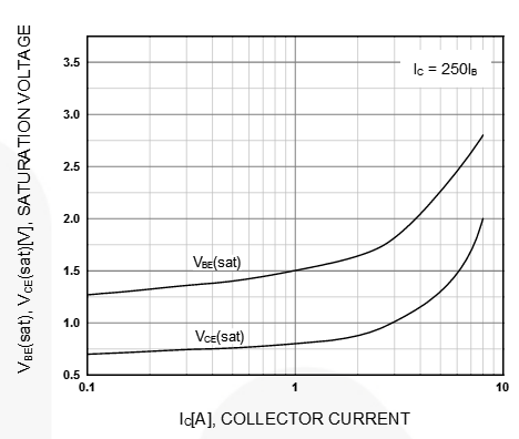

The collector-emitter voltage across a Darlington transistor is always more than 1.4v
From data sheet. Vce =

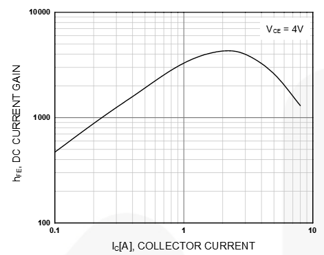

and may have a higher gain than the 2N2222
We don't know the current. Because both transistors are to do the same job (replacement) then I will assume low current. The graph for the TIP120 shows a gain of 475 at 100mA. At lower current, lower gain. This part was designed to run at 2A.
The 2N2222A has a gain that peaks at 150mA in the range of 100 to 300. You are right about gain. I wanted to show that when you use a large transistor out side of it intended range it does not work well. (even a Darlington)

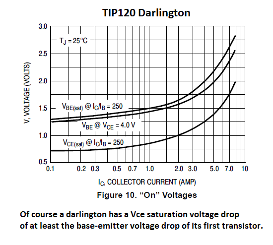

Why argue about it when the datasheet shows the saturation voltage drop?
