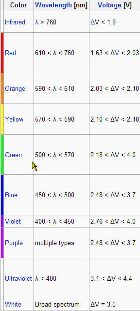

Thats good.
Look at this image for reference.
Eric--have you got a link for that LED reference (so I can get the text)? Very useful info there.
