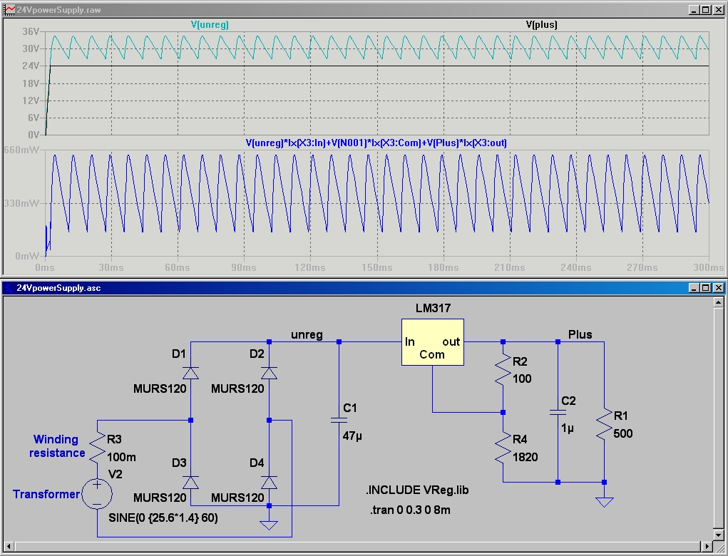

Mike I did the math and a full wave bridge will give you a little over 35volts dc from a 25.6 volt ac transformer if he size a capacitor the right size to filter it out before his LM317 then set it with a pot to the 24 volts he will be good to go
Close to 33 with a 50mA load and a 47uF filter cap. See V(unreg). The complicated expression plotted in the lower plot pane is the power dissipated in the LM317. If the O.P. forgot to put a large heatsink on the 317, it is going into thermal shutdown, and that is why the voltage is low...
It is only the difference between the input voltage and the output voltage multiplied by the current, that creates the wattage lost in the regulator. That's why a regulator can output a high current when the output voltage is high, but must be de-rated when the output voltage is LOW.

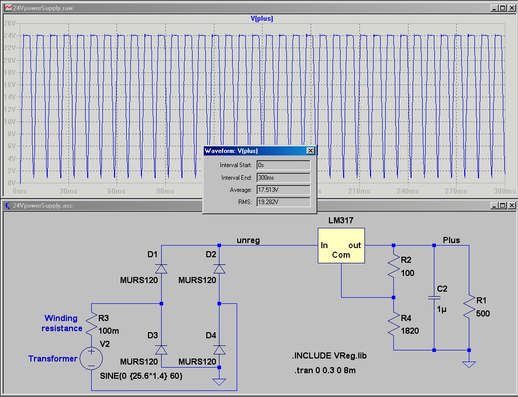

I suspect that PhillDubya doesn't have a filter capacitor after the rectifier at all. :rolleyes:
I reran the sim without the filter cap, and look what the average voltage is :D

I am a noob. Yes, I forgot the filter cap. After putting a 47uF filter cap, I am now getting roughly 23.7v which is what I need.
