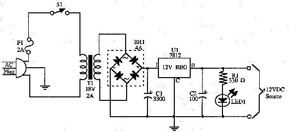

I had built a simple 24VAC to 12VDC converter a few years back, I got the schematic from this circuit.
I of course used only a 24 VAC power supply from a HVAC transformer for this circuit. I built it for my brother who got a free Mitsubishi AC unit, but the control voltage used 12VDC instead of 24VAC so instead of changing everything I made this simple circuit installed in a small plastic box with 2 wires coming out each end, 24vac power in and 12vdc power out. whenever there was a call for cooling, the tsat would send the 24vac to the outdoor unit, hit my circuit and was now 12vdc so it could run the unit. Still working for the last 4-5 years. I omitted the led light and resistor for it.
That should work for you!

Am i correct in assuming that since I already have a 24 VAC line, i dont need to include the transformer?
as far as buying components goes, if i took this to radioshack, or frys electornics, the component numbers (BR1 4A, U1 7812) are unique and would be simple to acquire?
You dont need to include the transformer if
Usecondary(of Yours 24VAC transformer) * 1.44(voltage multiplier in full bridge + 3300uF capacitor schematic) <= 35V (Umax input voltage for 7812)
component number for U1 7812 is unique , small differences for every manufacturer.
From data sheet : With adequate heatsinking it can deliver output currents in excess of 1.0 A.
But BR1 4A , I thinks is max output current equal 4Amps for this bridge rectifier.
