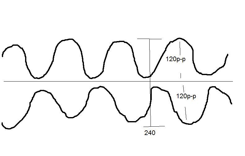

My mentor years ago drew a sinewave like the following for me when he taught me about 240. Honestly, I never saw it on a scope, just took his word for it and never saw anything to the contrary. Again, I don't fool with anything inside of walls, never have.
Pardon the crude quick sketch.

I was doing a mental excercise with my voltmeter, measuring from hot to hot on a 240 circuit and seing 240 on the meter. In my mind, I'm looking at two in-phase hot wires going up and down together. At any point between the 2, the voltage would be 120 volts.
But then I thought, my meter doesn't work that way, it is a true RMS meter, thats the key, right?
Because to get 120 volts on an AC RMS meter, at time x, the peak is 60 volts above neutral, and at time x+1, the valley is 60 volts below neutral. So, my drawing throws all of that off, because the meter can't see it as a sine wave.
This is a booger to get my mind around but I think I see.

If someone could draw what it looks like on a scope, it would clear it up for me. I could't find it on google.
Its very wierd, having thought incorrectly for all these years makes it hard to even picture this, but All About Circuits has a nice tutorial that makes sense of it. I never even realized that the transformer secondary outside my home was 240 and center tapped. I see it clearly now what is happening. Doh!!!
240 volt AC looks just like the sine wave of 120 VAC. It just has twice the amplitude.
