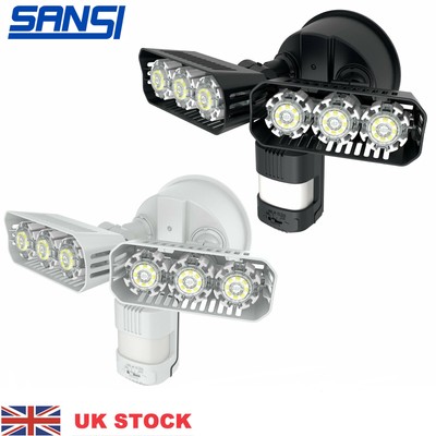

Those LED modules appear to mainly be used in "Sansi" brand lights, eg.
That's it, a friend had it and the chips were burning out one at a time after two years.
He was going to trash it so I wanted to see if I could save it.
I couldn't test it without soldering wires to it because of its blinding brightness.
FWIW The chips fail from excessive heat and poor heatsink interface
The heatsink is ceramic but the lens holder is plastic.
The designer must ensure adequate heatsink on Alum. PCB with convection air flow not above the neighbouring LEDs..
If both are not done, then the unit will fail at a rate of 50% faster every 10'C rise above 25'C from Arhennius effects. So if running at mx 125'C it will fail 1024 times faster than the generic 50kh rating.
5kh is only twice as long as old incandescent bulbs were designed for when used properly with convection air flow and would fail much faster in a sealed ball.
Obviously the designer did not heed the requirements of these LEDs to get "super-long lifespan", which I seriously doubt given the surface area of the sink/W is about 5% of the area needed .
Given that it is motion sensed, it was designed for very short operating life with inadequate air flow.
If you look at the Big Clive on YouTube, he often modifies LED lamps to lower power to give them longer lives.
Reducing the current is just increasing the <1 ohm current sensors I*R = Vref (constant)
