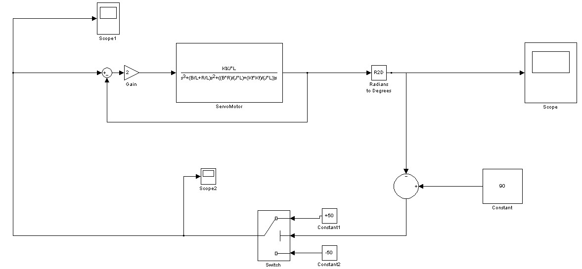

I'm working on this project which involves controlling a antenna with a 2 axis servo motor. Practical considerations aside(I still don't have the actual values like weight of antenna etc. will probably get them next week so I'll update then), I've decided to model it first using MATLAB.
Thing is, I'm not very good at it. Using simulink, I managed to model the motor transfer function, from which I got the direct output in terms of radians. I'm comparing this with a reference signal(Will have to modify this as the desired position will depend on the signal recieved from the antenna).
Then, from the error generated, I would like to use a PWM block to control the servo.
Now here's the problem. I have NO idea how to model a PWM in MATLAB6. So any help here would be much appreciated.

This is the (badly) designed circuit. I am getting oscillations and I know why.
The switch does not have a final "settled" position. I am unable to figure it out so any experienced MATLAB users please help!

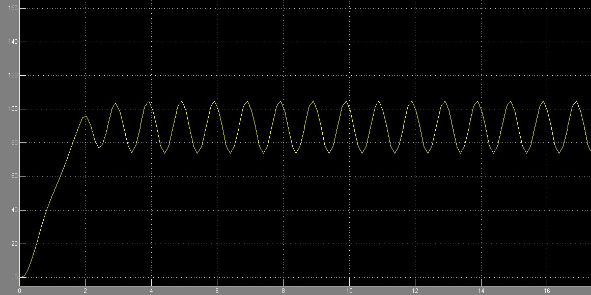

Fig1 is a picture of Scope output. It should be at 90 degree but it oscillates due to previously mentioned problem.

Just looking at the factors of the denominator, the partial fraction expansion seems to give a constant term, and also a quadratic term. Apparently, the quadratic term is the source of the oscillation. You might take a look at the components of the quadratic term, and see if by changing component values, you can generate real roots, as opposed to the imaginary pair... That is, without adversely changing anything else.
@User88
Well I can't change that block, it's actually the standard transfer function of a DC motor. I see what you mean though, but since I don't have the practical values yet, I wont tinker with it.
The main problem lies in the switch design. It works fine till 90 degree is reached, however I don't have the option to make it 0 volts at that point. Hence it rotates a little more till a negative error is reached and it switches to -50v and it rotates backwards.
Any idea how to modify the switch diagram?

It may be that all the circuit requires is a slightly greater damping coefficient... to reduce the oscillation amplitude.
... Not quite sure how to add damping to the oscillation, and nothing else though.
Let me rephrase that ... back up a step ....
The non-decaying oscillation is the characteristic that you would see when you have a classic double pole at zero. If this is in fact what you are seeing in your output plot, then to compensate, you will have to place an appropriate compensator in the control loop... I think that would be a lead compensator. The idea is to attract the root locus path to the left ... which is the stable quadrant of the plane. ...
If you can provide some data values, things might look a little more definite ... precipitate out.

Sorry if I am repeating myself, but the problem lies in the switch design.
The condition for switch is if U>0 then +50v is applied and if U<0 -50v is applied. Where U is error in degrees.
Hence I gave only 2 states either it moves forward or it moves backward. What I really need is a 3rd state i.e at say -2<U<2 the applied voltage is zero. I cant seem to find a block which specifies that.
