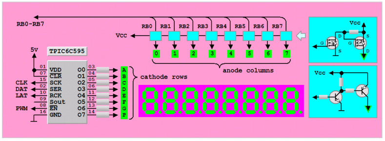

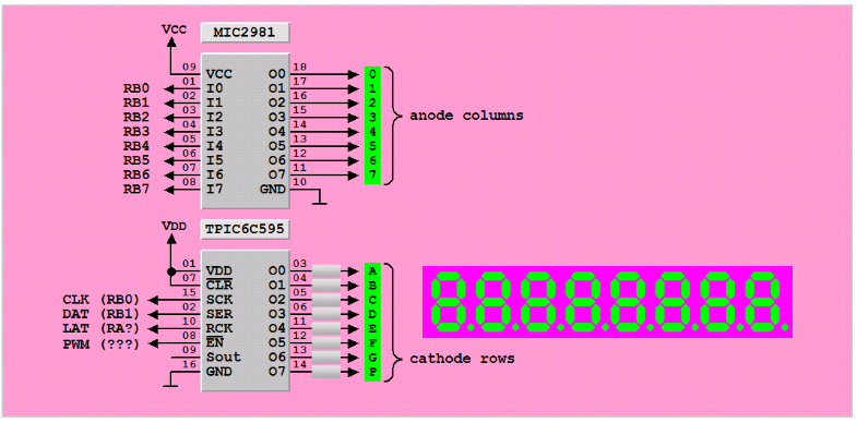

Ok on your plans to go to eight digits. If you ever want to consider multiplexing the displays let me and the Forum know and we'd be happy to help. I attached a couple 8 digit hardware examples that'll work with your 12 volt display voltage. Plenty of other ways to do it too.
Have fun. Regards, Mike
