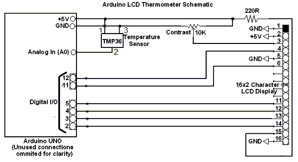

My first Arduino project - LCD Thermometer
Prototype
This project was my first as is about as simple as they get, but I thought I would share anyway. The code is made up of bits I stitched together, borrowed from other projects.
#include <LiquidCrystal.h> //import LCD library
LiquidCrystal lcd(12, 11, 5, 4, 3, 2); //define connections for lcd
const int sense = A0; //define analog input
void setup(){
Serial.begin(9600); //open a serial port
lcd.begin(16, 2); //define lcd size
lcd.setCursor(2,0);
lcd.print("Temperature:");
lcd.setCursor(6,1);
lcd.print("C");
lcd.setCursor(12,1);
lcd.print("F");
void loop(){
int senseVal = analogRead(sense); //read sensor value
float volt = (senseVal/1024.0)*5.0; //convert ADC reading to voltage
Serial.print("Temperature: ");
int tempC = (volt - .5)*100; //convert the voltage to temperature in degrees
int tempF = (tempC*9/5+32); //convert centigrade to farenheit
Serial.print(tempC);
Serial.print(" C, ");
Serial.print(tempF);
Serial.println(" F");
lcd.setCursor(3,1);
lcd.print(" "); //clears display for next reading
lcd.setCursor(3,1);
lcd.print(tempC);
lcd.setCursor(9,1);
lcd.print(" ");
lcd.setCursor(9,1);
lcd.print(tempF);
delay(1000); //wait 1 second between readings
Congratulations. Which temperature sensor are you using?
The only suggestion I would make is how you define the input pin,
This stores the value of A0 in program space. It is usually done with
#define sense A0
Note the lack of semi colon.

I'm using the TMP36, and thanks for the tip, I will give it a try when I can get Linux to play nicely with my Arduino.

You might find the lcd uses up too many pins as your projects exapnd, if so you can use either an I2C port expander chip or a cheap I2C adapter for the lcd, so only 2 lines needed, plenty of free libraries for it; also makes mounting the lcd in a project box a lot easier with just 4 wires.
On your programming problems, its often good to doodle a flow chart before you start the actual coding, helps spot any logic errors.
