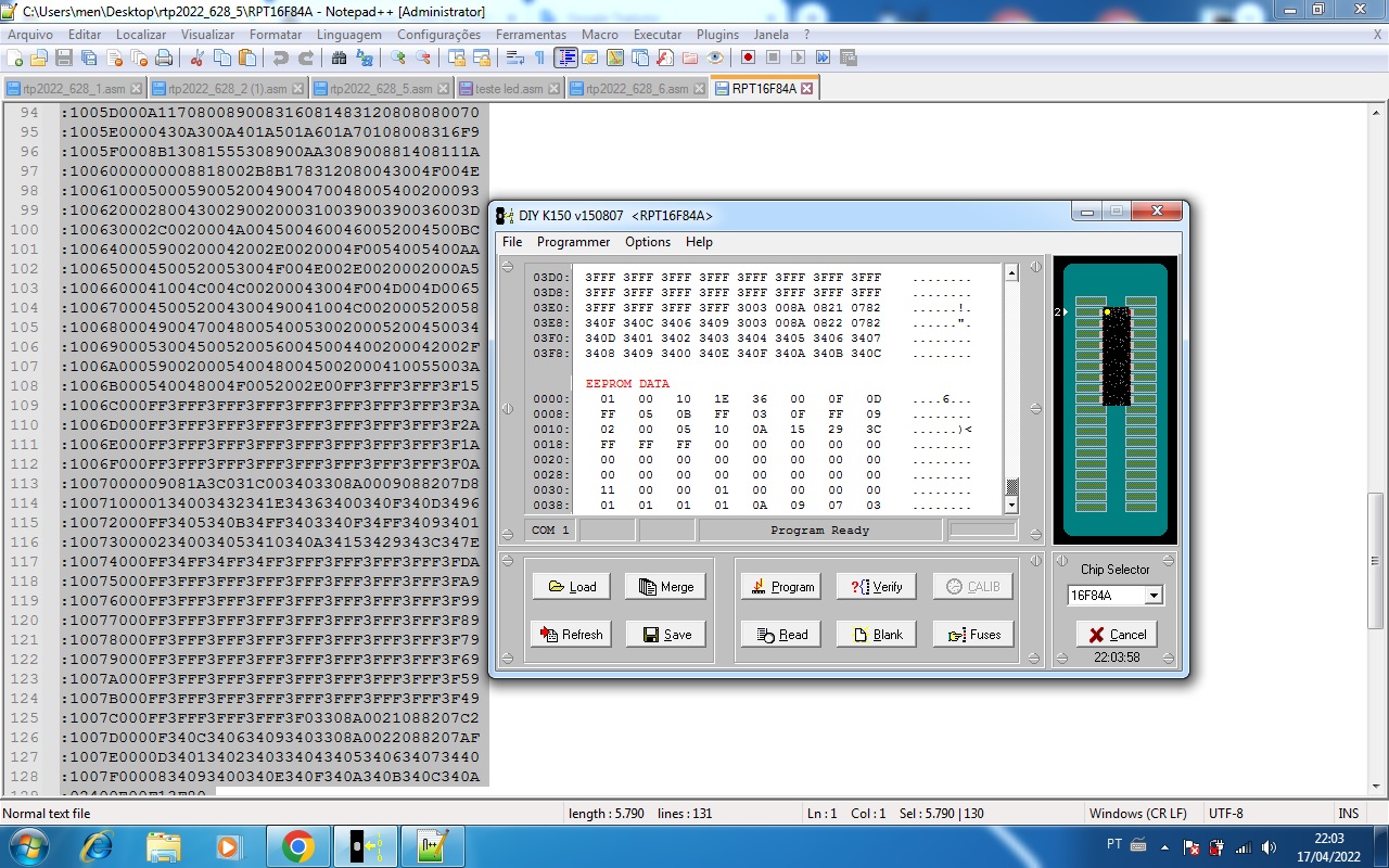

Neither of the two schematics match the code. Look at port B play and record - on B2 and B5 in the code. Doesn't match either schematic.
Edit, are we sure this is the right code for this board?
Terry good night, this is what I can read from the 16F84A that works on the repeater board.
The reassuring thing about that hex dump is the version number is the same,
:1000000031281B00FF3FFF3F8C008C0E030E8D003C
That is the same as d'27' and it comes straight after a goto instruction.
There seems to be very little EEPROM though.
Edit, missed the picture of the EEPROM dump.

Just adding 1 instruction would change a lot of the hex. As you say, pictures would be useful. Just finding where b2 & b5 go could be useful. Where did the source come from originally?
But not the whole file, there's only 5-6 lines that are the same, everything else is different.
The file we have been working with is as supplied by Jaison in the beginning and I have checked this against the file provided by QST (it's the same) and also I was able to track down the authors original website that again had the identical source file.
In the process, I also compared the hex file from the authors website and that produced by compiling Jaisons source file and they are identical.
In every schematic I have - the one from QST I posted and the REV A,D & E manuals I have here, they all go to the same place - RB2 to the ISD chip PLAYL line and RB5 to the ISD chips address select lines A6 & A4.
Where in the code did you see them go offf somewhere else? PORTB equates are set at near the top of the file and correspond (by labels) to above.
I just compared Jaisons hex file and the one compiled from the original source and apart from 15 odd lines or so they match.
I'm wondering if the software he's using is not pulling the full hex out of the chip?
