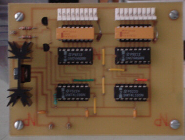

Here is one already built. I built it for external seconds display for a digital clock. It is a 0-59 counter that resets to 0. It was set up for seconds, but it will count form 0 to 59 and then reset. I have the schematic some displays and I can make it work on battery power. If you are interested send me a PM and we can work out the details.
Ned
