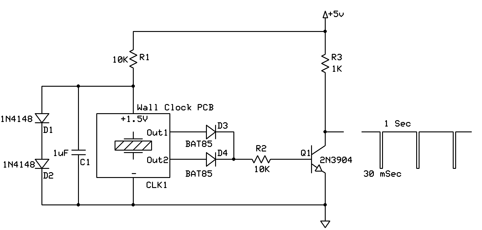

This is what I did with the battery clock circuit. Outputs 1 and 2 are the coil connections. The resistor , two diodes, and capacitor on the left form a 1.5V regulator to replace the battery. There are a lot of different versions of the circuit layout/board in the battery clocks, but all have two battery connections and two coil connections. The ones with alarms also have a two connections for the buzzer and two for the alarm switch. You can ignore these for your clock.

That will work but I think the base resistor needs reducing.
[latex]Ib = \frac{1.2-0.3-0.6}{10 \times 10^{-3}} = 30 \times 10^{-6}A \\
Ic = \frac {5}{1000} = 0.005A
[/latex]
With a collector current of 5mA and a base current of 30µA the forced beta will need to be 167.
The minimum gain of the 2N3904 is 100 at 10mA and will be less at 5mA.
https://www.electro-tech-online.com/custompdfs/2010/05/2N3904.pdf
I'd recommend reducing R2 to 4.7k or lower.
Woohoo! Works like a charm! :))) Thanks KM and Hero. I took your advice Hero and put a 4.7K on the collector. All's well :)
Quick question if that's ok, can I drive cmos counters with this circuit, or is the output too high? Sorry for all the mega "noob" questions!
Providing the circuit is run off the same power supply as the CMOS IC, there won't be a problem.
