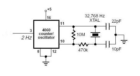

A 32Khz crystal along with a CD4060B or CD4020B 14-stage divider will give you a 0.5 second output. The 4060 includes an on-chip oscillator. 32Khz is a good choice for a portable timebase, very low power consumption, cheap & good accuracy.

Here is the circuit to get a 2Hz clock signal, using the 4060. You will need to add a divide-by-2 on the end to get 1Hz (eg, flip-flop).
