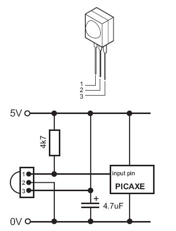

I have built driveway sensors with a 555 to modulate the IR led at 38khz and an opamp on the detector to set the trip point.
Now days i would use a picaxe chip on the detector end.
As from the picaxe manual see image below.

Here is a link to a data sheet on the type of IR detector used in the circuit above.
https://www.electro-tech-online.com/custompdfs/2011/07/tsop382.pdf

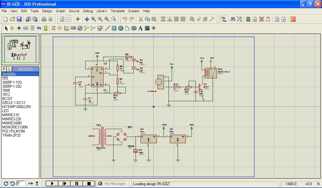

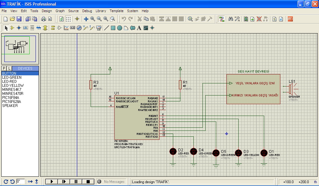

I made same circuit last year. I posted ır emitter dedector and traffic light with sound circuit.
