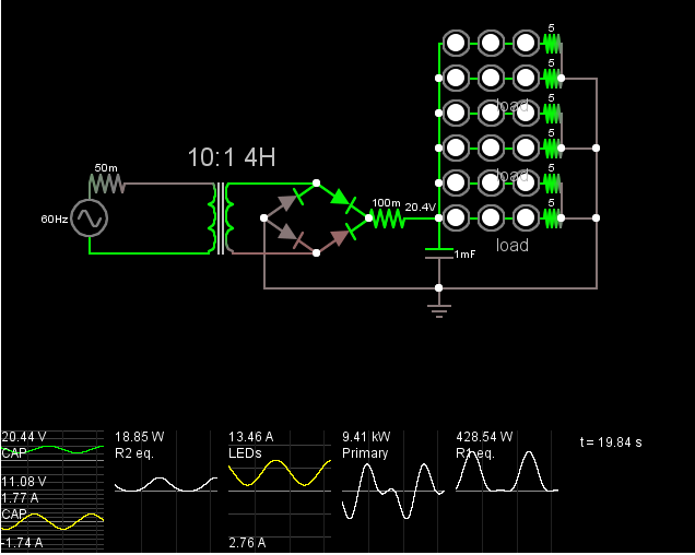

I have a 2100 watt transformer to power my 12 volt LED strips. I have 150' of strips at 4.4 watts per foot or a total of 660 watts. I have only hooked up 33 feet so far and find they are using about 1.47 watts per foot. I would like to control the transformer (ON/OFF) using an Insteon device rated for 1800 watts. I think this should be OK, but the folks at SmartHome said no. I think the circuit will be around 220 watts total and therefore the switch would be OK.
The problem lies in how you diode bridge the transformer with a large cap. The % ripple you choose will be inversely affecting the peak surge current when turned on.
Thus a 10% ripple voltage results in a 1000% or 10x surge current, much like an incandescent light bulb but may differ depending on your selection and if you have a series choke to reduce Ipk. It may or may not handle this.
The second problem is the inductance of the transformer may be many Henries and depending on the protection built into Insteon's MOV surge suppressor may exceed the Joules of transient energy when switched off. (1/2LI²) ( you could add a bigger MOV)

What is your transformer voltage ratio and what rectifier design parts are you planning? ( if not using my recommendation)
Here's an example of a bad implementation.
Note the 660W of LEDs will have high power losses everywhere from high excitation current of transformer and high Cap. ripple current and ESR of equivalent Zener loads.
Values are just an estimate.
