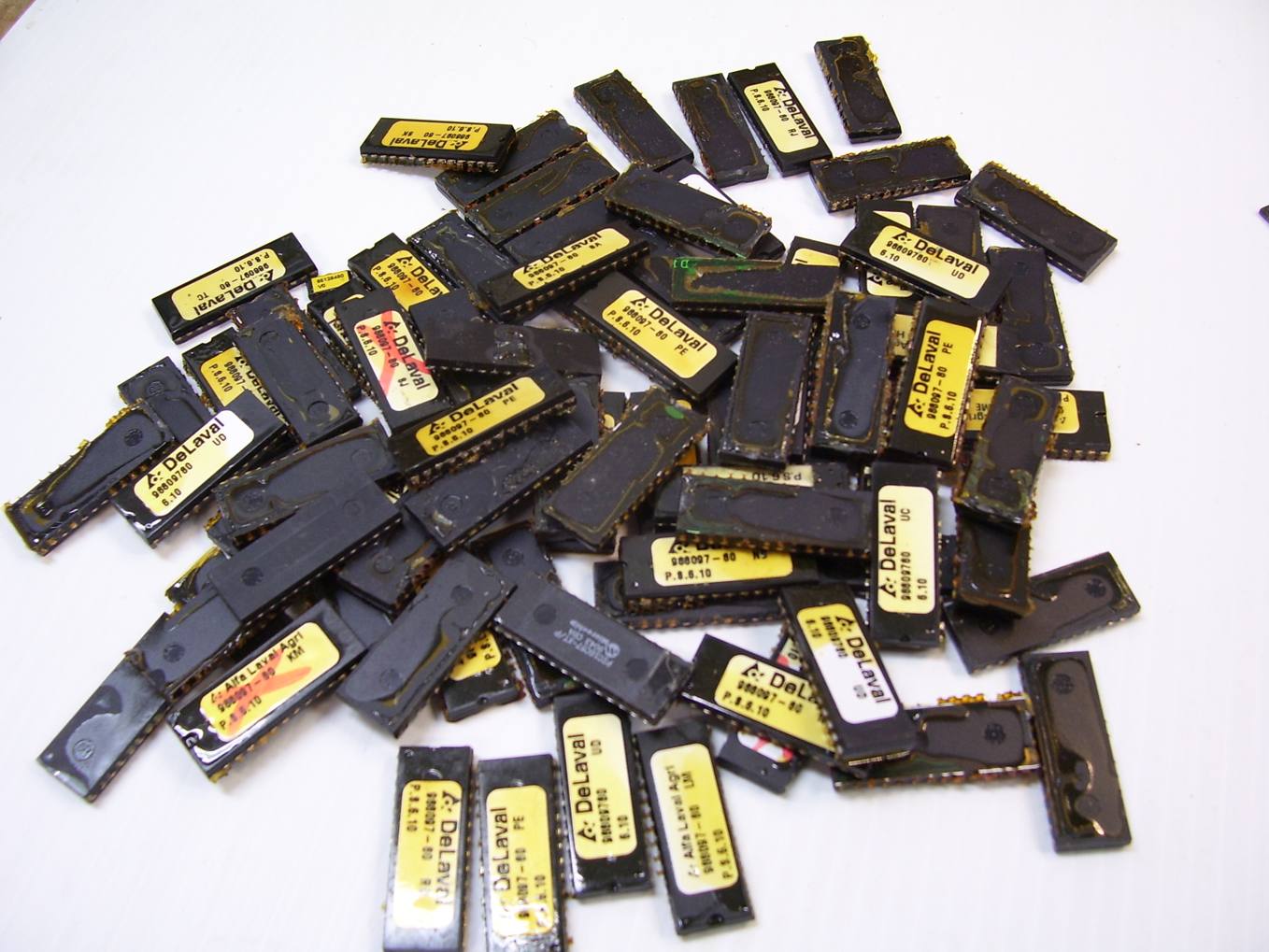

Maybe for you ... :)
Here's just a few I've changed lately. Wanna see some more?
There's something nasty happening then - something is obviously killing the chips - and PIC's are so hardy and reliable it's got to be something REALLY nasty :D
I've still got a fully working PIC with my fingerprint burnt in the top :D - best not to plug then in the wrong way round!(and if you do, then don't feel if it's getting hot without licking your finger!).
Yes, I agree. I don't know what causes the failures in most cases, but despite the number I've shown ... they are extremely reliable.
There are occasions where one of the mosfets that the micro drives, is s/cct ... and that can kill the micro if left on too long ... but the majority I don't know.
They live in a fairly hostile environment and so some failures are probably moisture related, though they are pretty well coated ...
and at the same time ... a similar board from another manufacturer which also uses a PIC16C57 but in a socket and has very little protection ... occasionally come in with pins almost eaten through and yet the micro is still fine.
I was being a smart alec by the way ... sorry ... that collection is from a couple years. Not sure why I kept them ... but there you are.
