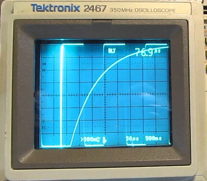

I need to measure rise and fall time of a signal. Time for the signal to get from 10% to 90%.
I use the knobs to set the signal to exactly fit 0% to 100%. Then masure the time from 10% to 90%.

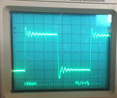

Ah! But, since variable knobs effect reading, how do I know what is real value? Since it attenuates, I know signal is bigger, but how much compared to what I see on screen? For example, I see on your picture that It's bigger than 50mV, but not accurately how much.
Hmm, then again; 100% of say 5V is still 5V....
