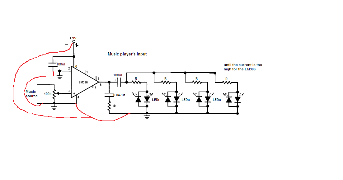

Okay I'm going to try to understand this schematic from Audioguru.
From the music source...
-The ground wire connects to the positive end and 4th pin of the LM386 (Where does the ground wire connect to?)
-Another wire(?) connects from the music source to a 100k resistor and then to the ground (Not sure what the arrow from pin 3 on the LM386 to the resistor means)
Above the music source is the power supply...
-The 9V battery or wall battery connects to a positive end of a 470uF capacitor AND pin 6 on the negative side of LM386
-While the negative side of the same 470uF capacitor connects to a ground wire and pin 2 on the negative side of the LM386 (Where does this ground connect to, and where am I getting a ground wire from?)
Moving onto the LM386...
-Pin 5 connects to another positive end of 470uF capacitor
-Pin 5 also connects to a 0.05uF capacitor (Not sure where positive or negatives are on this one)
-On the other end of the 0.05uF it is connected by a 10(10 what?) resistor
-That resistor is connected to a ground wire from the first set of LED lights
So these 4 LED lights are wired parallel...
-I have no clue what the 'until the current is too high for the LM386' means
-Or the dotted lines near the bottom right of the second set of LED lights
Am I understanding this at all?
How would this differ if I wanted 6-8 LED lights, would I just wire in some more lights in sets of twos parallel and depending on those, up the power supply voltage and the resistors connected to the sets of twos?
Would this effect the capacitors?
All grounds in the schematic are connected together. The input cable ground wire, pin 2 and pin 4 of the LM386 amplifier IC, the negative wire of the 470uF capacitor, the 10 ohm resistor and one wire of all the LEDs. Pin 2 of the IC is its negative signal input which is ground.
Positive signal input pin 3 of the IC connects to the slider (the arrow) on the 100k volume control that adjusts the amount of brightness.
The positive terminal of the battery or power supply connects to pin 6 of the IC and to the positive wire of the 470uF capacitor. The negative terminal of the battery or power supply connects to ground. Connect all the grounds together.
Yes.
They do not make 0.05uF capacitors anymore. Use 0.047uf (which is also called 47nF) instead. Such a low value does not have positive and negative wires.
10 ohms.
Connect all the grounds together. The schematic uses ground symbols so that it does not have ground wires all over it.
No. TWO LEDs are in parallel but with opposite polarities and each set of two LEDs has its own current-limiting resistor.
The datasheet for the LM386 amplifier shows that when it has a 9V supply its maximum output level is 6V peak-to-peak (3V peak) into an 8 ohm speaker. Then Ohm's Law calculates its maximum current is 3V/8 ohms= 375mA. An ordinary LED is rated for 20mA so simple arithmetic shows that the amplifier IC can driver up to 375mA/20mA= 18 LEDs in each direction.
The dotted lines are the signal and ground wires for additional LEDs not shown on my schematic.
The LEDs DO NOT connect to the power supply voltage. My schematic shows only two sets of two LEDs, each with its own current-limiting resistor. Add more pairs of LEDs each with its own current-limiting resistor as shown by the dotted lines.
The 470uf value of the capacitor feeding the resistors that feed the LEDs was calculated to drive up to 36 LEDs. If you use only 8 LEDs then the capacitor value could be reduced to (8/36) x 470uF= about 100uF.
Yes.
10 ohms.
Okay I think I understand this now. I kind of drew over your schematic so it would be easier for me to read and understand. How does this look?

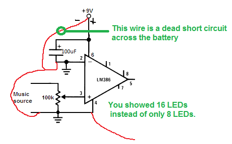

You have a wire that connects the positive terminal of the battery to the negative terminal of the battery which is a dead short.
When you short a battery it kills it and makes it very hot.
Also you show 16 LEDs instead of only 8 LEDs.

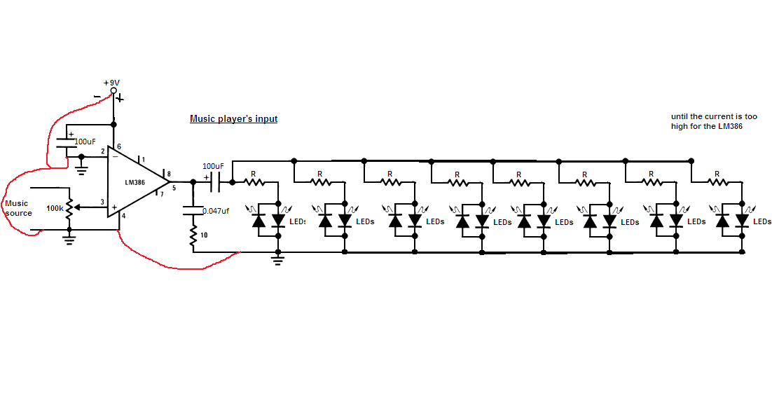

How does this look now?

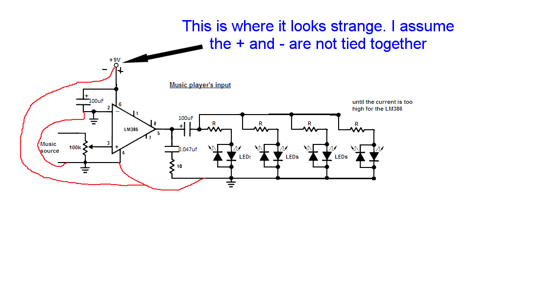

I see what happened. Where power is +9 it looks like you have the red tied to the +9 and that is the same red that ties all the grounds together. I assume they really aren't connected that way as a short. I see the added - and + indicating they are two lines and not tied but think that is the point of some confusion.
Ron
RonView attachment 86503
Yeah they aren't tied. The one negative part of and and positive part of it. Sorry for confusion.
Edit: You beat me Ron LOL
Edit: I see it now. - + on both is unnecessary; just showing you have grounds on one rail will let everyone know it's tide to a common ground. Just the positive 9+ is good enough.
Your still grounding to the negative rail on pin 4 of the Op-Amp.
Edit: Edit: I see it now. - + on both is unnecessary; just show grounds on one rail and everyone will know it's tide to common ground.
Okay now I'm extra confused. Do you mind just editing it to the correct way?
There you go; does that make more sense. Sorry about confusing you.
Good luck on your project hope it all works out for you.
