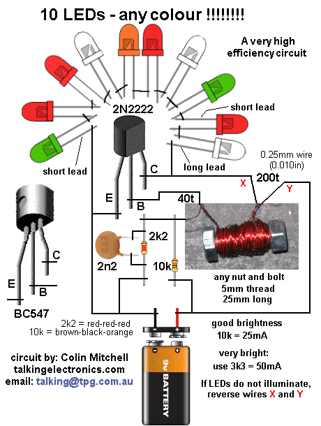

Here's a circuit:
All of my solar garden lights use a voltage stepup IC so that a single Ni-MH battery cell voltage can drop as low as 0.7V and the 3.5V LED still lights.
Put two leds in series with a 150 ohm resistor and four of these parallel.
I vote for this solution, sometimes the simplest things are the best.
That being said, the ability to work off one 1.2 / 1.5 volt cell can be useful.
