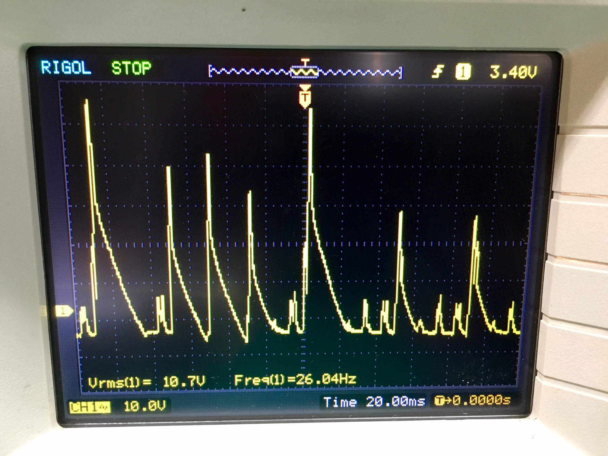

I have been woking on a bench power supply for the past two months or so.
I decided on a discrete regulator design with adjustable voltage and and current limit.
Yesterday I boxed most of it, and decided to test using a couple of parallel connected 12V car bulbs. The bulbs were flickering slightly. Scoped the output and revealed a 16- 25HZ almost square wave/ round edges type oscillation or motor boating.
If i turn down the current limiting it gets even worse.
With my DC load all works as it should.
My electronics knowledge doesn't stretch as far as to fix this. The sense leads come together at the croc clips of the output leads. So there are four wires coming out of the box. The negative output terminal connects directly to neg of main filter caps.
Connecting a 4700uF capacitor across the leads at the load doesn't help much.
Any ideas? See schematic attached.

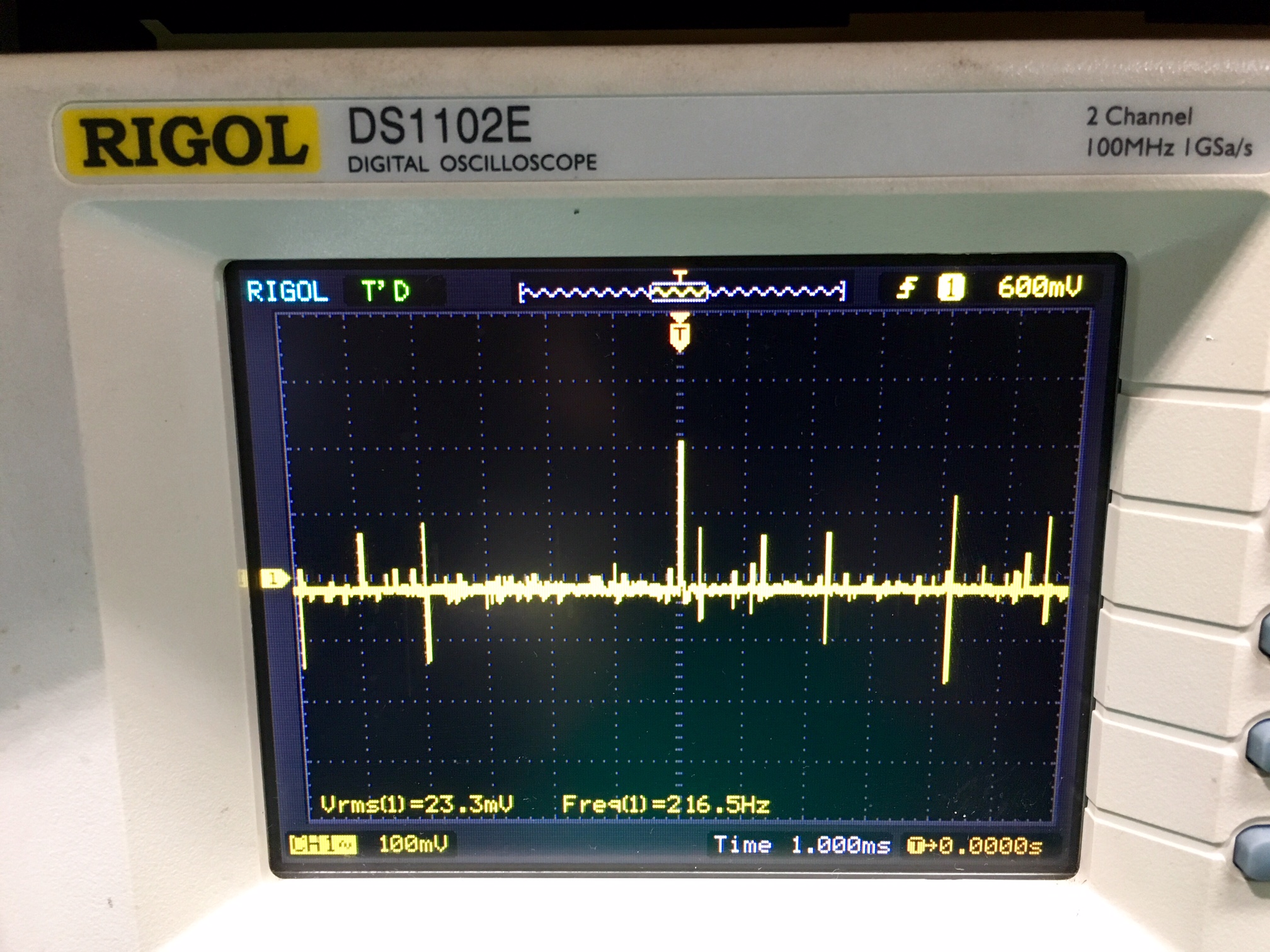

Here are two waveforms measured at output. The first is with some 12V car bulbs connected 12V @3,5A.
The second is with an 8,2ohm resistor also at 12V.

First off, bulbs aren't inductive (not to any degree to affect your problem), can you add another 8.2 ohm to see if the higher current is the problem? - it's possibly shutting down due to over-current?.
Have you simulated your voltage/current regulator, especially the response to a step change in load current?

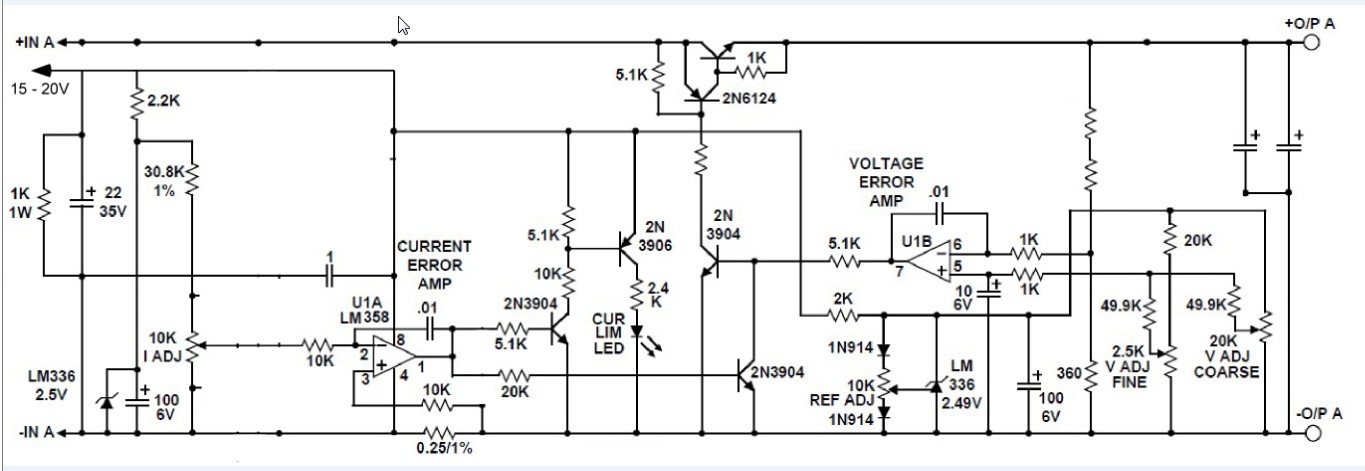

After reviewing the schematic I would issue this WARNING:
This is not a finished design, in fact it won't work as shown. To get the kind of output volatge and current listed, two of the most important factors are for the power transistor(s):
1) SOA (safe operating area) defined by voltage across the device and current through it. In nearly every case, linear supplies with more than 30V input and 3A output will neeed MULTIPLE power transistors in parallel.
2) Power Dissipation. Again, power diss must be distributed between the power devices and handled using a proper heatsink. When Vin is greater than 30V and IL is 3A or more, you are above 100W and have to design for that.
These two aspects are probably the most critical.
If you post exactly what Vout range you need and what current, I might be able to advise.
I would NOT use the design you showed. It will blow up if loaded to higher current levels.

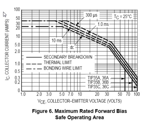

TO ADD:
Showing the SOA curve of the TIP35C used in the schematic, with 40V across it, it can only handle about 1.5A DC current.

You can use the linear regulator design I use in my bench supply (see attached schematic).

Hi. Thank you. I'm using 4 in parallel. Also with the tap switching of the transformer I manage to minimize dissapation.

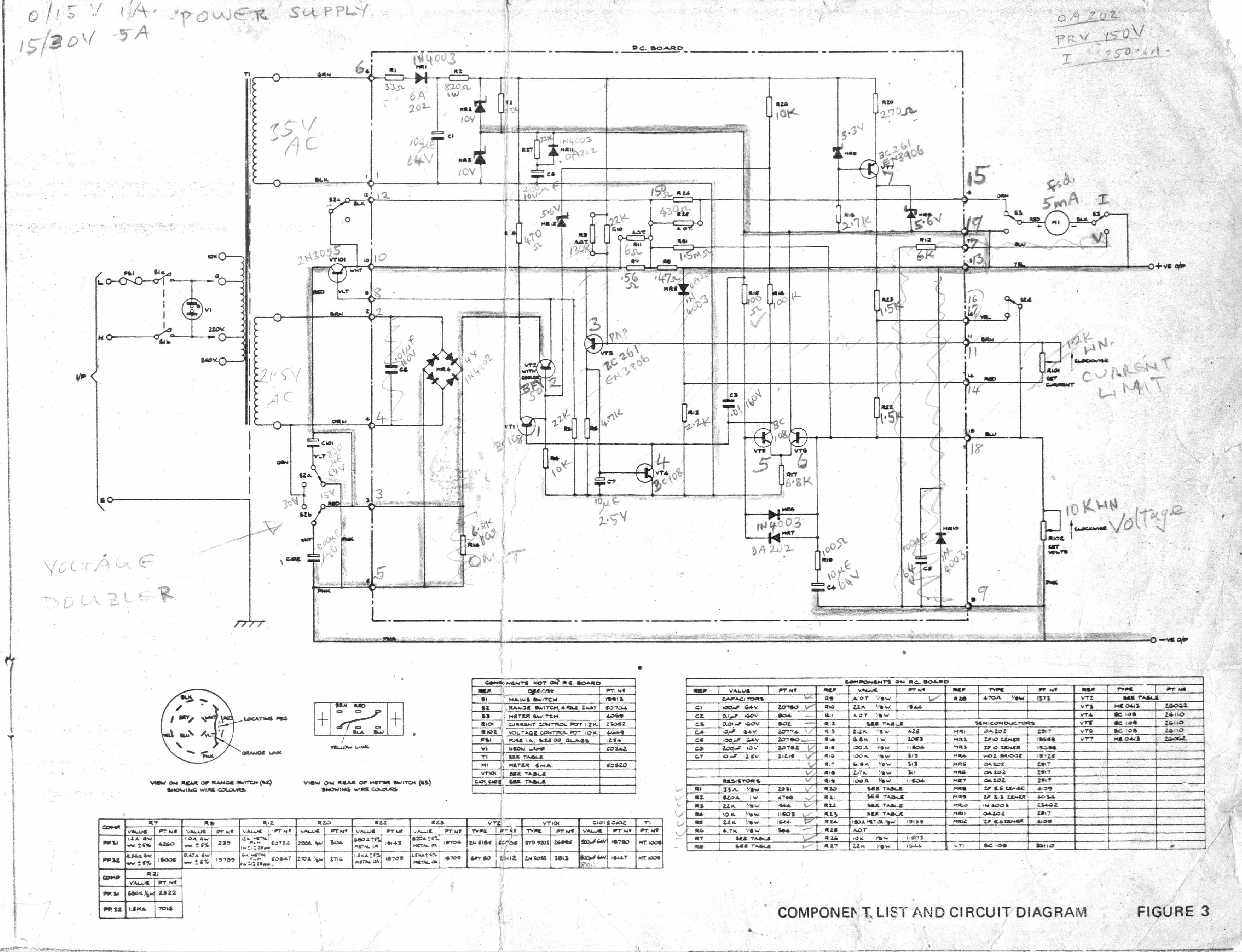

Do please notice that there is a 10k resistor missing from my circuit. It is connected between Q6 emitter and D17 Anode.
I have attached the original schematic from the 70's. Apparently it was a very good supply. "Paul" went and simplified the circuit a bit for his needs, but most of the values are identical. The circuit works great except for the problem I mentioned in my first post!
Have managed to get rid of the oscillation by adding a cap between D8 cathode and D15 Anode. I'm not sure how big this cap should be?
So I guess my next step would be to try and better this circuit slightly as I have already made a pcb for it.
Further suggestions welcome.
Definitely gonna try reducing C2 as mentioned by you guys!
I was going to guess the design had to have been from an era before integrated circuits existed.
