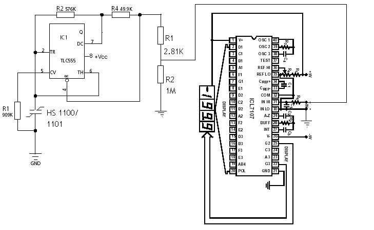

Well....guys I have finally designed a circuit using the reference diagram from the Humrel data sheet.
I am uploading the circuit image so you guys can tell me some changes and the mistakes I have made.
See you soon.
::pranav::

Hi guys.My professor has approved the circuit.The only problem I am now facing is regarding the sensor.The local stockist whom I asked if the sensor is available,now says that he wont order only one sensor for me.
So I would like to know some other sensors,that work on the capacitance principle as the Humirel one that I have used.It should approximately same specifications as the Humirel HS 1100/HS 1101 humidity sensor.I have already found 2 sensors from Gefran,on www.gefran.com and other
from Sensirion,at www.sensirion.com
Waiting for some positive repsonses.
