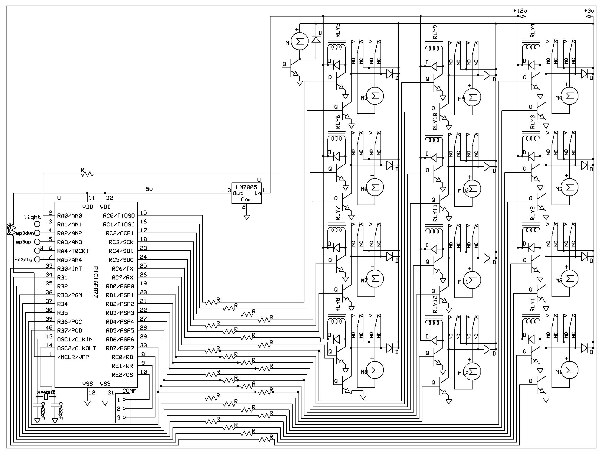

attached to this is a pic of the circuit. what I"m hoping to do is replace most of those transistors with a few of these IC's. (note, I haven't finished labeling or inserting all of the part values yet)

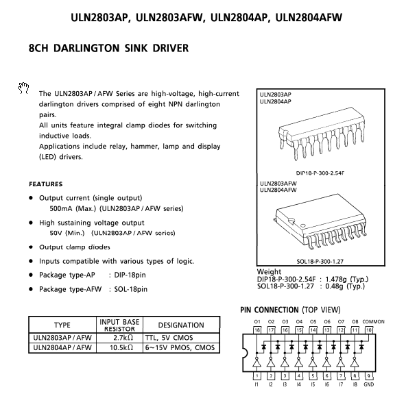

A quick look at the circuit suggests that the ULN2803A [8 darlington drivers/ic]
would replace all the relay drive transistors and clamp diodes and base resistors.
EDIT:
Typing error corrected, added a ULN2803A image.
  • ULN2803.pdf

Both the ULN2803A and ULN2003A have built in resistors. The resistors are sized so that the transistors are in saturation when 5V is applied to the input. The "extra" base current is wasted in a sense but this assures that the Vce drop is as small as possible and thus less power is dissipated in the IC.

thankyou guys for all of your help, but did you mean the ULN2308A? (I can't find a datasheet for the ULN2803A)
also, does anyone know of an IC almost exactly like these ones here, but that can take more current on the collector pin (somewhere around 1A)?
No. I meant the ULN2803 (Maybe remove the A). It is in the PDF attachment that ericgibbs posted above, but I think he was a little dyslexic.
For 1A, you could use the **broken link removed**, but it's getting ugly with heatsinks so maybe H-bridges would be better for your motors so you could eliminate the relays too.
Two points: Good old fashioned 7406 or 7407 make really nice drivers for small relays. They handle up to 40 mA and 30V per output; and have excellent saturation voltages. They don't include the diode. But not good for motors, even the smallest.
Second: Darlington drivers have a high saturation voltage which must be taken into account especially when the supply voltage is low. Consider logic level MOSFETs such as the SI4834BDY (dual N-ch 6.5A 30V in SO-8 for about $0.30) for motor drivers.
