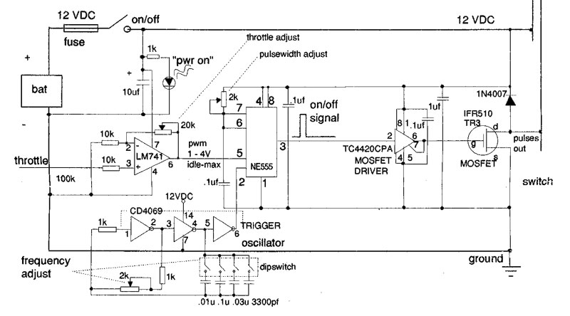

I need help finding the parts to and figuring out how to make this circuit. It's for a simple experiment I want to try out, and it's basic function is a pulse generator. However the last time I made any circuits was years ago and they were simple never requiring any ICs and parts of that sort.
What I'm trying to figure out is the following:
1. What is the whole box around the TC4420CPA and what it is in the first place.
2. By the word throttle it says 100k. I'm assuming that's a 100k poteometer? I know the designer of this didn't do a good job drawing this but it's up to me to figure out where that poteometer should go. I don't see any specific markings for it's location.
3. What kind of fuse do I need for where it says 12V DC fuse? The author didn't specify any amperage or anything. I'm assuming this is a pretty weak circuit and doesn't require too much power, and also thinking about the power of a typical car battery, does anyone have any guesses for what kind it should be?
4. The 3 triangles for CD4069 is an IC chip 4069 with it's different pins as marked in the diagram right? Does this also apply for LM741?
5. At the bottom of the design there are a number of capacitors. I thought all capacitors are measured in uf? What's u and pf?
I know these questions may seem pretty stupid to some :oops: but I would appreciate any help as I don't know too much about electronics and would like to build this design for an experiment. Once I finish it I'll share more details on it and my results.
And one last question is where would you people recommend I buy all of these parts from? I believe Mouser Electronics is the best and has them all, however their ordering system is the most confusing I've ever seen. It's hard to find any parts on their website and even harder to order them.

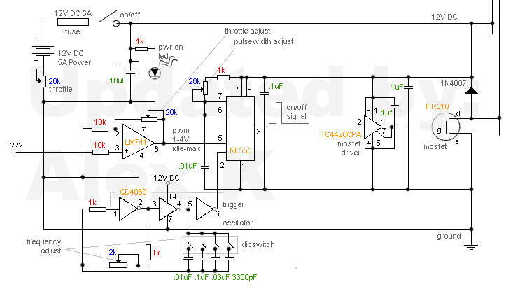

Update:
So far the list of parts I have I need to get are:
Misc:
1 Fuse 12V DC 5.5A
504-AGA-6 - https://www.electro-tech-online.com/custompdfs/2005/04/399.pdf
44FH052 - https://www.electro-tech-online.com/custompdfs/2005/04/1543.pdf
1 Power Supply 12V DC 5A
418-CFM60S120 https://www.electro-tech-online.com/custompdfs/2005/04/1340.pdf
1 Power LED
1 N4007 Diode
625-1N4007 - https://www.electro-tech-online.com/custompdfs/2005/04/315.pdf
4 Dipswitches
571-14358025 - https://www.electro-tech-online.com/custompdfs/2005/04/1080.pdf
Poteometers:
1 2k (do I need a linear or audio?)
31JN302 - https://www.electro-tech-online.com/custompdfs/2005/04/451.pdf
3 20k
688-RK09D1130A0Z - https://www.electro-tech-online.com/custompdfs/2005/04/453.pdf
Resistors
2 10k
660-CF1/4L103J - https://www.electro-tech-online.com/custompdfs/2005/04/424.pdf
4 1k
660-CF1/4L - https://www.electro-tech-online.com/custompdfs/2005/04/424.pdf
Transistors & ICs
1 IRF510 (The author wrote iFr while you state iRf, though I'd believe you guys more :))
512-IRF510A - https://www.electro-tech-online.com/custompdfs/2005/04/346.pdf
datasheet - https://www.fairchildsemi.com/ds/IR/IRF510A.pdf
1 TC4420CPA
579-TC4420CPA - https://www.mouser.com/catalog/621/202.pdf
datasheet - **broken link removed**
1 NE555
511-NE555D - https://www.mouser.com/catalog/621/207.pdf
datasheet - https://www.st.com/stonline/books/pdf/docs/2182.pdf
1 LM741
511-UA741CN - https://www.mouser.com/catalog/621/232.pdf
datasheet - https://www.st.com/stonline/books/pdf/docs/5304.pdf
1 CD4069
512-CD4069UBCM - https://www.mouser.com/catalog/621/182.pdf
datasheet - https://www.fairchildsemi.com/ds/CD/CD4069UBC.pdf
Capacitors:
1 10uf
647-UVR1C100MDD - https://www.mouser.com/catalog/621/487.pdf
3 .1uf
647-UVR2A0R1MDD - https://www.mouser.com/catalog/621/487.pdf
1 1uf
647-UVR1H010MDD - https://www.mouser.com/catalog/621/487.pdf
2 .01uf - I can't find anything this low in the normal shape on that website
all of them seem to only be the relaly tiny surface mount capacitors. Does anyone know about this? Is it safe to use the small surface mount ones? Won't my soldering iron burn them?
1.03uf
1 3300pf
Am I missing anything or are any of those wrong?
It's an IC wich allows easy control of mosfets.
https://www.electro-tech-online.com/custompdfs/2005/04/tc4429.pdf
It isnt really a box drawn around it but connections. It just means pins 8 and 1 should be connected to the +12V line and pins 4 and 5 to ground.
The 0.1 µF comes in parallel with that as close as possible to the chip.
That's a bit vague indeed. Perhaps you could share some more info about the original purpose of the ckt? Because throttle seems to have something to do with motor speed control? Perheps it was designed for a throttle peddle or something.
Again, I think this is a motor speed control ckt, in wich case the fuse depends on the load (the motor)
The 4069 is something completely diffirent then the LM741. The LM741 is an operational amplifier, the 4069 is a CMOS chip containing 6 NOT gates.
Its just coincidence both use a triangle.
Just to make sure you know those 3 triangles are 1 chip. Pins 14 and 7 are its power supply, the others are the actual inputs and outputs of the gates. I would recommend an additional 0.1µF cap on the IC's power pins.
a pf is a picofarad. 1/1000000 of a µF. So 3300pF = 3.3nF = 0.0033µF
u is just short for µF, since he didnt have enough space.
They're pretty basic parts, you should be able to get them in any decent electronics store nearby. I'm sure other ppl here know some gd internet shops too.

You need a resistor in series with the pulsewidth adjust pot. I would use 1k, and change the pot to 20k and the cap from pin 6 to GND to 0.01uF. This will prevent you from smoking the 555 and/or the pot, but will still give a wide adjustment range for pulse width.
As far as I can see at a quick scan, no-one answered this question.
I would connect a 20k pot between +12V and gnd with the slider connected to the throttle input (ie. the 10k). This will vary the speed (ie. change the mark/space ratio of the 555 output pulse) by changing the reference to the 555.

Thank you for that advice ljcox. I will add one more pot to my list. I'll try it both ways, the worst that can happen is I'll have a spare pot :)
Also, I don't know much about electronics, but will there really be 5 amps flowing through all of these components if I use a 5 amp power supply? Won't that burn lots of the components out? I'm assuming only a few will actually take on such loads. If so, which ones should I focus on? As I'm ordering from Mouser there is quite some variety of components.
The 5A will only pass through TR3 and, if the load is inductive, the 1N4007 diode when TR3 turns off.
This diode may not be able to cope with pulses of 5 A. Check its data sheet.
The actual current will depend upon what the motor needs. 5A would be the maximum.

Tap water won't allow much current to flow, we're talking mA range , probably even less. but it will increase with every set of probes you add.
As for the question about the fuse. You may use a fuse rated at a higher voltage then required, but never the other way around. So a 220V or 30V fuse is fine.
