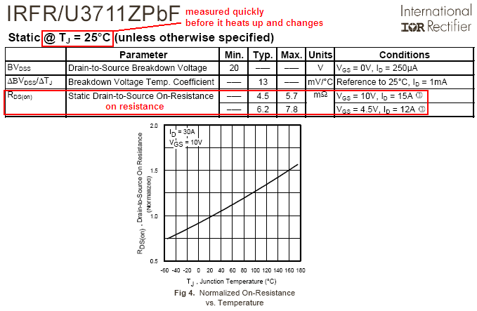

Your amazing Audio. Thanks for all the help and not just giving me the answers. Im learning a lot. Not to keep beating a dead horse but in the datasheet for the MOSFET you recommended (IRF3711Z) I still can't figure out how your getting .006 ohms cold and about 0.01 warm? I dont see either of these anywhere on the data sheet. Can you guide me one more time and help me figure this out? Thanks again...your extremely helpful!!!

You found the tiny little surface-mount Mosfet. It should work fine if its 20V max voltage rating will be OK in your circuit.
All its details are on its datasheet.

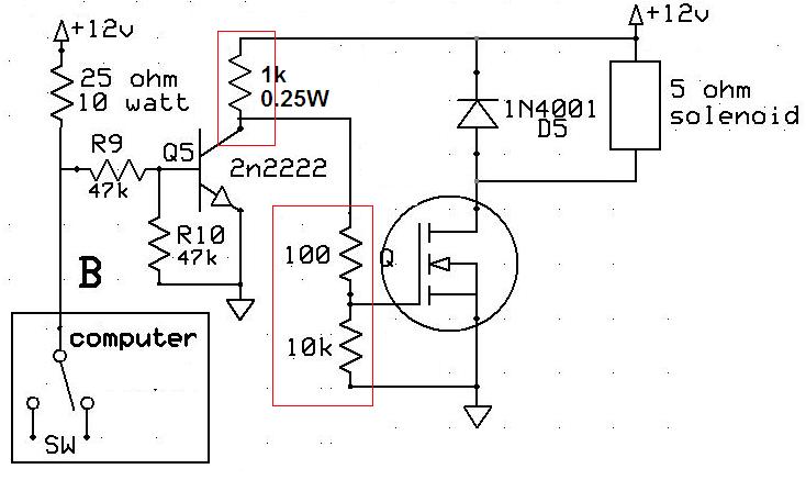

in the schematic you posted do you add the resistors up in series to figure out there wattage? I understand the 1k (.19W at 13.8Vdc through the 2n222) but what about the 100 and 10k? The total resistance to the source of the MOSFET would be 11100 ohms (.017W at 13.8) so would 1/8W work for these?
The transistor saturates with a voltage loss of about 0.2V so the 1k resistor will have 13.6V across it. Its power dissipation is (13.6V squared /1k ohms)= 0.185W.
A 1/4W resistor is fine.
The gate of a Mosfet draws no DC current. When the transistor is turned off then the 1k, 100 and 10k resistors have a current of 1.2mA. Then the 100 ohm resistor dissipates (1.2mA squared x 100 ohms)= 0.00014W and the 10k resistor dissipates 100 times less.
Any size resistor is fine.

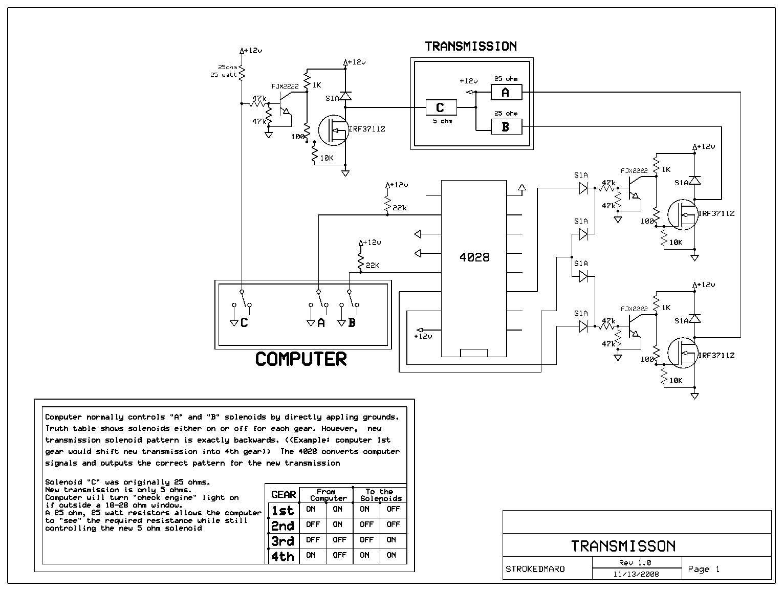

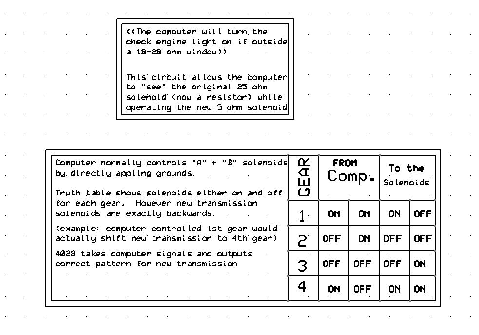

Here is my new schematic. Using what Ive learned from Audioguru (Thank you, thank you!) Ive put this together. The text on the schematic didnt come out very clear so I blew it up into another pic. Will this work and are my pull up values on the 4028 ok? Thanks for the help everyone!!
EDIT: Oops..the MOSFETS are IRF3711Z's. I know these are overkill for the solenoid's which draw only about .5 amps but they are what I have (and necessary for the 5 ohm solenoid).

Your schematic is huge. It is the size of my neighbourhood. It is covered in dots (can't you turn off the dots?).
It is not clear because you saved it as a fuzzy JPG file type instead of as a very clear GIF or PNG file type.
The 1k pullup resistors might not be able to be driven by the computer because their current is high. Use 22k instead.

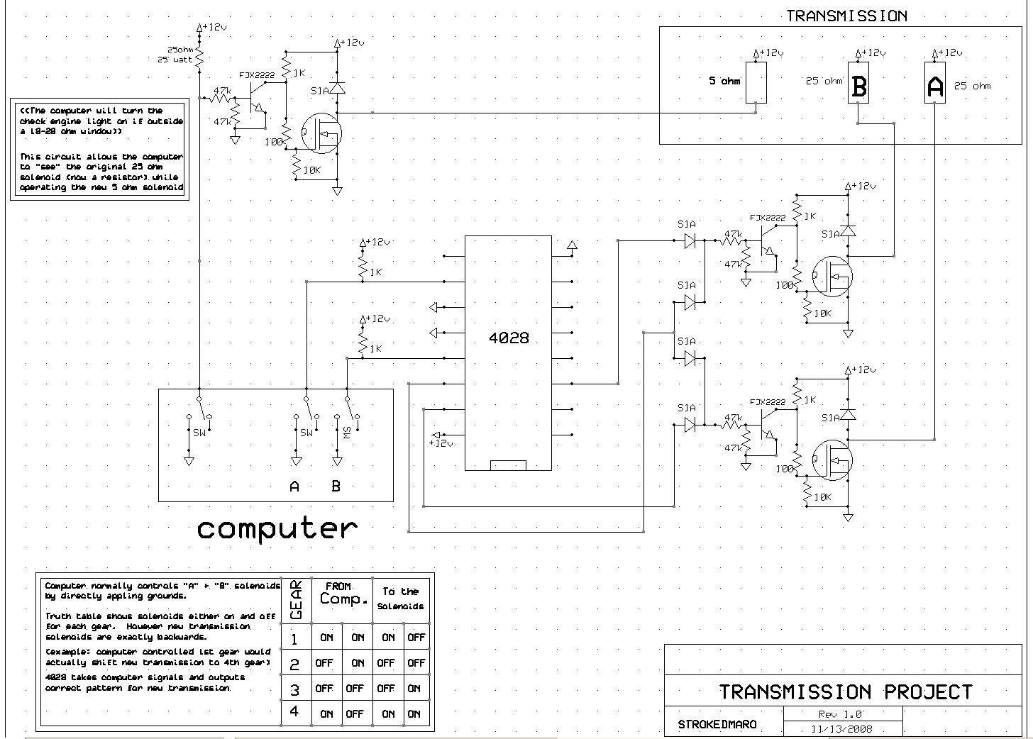

Here is another shot at a better schematic...other than the pull-ups (which Ive updated already) do you see any other errors? Also, would it be possible for me to use 47k for the pull ups since I have a ton of those on hand? Should work fairly well right? Thanks again Audio....your invaluable.
Your new schematic looks very clear.
Yes you can use 47k for the pullups.
Thank you Audio...anything else look wrong in my schematic? In particular the 4 diodes attached to the 3 outputs of the 4028 that controls the MOSFETS for the "A" and "B" solenoids.
