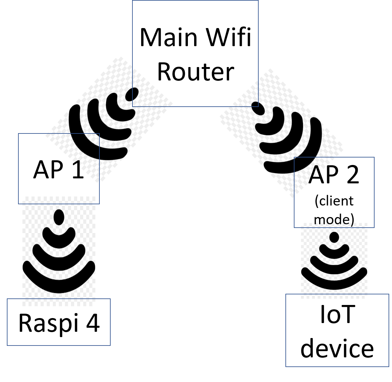

Edit: So is it achievable with a completely wireless router? I'm planning to buy this one: TP-Link 4G LTE M7350 Portable Wireless WiFi Direct SIM Router – ALL IT Hypermarket
Or is only achievable (or better achieved) with this type? (I got it from the forum) I have to say.. we don't have LAN ports in our home *sigh*

So hypothetically does this look like the topology which I should be using?
no - that does not put the Pi in the signal path to the IoT device. The Pi will never see the data between the IoT device and the internet.
The Client mode AP would be used to connect a computer to the internet. With a Pi, that could be built-in Wifi or a USB WiFi device etc., whatever connect the Pi to the internet.
Then the second AP connected to the PC / Pi via Ethernet, with that providing the internet connection for the IoT device.
Set the Ethernet port up with a different LAN IP subnet and enable DHCP so things can connect to it and be allocated a suitable IP address for that subnet.
Then enable IP forwarding and routing so things on the second AP get internet access.
That allows programs on the Pi to directly tap in to all the data going through the connection from the second AP, so you can view or log it to work out what is happening.

I think I'm getting there. Here's my understanding now:
This makes a whole lot of sense I have to say. This means I'll need two Pis (it is the one which I have experience with.. and setting the DHCP etc etc shouldn't be too difficult I think).
Am I getting it?

That's the signal flow I was thing of.
You only really need one Pi / PC though, with an ethernet connected AP where you have "Raspi 2".
It depends which is easier and cheaper to set up.
Ah I get it now. An AP instead of a "Raspi 2".
So basically what I'll need is basically a Pi (I guess Pi 4) and a wireless AP with an ethernet port. (Is the product linked sufficient?)
Yep, exactly.
