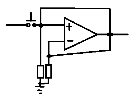

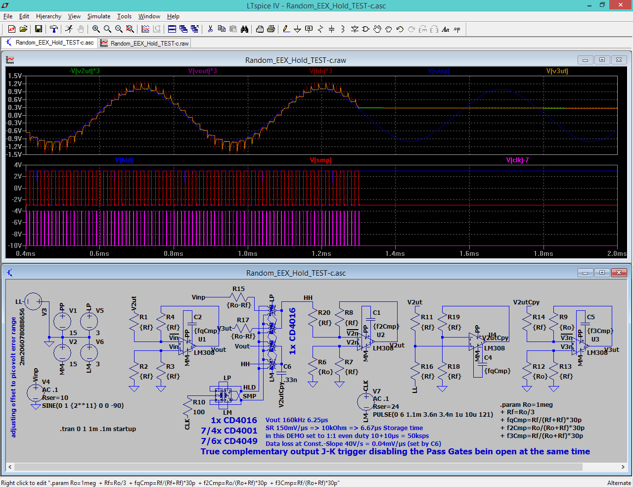

    Hello, I have a question I hope someone can shed some light on. The circuit below is meant to be a sample and hold circuit. It will send a voltage to the non-inverting input while a button is pressed. This causes the output to follow the input. Then the button is released and the output voltage simultaneously feeds both inputs in a forever sample and hold. This doesnt work. But why? Output feedback is certainly capable of affecting the input, so why doesnt this work?

    Because that isn't a sample and hold circuit, there's no storage capacitor there.
    You should also be aware that a sample and hold circuit isn't 'for ever', it's only for a VERY short time, while your A2D reads the value.

  5. crutschow
    crutschow Well-Known Member Most Helpful Member
    Joined:
    Mar 14, 2008
    Messages:
    10,624
    Likes:
    479
    Location:
    L.A., USA Zulu -8
    Because you have shorted the two op amp inputs together.

  6. MikeMl
    MikeMl Well-Known Member Most Helpful Member
    Joined:
    Mar 17, 2009
    Messages:
    11,139
    Likes:
    566
    Location:
    AZ 86334
    You would need an amp with zero bias current, zero offset and infinite gain.

  9. simonbramble
    simonbramble Active Member
    Joined:
    Nov 22, 2010
    Messages:
    433
    Likes:
    64
    the problem with both circuits is the short circuit between the output and the non inverting input. The output will want to regulate to one voltage that might be different from the input voltage, so the 2 will fight each other. The one with the lowest source impedance (or the most current capability behind it) will win.
    If you have an input of, say, 2V with a 5V supply, yes the inverting input will try to regulate to 2V so the 2 inputs equal each other. If you have an offset voltage of 1mV, the non inverting input will be 1mV different from the inverting input. if the inverting input is tied to the output, then the output will be 1mV different and the non inverting input and the output will then start to fight.
    Generally it is a bad circuit. Remove the feedback going to the non inverting input and you have something that stands a chance of working. As Nigel says, for a true sampling circuit, you need a capacitor in there..

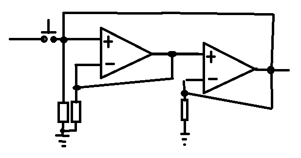

  10. alec_t
    alec_t Well-Known Member Most Helpful Member
    Joined:
    Jul 10, 2011
    Messages:
    9,327
    Likes:
    1,231
    Location:
    Cardiff, Wales
    In simulation the output of the post #6 circuit can be either near the +ve rail, near the -ve rail, about half way between the rails, or oscillating about the half-way point, depending on both the choice of opamp model and the initial circuit conditions. I suspect slew rate, input offset and opamp internal configuration all play their part.
  11. schmitt trigger
    schmitt trigger Active Member
    Joined:
    May 24, 2009
    Messages:
    914
    Likes:
    85
    This condition is similar (*) to what happens to a SR flip flop where a logic 1 is applied simultaneously to both inputs.
    Depending on slight input differences, the output can assume any state.
    (*) please note, I said similar, not identical.
  12. MrAl
    MrAl Well-Known Member Most Helpful Member
    Joined:
    Sep 7, 2008
    Messages:
    11,049
    Likes:
    961
    Location:
    NJ
    Hello there,
    In theory with ideal components it works, so the answer is because of the non idealities and parasitics of the op amp.
    If you have a perfect buffer with gain of 1 and apply an input of exactly 2 volts from an ideal voltage source you get an output of exactly 2 volts. The ideal op amp output acts like an ideal voltage source so you can tie the output to the input and no current will flow between sources.
    You can then disconnect the original voltage source and the output and input will stay at 2 volts.
    The problems come in though, because of all the non idealities of the op amp which include:
    imperfect gain
    input offset
    input and output impedances (reduced to resistances for this case)
    Taking the first above, if we input 2v we dont get 2v output. If we get 2.001v output then when we connect it to the input and remove the first source the output ramps up to infinity or until it saturates. If we get 1.999v output then when we connect the output back to the input and remove the first voltage source the output ramps down to minus infinity or until it saturates negatively. Since the gain is not exactly 1, the input voltage is always changed by the output because the output responds to the input by either increasing it or decreasing it, and once it increases it or decreases it the input also increases or decreases again and so the repetition of this condition will cause the voltages to either fall completely or rise until they hit some limit like the level of the power supply.
    So just the imperfect gain alone will prevent this from working well in real life.

    because you'r feedback forces
    • an excellent op amp to it's internal ground that is incase of balanced ideal bi-polar supply the Signal-Ground
    • not so excellent op amp would go wondering and fix it's output at some point in between Vcc(/Vdd) to Vee(/Vss) or start oscillations
    . . . your feedback sets the output that is dependent of "common mode offset" (read the V.inputs - V.sig.gnd) and from the input offset and the misc junction temperatures and e.c. drifting depending on the
    • "Slew rate" of the Pull-up stage
    • "Slew rate" of the Pull-down stage
      • ""negative feedback power"" of the Pull-up "virtual circuit"
      • ""negative feedback power"" of the Pull-down "virtual circuit"
        • Open loop Gain or a "differential such" as you feed back !evenly! to +pos and --neg inputs - - - thus over driving them if you reference your output to ground with lesser ratio than 5k and more (a typical Op amp Voltage gain) ◄ it (the previous sentence) makes sense in I/O -put time-differential- (/dynamic-) balance ××× in other words you'd need to reference your output back to inputs with voltage dividers say 5000+kΩ : 1kΩ the used 5MΩ feedback means the settling time due no-dynamic power is very slow, ... blaah,blaah ... (but so is then also the output drift -- once it settles)
    . . . incase of a speciffic/?good(for your application?) Op Amp it will stay at set level for shorter- to longer while - - - so with the right equipment it actually does do (although for a significantly shorter period) what you think it should

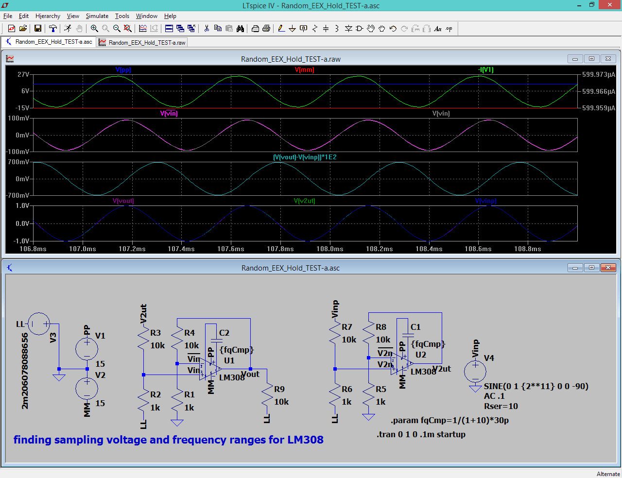

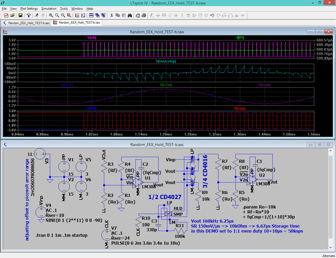

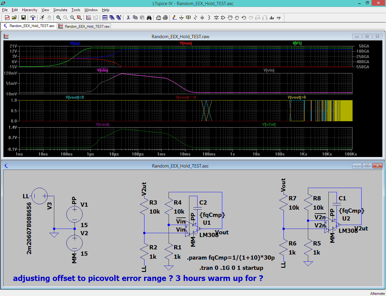

  16. ci139
    ci139 Active Member
    Joined:
    Apr 12, 2012
    Messages:
    470
    Likes:
    37
    Random_EEX_Hold_TEST.png Random_EEX_Hold_TEST-a.png Random_EEX_Hold_TEST-b.png Random_EEX_Hold_TEST-c.png
  17. ci139
    ci139 Active Member
    Joined:
    Apr 12, 2012
    Messages:
    470
    Likes:
    37
    somewhat interesting circuit - when shorting two intuitively "same potentials" the grid stops working -- otherwise it follows the source (±2V) at 25kHz

    Your intuition is not correct. The circuit does not work because the intent of your circuit violates the second law of thermodynamics.
    It also does not work in theory - that is, with a theoretically perfect opamp - because it has 100% positive feedback and 100% negative feedback at the same time. This is not a valid condition. To show this, start with the gain equation for a fully differential amplifier, modify it to include the positive feedback connection, plug in your resistor values, and solve for the gain.
